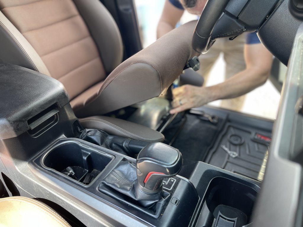

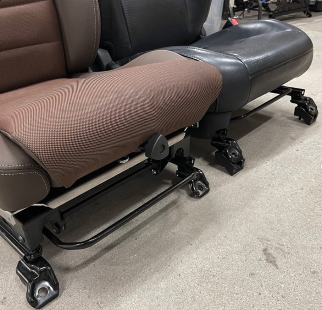

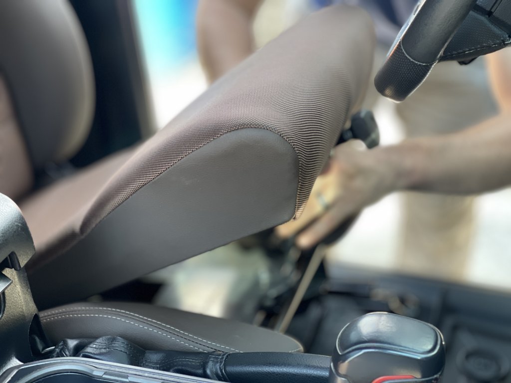

    When we started out doing the development of the seat pan for the 2nd and 3rd Gen Tacomas we didn’t have JUST the airbag SRS system and load-cell occupancy system to worry about. We were dealing with an aftermarket seat that was designed to sit parallel relative to the ground on provided seat rails. On our side we wanted to focus more on the average Tacoma user and what they were experiencing and it seemed that using seat lifters were very common, especially to the front edge of the seat. This created more rake and thus more support under the occupant’s thighs. This made longer trips more comfortable.
    For us here at Tolerance STACK we had to contend with the overall angle of the seat mount, then the front seat rake, but we were also thankfully dealing with a well designed aftermarket seat that allows for the seat bottom to extend out which really helps for those taller folks out there.
    We feel we hit that happy spot with our seating position to not only get the seat as low as possible but also keeping the actual seating position at the same height as compared with the Tacoma’s leather seats all while improving the front edge rake for greater support AND seat adjustability without the need of secondary seat lifters.
    TLDR; if you are ok with your seat height now you will be fine with the seat height after switching out to aftermarket seats with the Tolerance STACK seat mounts.

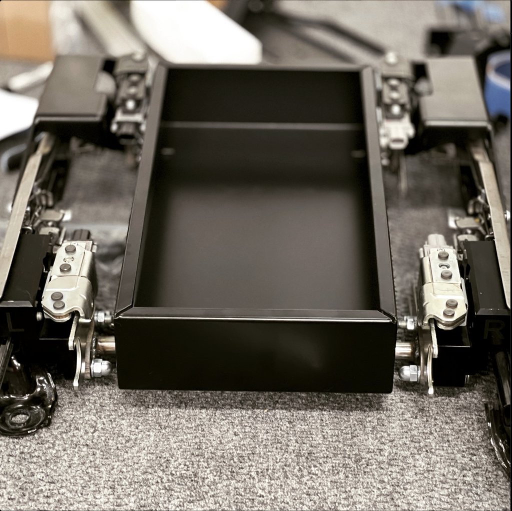

    Another interesting thing to bring up is the fact that scheel-mann seats have a design in their seat bottoms that allow them to be lifted up to get access underneath. This was originally designed for the Defenders because the battery was under the seat. But for us Tacoma owners we get to utilize it for storage. We've specifically designed the seat bracket to take advantage of the space and allows us to design a storage bin for both the passenger and passenger seats.
