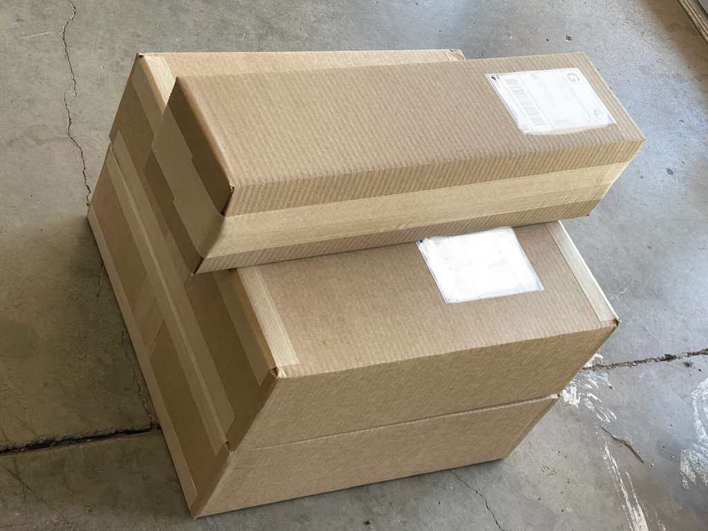

    There are very few "firsts" you get as a brand new company trying to make their impact on the world. of social media. Although we have had a handful of first orders, this is our first set of front seat adapter kits with scheel-mann seats.
    For this customer out in Michigan he was ditching his power driver seat out of his Tacoma and replacing with Scheel-mann Vario F seats in order to make the drive much more comfortable for his long drives for his hunting trips.
    Exciting to see another "first" go out the door.

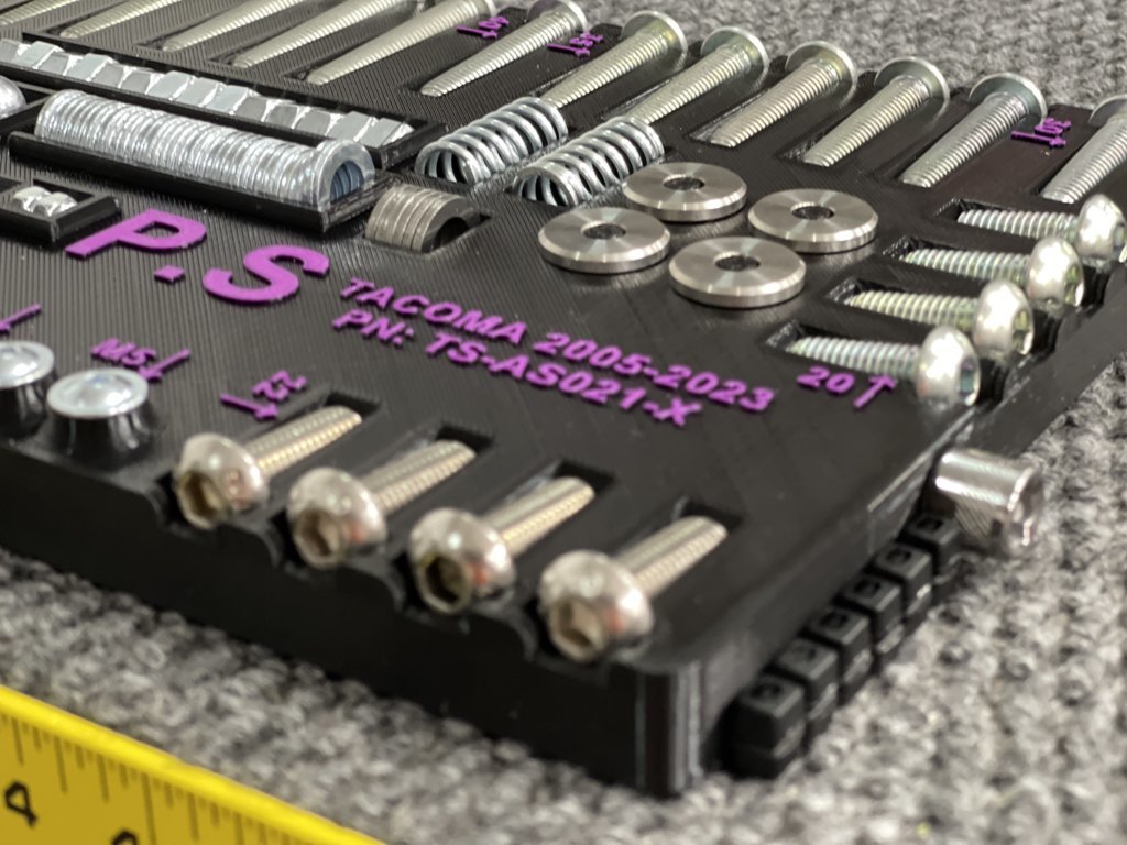

    Hardware Kits
    How to assemble hardware kits? Believe it or not this is something we wrestled with for a long time. We knew we didn’t want the same lame “stuff everything into a plastic zip bag” solution for handling the hardware. We knew what we didn’t like but it was tough trying to figure out something slick for the hardware organization. We considered tackle box trays or little component boxes but it seems that anytime we need to change the contents of the kit it meant trying to find a new ready made box. We actuallly considered a piece of cardboard with. Bunch of holes for the bolts but even that didn’t feel great.
    Enter 3D printing. Although no parts of the seat adapters are plastic, much less 3D printed, we did realize we had a better solution for handling the hardware in a VERY organized fashion and look really good.
    A place for everything and everything in its place…at least until its time to install your new @scheelmannusa seats ;)

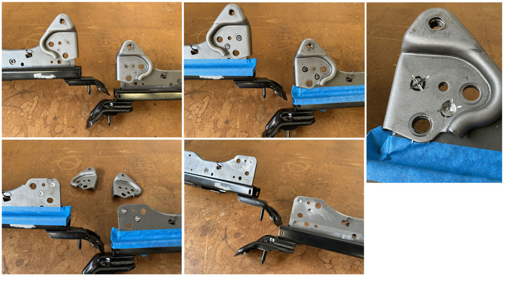

    One question that pops up is asking about the difficulty about installing the seat bracket kit in the Tacoma (or FJ Cruiser), particularly on the driver side. Well, we actually design things as far as we can possibly go to make installation as plug-n-play as possible.
    On the driver side in particular the hardest part of the install is actually just drilling out the spot welds to remove the "tower" from the slide rails. Because these are spot welds the metal is actually hardened. We found that doing this by hand with a standard hand drill can be taxing because the metal is so hard. We've learned that using a dremel or small cut off wheel to grind an "X" onto the spot welds is the easiest way to remove the spot welds.
    There are specialized spot welds but those are pretty spendy for something you may only use once.
