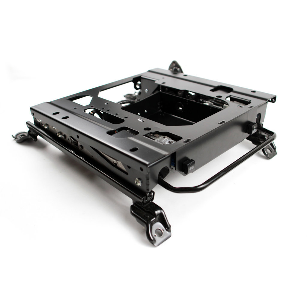

    Once the KLIMA heated and cooled seats were announced by scheel-mann we had hoped that the seats themselves would stay the same physical dimensions. It wasn't until we got one of the seats in that we soon realized that there was a cooling fan and duct work that we needed to develop around. This forced a retooling to make sure the same completeness of install would follow to the KLIMA seats.
    Enter the Tolerance STACK seat mounts developed specifically for scheel-mann's the KLIMA heated/cooled seats. In order to clear all of the new bits added to the KLIMA seat we now INCLUDE storage as part of the design. Not only does this give you the added feature of storage but in doing so we also added in two switch slots designed for Toyota's 22.2mm cube-style switches. Extra features and extra function for a seat that added a cooling feature.
    These KLIMA mounting brackets are now headed into production, after going thru a rigorous QC regimen, and we expect to be shipping by end of Jan to early Feb.
    We will start with KLIMA solutions for 2nd and 3rd Gen Tacomas, FJ Cruisers and driver side of the 4th Gen 4Runners. Other vehicle models are in development now.
    https://www.tolerance-stack.com/category/klima-cooled-seat

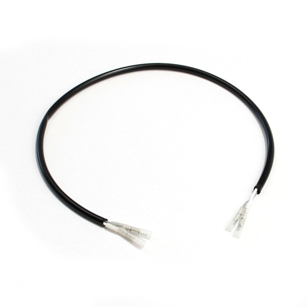

    Driver side occupancy sensor extension harness. Sorry nothing fancy but we do want to make sure we have everything covered for every install.
    This is now an included harness as part of all driver side installs with a two-wire occupancy hall-effect sensor. You do NOT need this as a new installation.
    When working on the driver side of Toyota vehicles there is no load-cell or seat pressure pad. There is instead a magnetic hall-effect sensor that is mounted to the seat and uses end points on a metal tab on the rail to determine the driver seat's position. It's a simple off-on configuration for the sensor operation.
    Toyota puts the sensor on one side for Tacomas and on the opposite side for 4Runners and FJ Cruisers. This because of the ratcheting seat adjuster for on 4Runners and FJCs.
    Typically the plan is to order the exact connector from our Japanese supplier and then supply a new extended harness, but the connector needed is PCB mounted and not available separately.
    Next best option is to just extend the two wires. That is where this wire harness comes into play. All you need to do is cut the two wires going to the connector that attaches to the occupancy sensor and splice into this harness to extend those wires.
    NOTE: your OEM wires are going to be either white/gray or orange/brown. The color of the actual wires used don't make a difference.

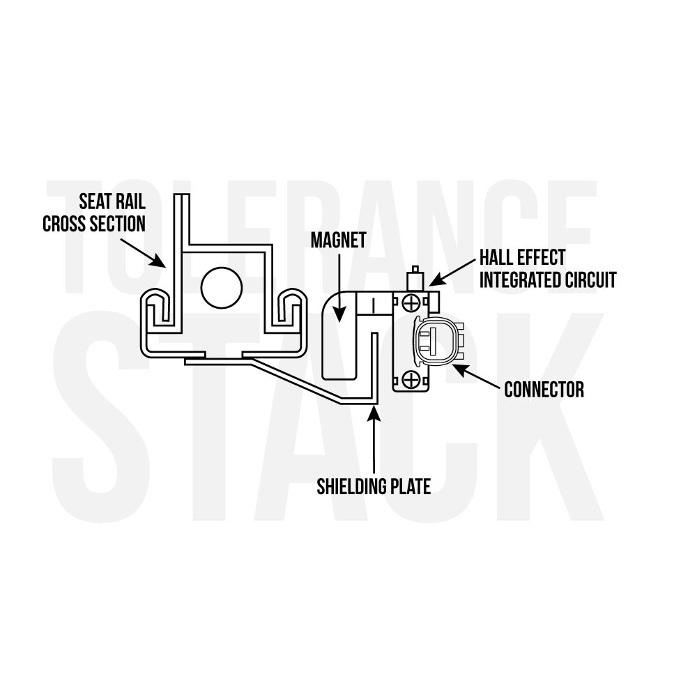

    After designing our solution to integrate the driver's seat position sensor we felt it might help folks thinking about a DIY setup to switch out seats or going with a solution that keeps all sensors and wiring intake when upgrading to the scheel-mann Vario seats.
    A quick snippet from our latest blog post:
    Sensor Placement and Components
    The driver’s side Hall IC (integrated circuit) sensor found in vehicles like the Toyota 4Runner, Tacoma, and FJ Cruiser is mounted on the seat rail, which is part of the seat frame that attaches to the vehicle floor. This sensor is positioned on the inside face of the seat rail, directly beneath the driver’s seat. It works in conjunction with a shielding plate that is permanently mounted on the rail.
    Read all about the Toyota truck's seat position sensor here:
    https://www.tolerance-stack.com/post/driver-occupancy-sensor

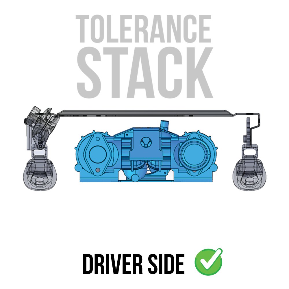

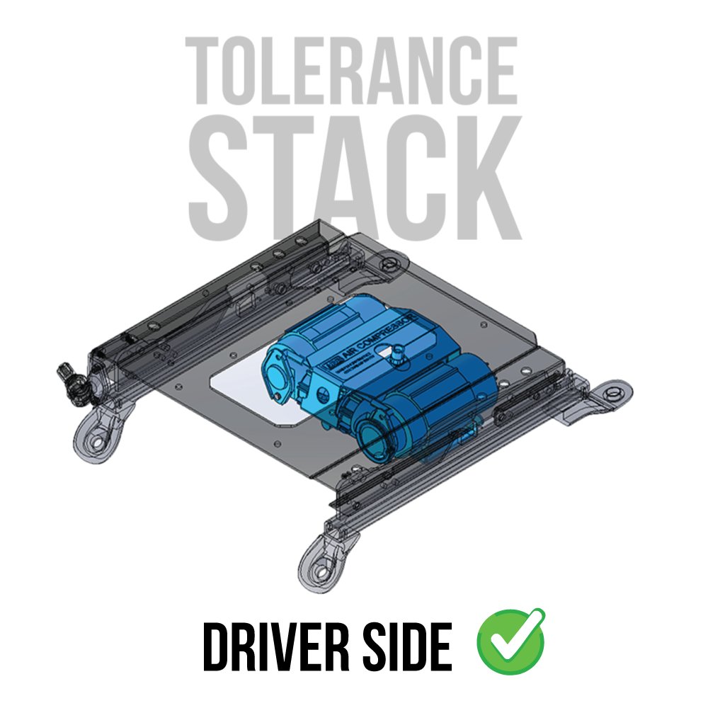

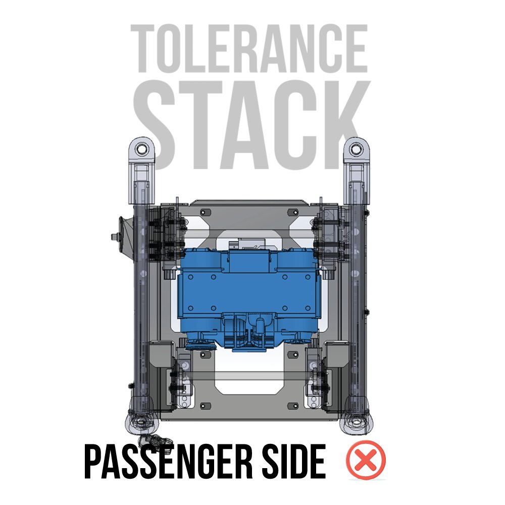

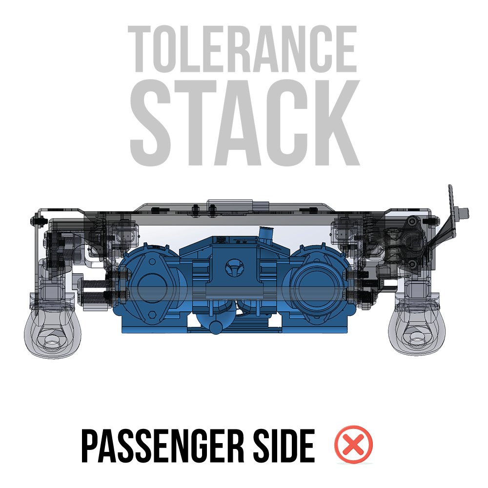

    ARB Twin compressor with Tolerance Stack mounts
    We have been getting a handful of inquiries about shoe-horning the ARB twin compressor UNDER the Tolerance Stack seat mounts for the scheel-mann Vario F seats.
    What we have found is it does appear as though the ARB twin should be able to fit without an issue, as seen in these renders, without the need of the seat jackers under the driver’ seat. That being said this "assumes" the FJ seat height being at least at the half-way point for you where it currently fits under the OEM seat.
    The Tacoma’s driver seat may have factory computers under the driver seat that could make mounting the arb challenging. But the addition of the seat jackers, at least on the rear, likely would remedy that issue.
    For sure mounting an ARB twin compressor would NOT work on the passenger seat because the load-cell array is relocated.
    For sure the ARB twin would not be compatible with ANY of the Klima solutions, so If cooled seats are a consideration then ARB option is out for mounting under the seat.
    A quick note on the ARB twin compressor, in order to get the leader hose routed properly you would have to either replace the ARB’s air coupler with a 90º fitting or rotate the manifold so that the fitting is facing 90º inline with the compressors.
    Tolerance-Stack-DS-ARBtwin-FJCruiser2.png Tolerance-Stack-DS-ARBtwin-FJCruiser3.png Tolerance-Stack-PS-ARBtwin-FJCruiser1.png Tolerance-Stack-PS-ARBtwin-FJCruiser2.png

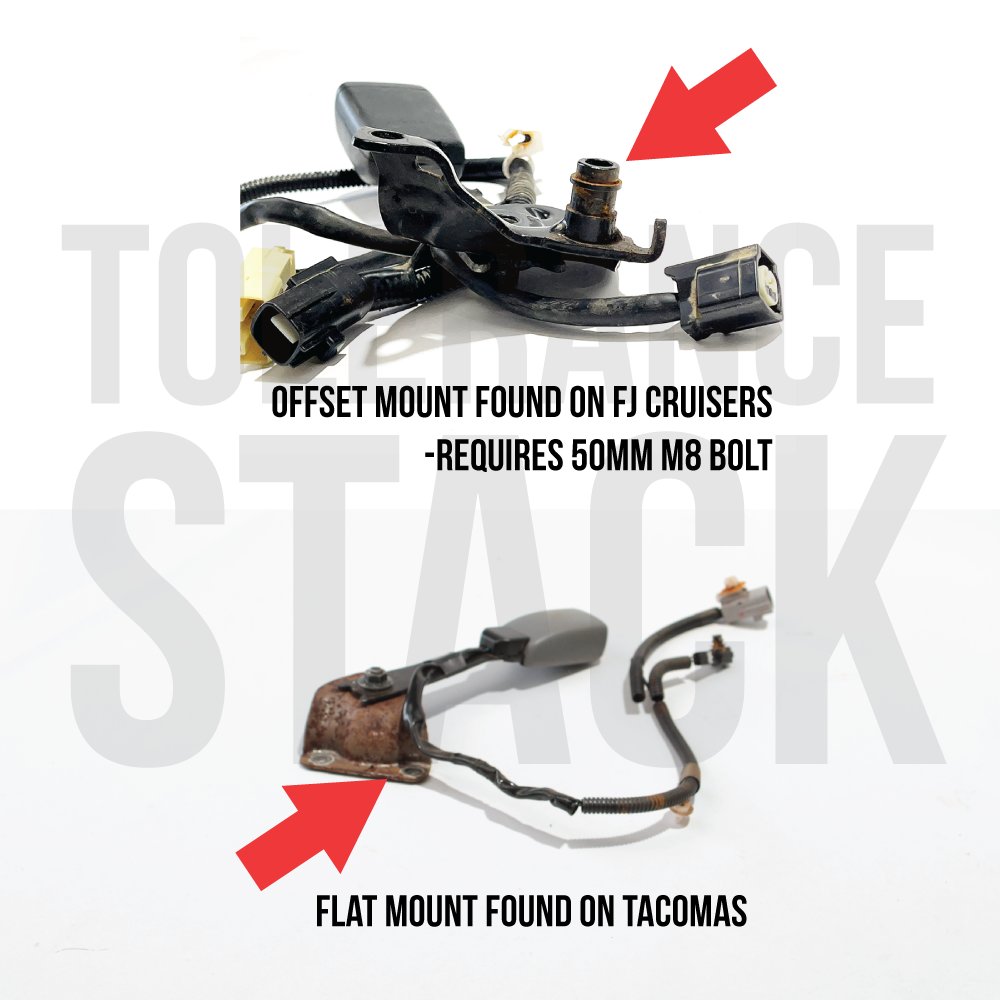

    When you have made the commitment to upgrade to scheel-mann seats for your 2nd/3rd Gen Tacoma (or FJ Cruiser or 4th Gen 4Runner), the first step is of course removing the seats from the vehicle which you can see in the SEAT REMOVAL video above. Once the driver seat is out you now have to remove the hardware necessary to remove the two sliding rails needed to complete the install onto a Tolerance Stack mounting bracket for your scheel-mann Vario seat. Video:
    https://www.tolerance-stack.com/vid...ad60e535ea958d1&wix-vod-comp-id=comp-m6prsows
    General steps:
    • Lay the seat flat on a workbench
    • Cut the hog rings holding the back panel/flap to the frame
    • Remove the single screw in the rear
    • Remove side panel plastic
    • Remove the four T40 Torx screws on the inboard rail
    • Remove the seat belt buckle and its bracket (save)
    • Remove front two bolts to remove the front cross-member
    • Remove the four T40 bolts on the outboard rail
    • Access and remove the two bolts UNDER the fabric - either by prying up the material or by cutting slits into the material
    • With those two bolts removed you can now remove the rails from the cross-member
    • The inboard rail will still have the wiring harnesses, undo the retaining clips to remove the inboard rail
    • Undo the rest of the harness clips and remove the wire harness connected to the seat belt and bracket

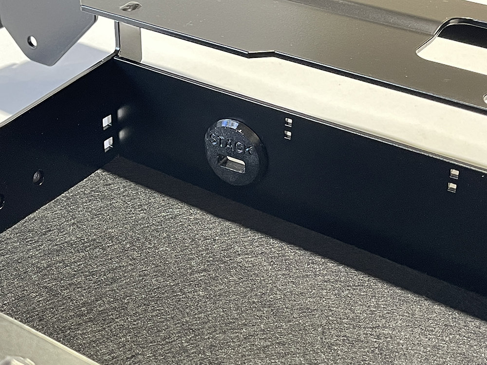

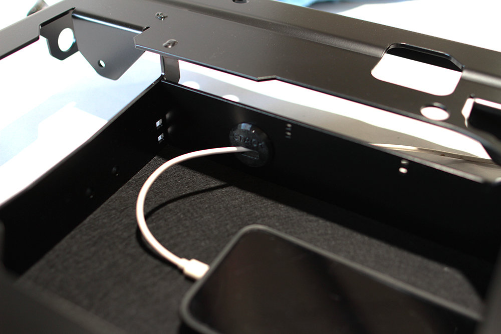

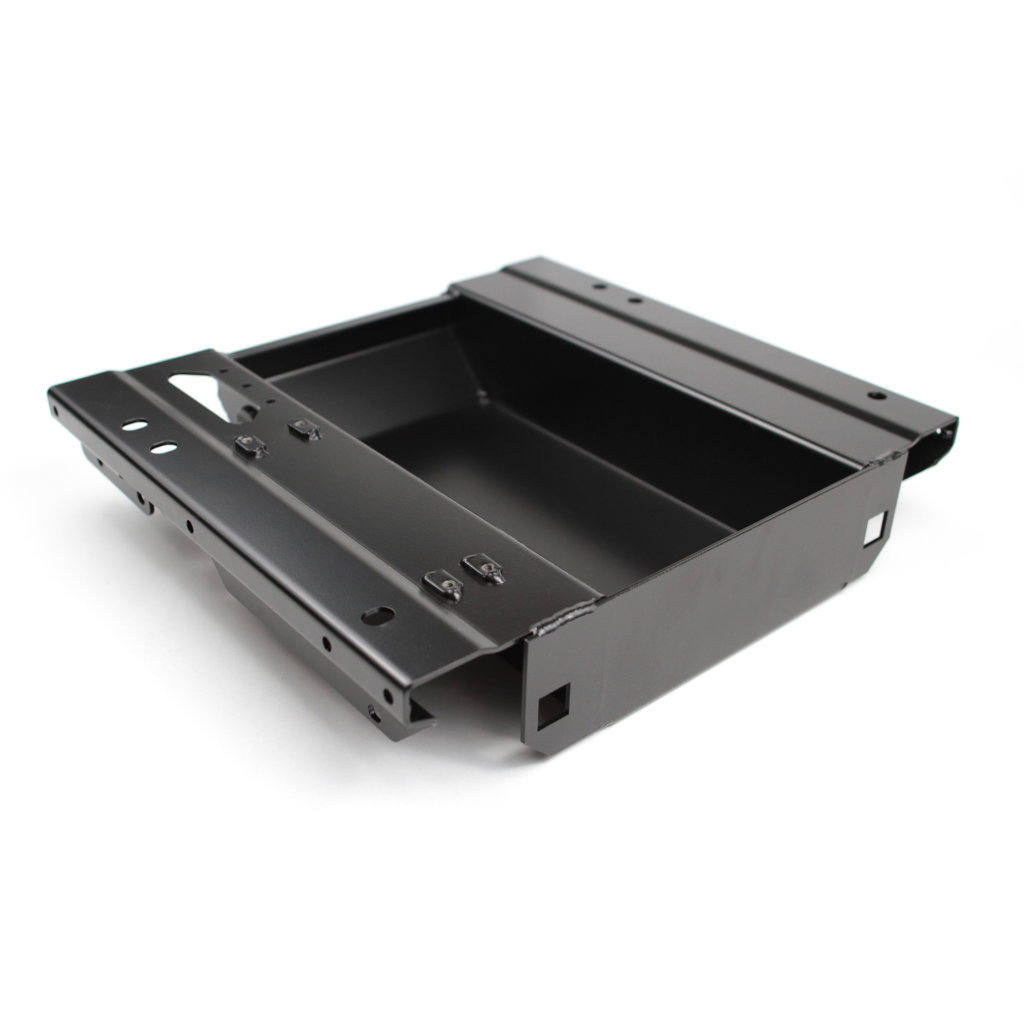

    Nothing all that particularly special about this little BlueSea style outlet plug/pass-thru. Simply put, all Tolerance Stack storage boxes have a "keyed outlet cutout". This means you automatically get a keyed hole that allows you to add in either a BlueSea powered cig outlet or a USB outlet into your storage box.
    Why? Because sometimes you want to put your laptop or ipad or cell phone into the storage box for charging while you go about your day.
    Well what if you don't want nor need an outlet? Well that's where this guy comes in. We 3D print these plug/pass-thrus in flexible TPU. These are designed to plug the outlet hole or act as a pass-thru for you Lightning connector or USB-C cable.
    Tolerance-Stack-PS-Klima-Liner6.jpg Tolerance-Stack-PS-Klima-Liner2.jpg USB-plug1.png

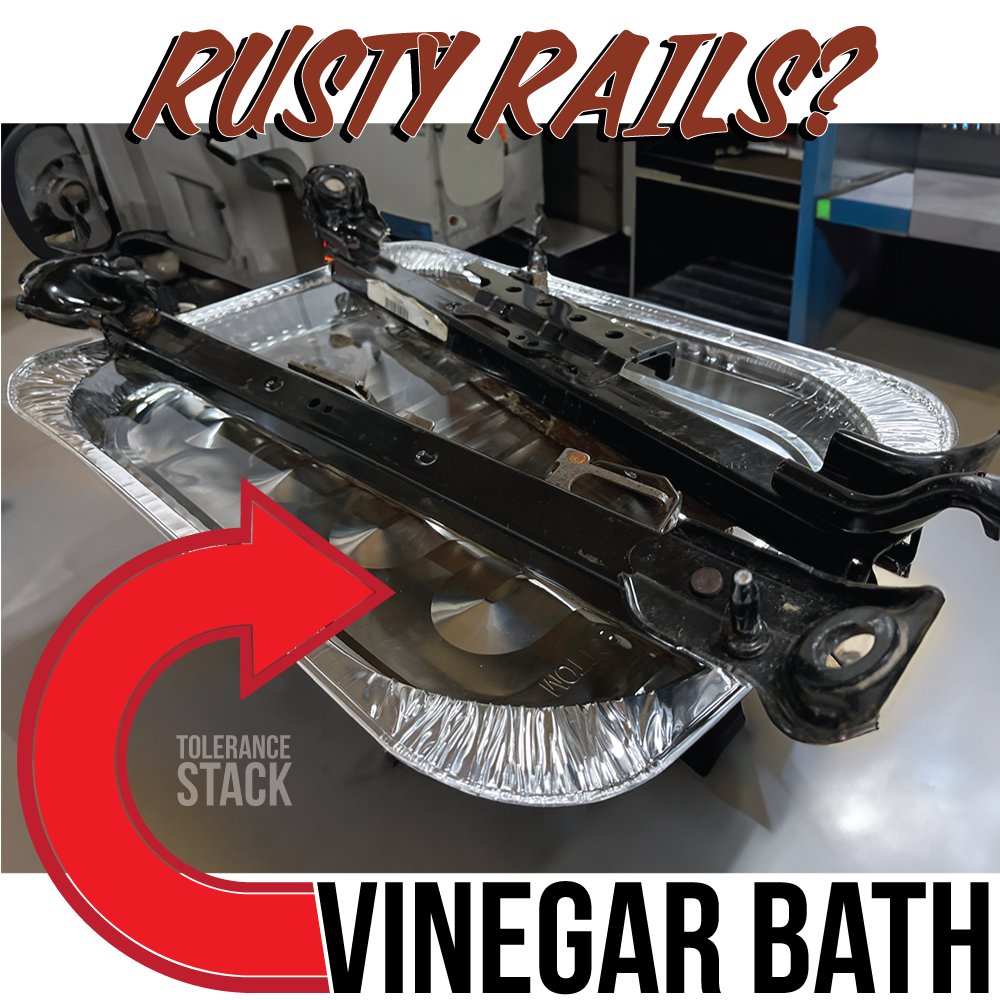

    We are starting to see it more and more- folks surprised by rusty rails (no not rusty nail, that's Scotch and Drambuie). Unless you live in the Southwest desert you are likely going to see some rust on your seat rails. There are a few reasons for this: maybe you live near the coast, maybe you live in a rain prone area, maybe you've spilled a few drinks...
    maybe you sweat–like a LOT!
    So what happens when you commit to your scheel-mann Vario investment to help mitigate your sore back issues on long drives, and you are knee-deep into the tear-down of your crappy OEM seats, and then you are confronted with rusty rails?
    Well, its definitely not the end of the world. You could absolutely ignore it because only the seat feet will be seen at the end. You could simply spray the rust with some silicone oil to prevent any further rusting. You absolutely could take the time to slap a wire wheel to your cordless drill, put on some safety goggles, and spend a bit of time making the rails pretty again. Or you could simply purchase a gallon of industrial vinegar (acetic/ethanoic acid) for $10 from your neighborhood hardware store. Then find yourself an unused disposable aluminum turkey pan, fill it up with the vinegar, and place the rails into the vinegar upside down.
    Keep the feet, sliders (bearings and grease), above the vinegar. Let sit and check on it every few hours. Most if not all of the rust will be gone or easy to wipe off. Once you remove the rails from the bath just make sure to full wipe down and don't let it drip into the slider mechanism. Good to go.
