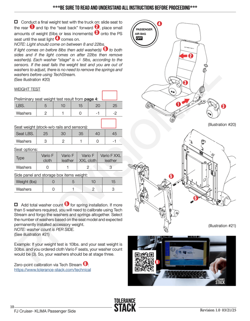

    Zero Point Seat Calibration Using Techstream®
    Techstream refers to Toyota's factory diagnostic and reprogramming tool, allowing technicians to access vehicle data, troubleshoot issues, and reprogram ECUs, and is available in both full and "Lite" versions. This quick write-up assumes either you, your installer, or technician has access to Techstream.
    When you are removing the OEM, computer calibrated passenger seat, with an upgraded aftermarket seat, you must get the seat's weight to the same as you are taking off. With the Tolerance Stack mounting system the solution is built-in. With addition of washers under a tensioned spring you can calibrate by adding washers to adjust the pressure of the spring.
    If its determined that you need to use Techstream to accomplish the zero-point seat calibration, simply follow along with the written instructions found here: https://www.tolerance-stack.com/technical or follow along with this video:

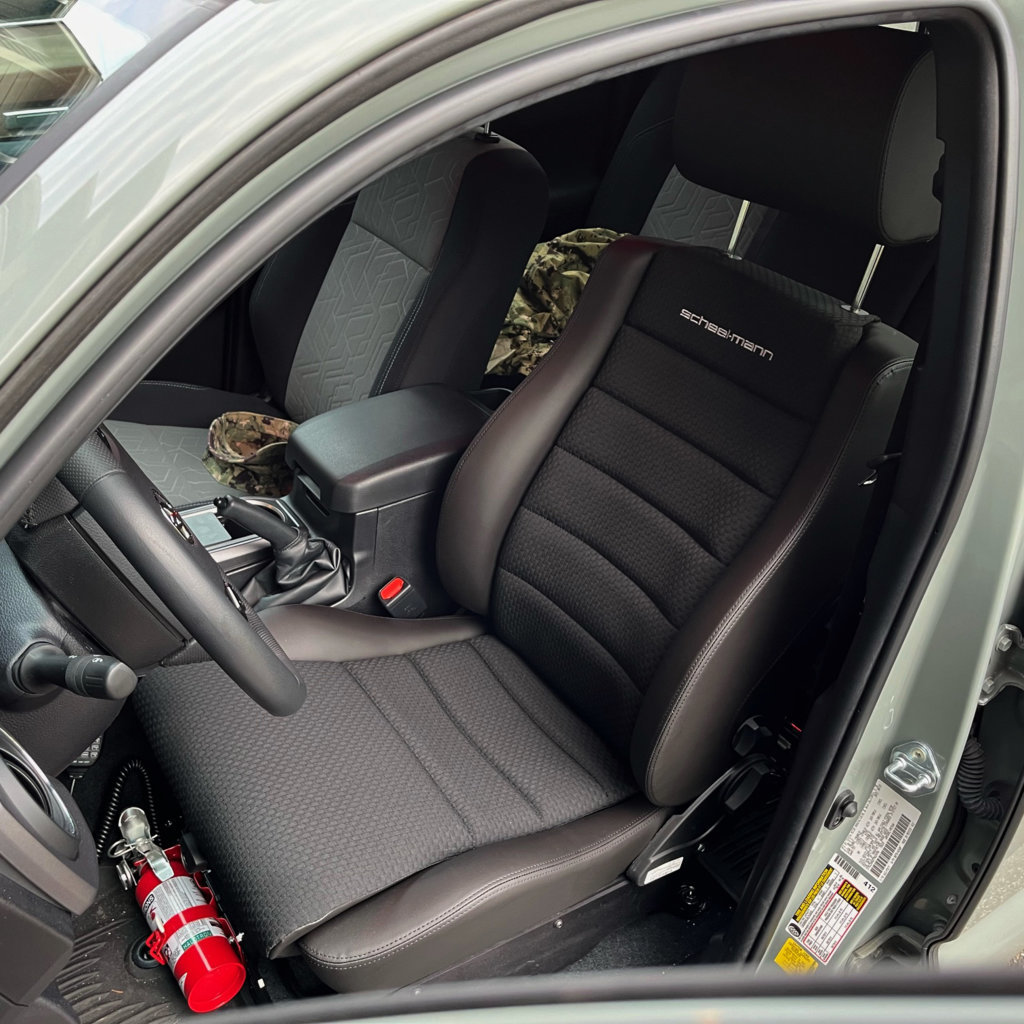

    We had the absolute honor of doing a Tolerance Stack and scheel-mann install for @resman.93 (on IG) in his absolutely glorious TruckHouse.co 2022 Tacoma build. Promise there will be many posts focusing on this Tacoma's seat upgrade adventure. More to come and gonna start a new thread focusing on just that.

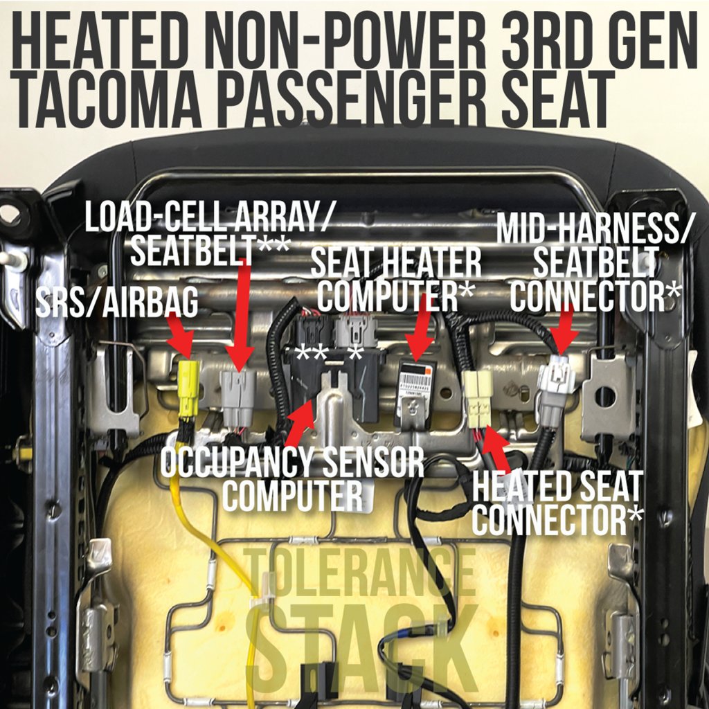

    Wiring and connectors for a non-power but heated 3rd Gen Tacoma passenger seat
    We are specifically looking at the passenger side right now because there is more into the wiring bundles than the driver side.
    Under the factory heated, but non-powered, passenger seat you have the “always yellow” SRS/airbag connector. ANYTIME you are even considering removing this plug you MUST disconnect the battery ground and wait for 90 seconds per the Toyota factory FSM. This means even if you are removing the seat just to give the carpet a good cleaning, the battery gets disconnected.
    To the right is the Load-Cell Array/Seatbelt connector. This is the connector that connects all four load-cells only found on the passenger side with the seatbelt connection info.
    Next over is the occupancy sensor computer which basically takes strain calculations from the load-cell array and sends that info to the truck computer thru the seatbelt/occupancy sensor harness.
    To the right of that is the Seat Heater Computer. Only OEM supplied factory heated seats will have this little black box.
    The next up is the heated seat connector.
    To the far left is the Mid-Harness/seatbelt connector. This is simply a connection point for mating two harnesses.
    Special thanks to David and Truckhouse to making an incredible work of art.

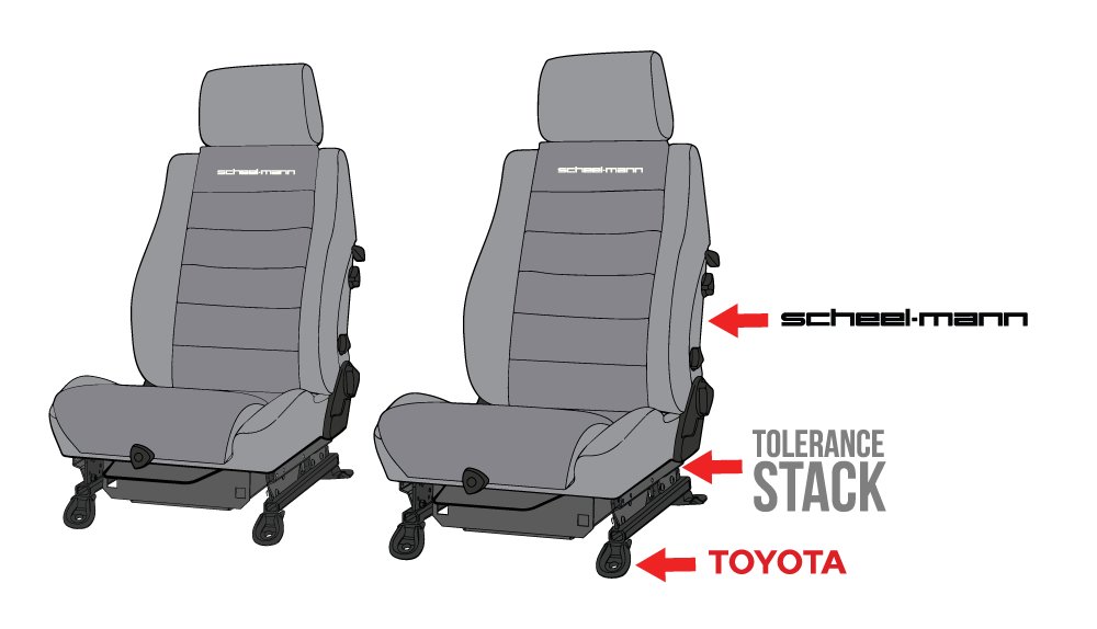

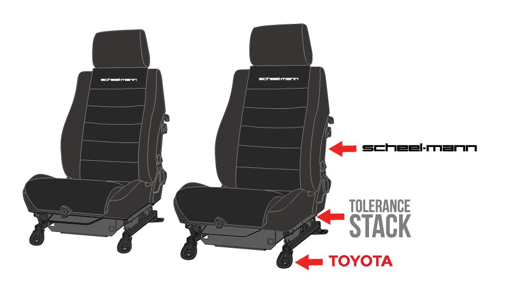

    Major Difference, Little Presence
    When designing the mating interface between your Toyota truck/SUV and the scheel-mann Vario F seats, Tolerance Stack is content playing the unobtrusive go-between.
    When deciding on a seat upgrade, it's usually a defining moment right?
    • My back hurts, time for better seats?
    • I can't do long trips anymore because of my back.
    • Back surgery, no riding in the truck for me anymore.
    • These seats are ugly smell funny, and are ripped.
    • These OEM seats are horrible.
    • I'm about to sell this truck the seats are so bad.
    Now that's settled, its time to research seats right? Keep it simple because there is only ONE compamy even making an all-in solution for your Tacoma, FJ Cruiser, or 4Runner. That is where Tolerance Stack comes in and with the task of staying out of sight, playing nice with Toyota and scheel-mann, and just getting it right the first time.
    Final decision is material and color, heated or heated and cooled.
    tolerance-stack.com

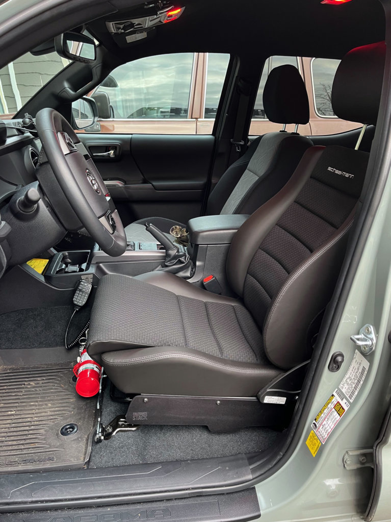

    Love it when customers send us installation pics and are happy with their install and overall experience. This customer out of Washington made the driver side upgrade using the Tolerance Stack kit to mount his scheel-mann Vario into his 2023 Tacoma TRD. He was able to locate his own manual seat from a junkyard which meant he didn't have to tear apart his own driver seat. Just an additional Driver’s Seat Position Sensor Conversion Jumper Harness was all that was needed in addition to our kit.
