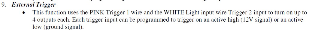

    Looking to connect pink wire to high beams on 2020 trd pro, does any one have schematic for color codes on led 6 pin connector? Looking for the high beam wire.

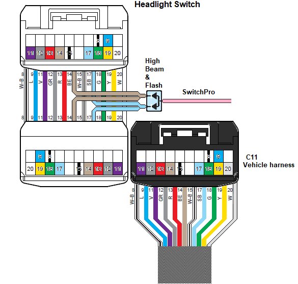

    If anyone is looking for the answer it’s the top white wire on the headlight plug, led lights trd pro

    Wired switch pro to turn on in grill light bar when high beams are activated. Or can activate any light with activation of high beams

    You could've also tapped into the Headlight Stalk High Beam select (-) wire...

    Yes that is also an option, but for me it was much simpler with the switch pro being in the engine compartment to connect to headlight connector than having to go through the fire wall and connect to the harness which has more wires. Either connection works though.

    Obviously you like connecting to a harness which has more wires, I like simpler and smaller hole in my firewall gasket while connecting to a plug which has only six wires. Again either way works it’s preference.
