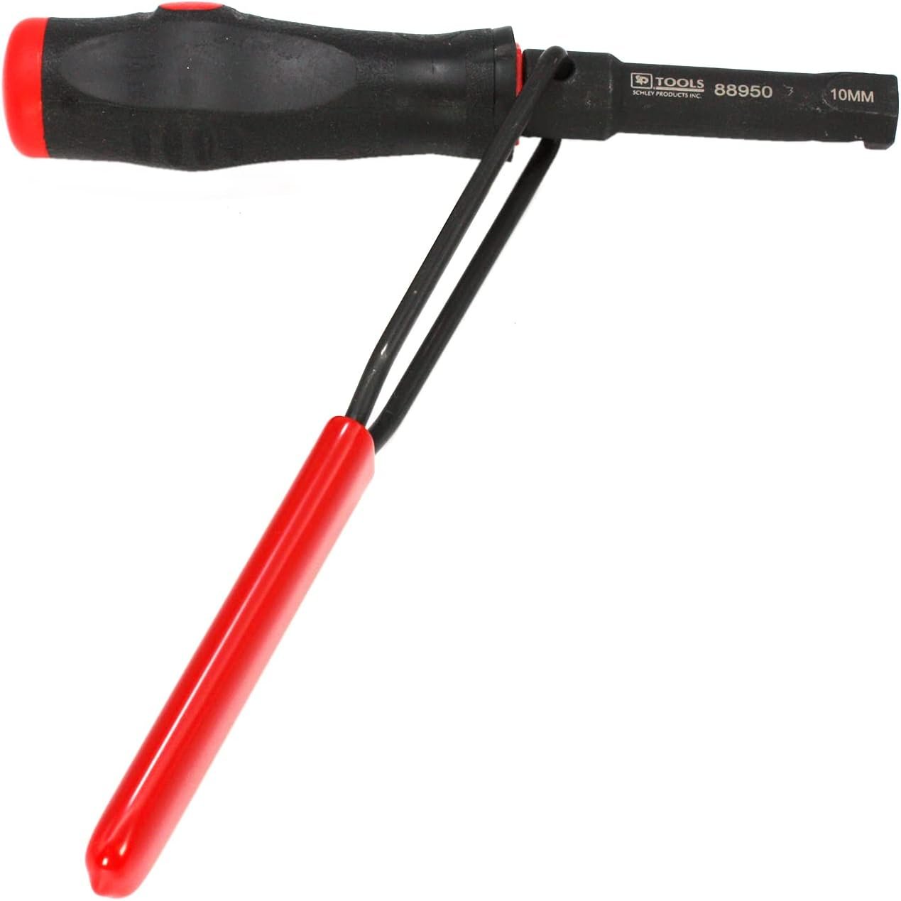

    Is there a replacement for this set of valve adjustment tools? Discontinued.
    Yes, I've heard you can do it with a screwdriver and a heavy friend leaning on it, but I need to do it myself and not risk being stuck without the tools.
    Is this 88950 tool meant as a replacement compatible with this engine?
    https://schleytools.com/products/uni-valve-adj-tool-for-10mm-jam-nut
    Alternatively, a Chinese knockoff of the original 88250 design. Could I get into trouble trying it?

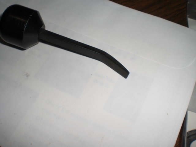

    I can more easily order the Schley 88950 and others online. The issue is the Schley 88250 is the tool set that has been referenced on here many times as the one that works for this engine, and it's discontinued. I'm asking for confirmation that the single tool 88950, which is a totally different design, works on the 5vzfe engine also.
    See the difference:

    I've found several videos showing how to get the shims out with the pliers and holder tool, by rotating something on the camshaft with the pliers and holding it in place with the holder on the edge of the bucket so the shim can come out.
    The jam nut tool looks like it loosens a nut on the camshaft? That sounds different. I can't find a video explaining it.
    The Kawasaki tool I can't make any sense of either.

    All you need is some curve tool to push down the edge of the bucket...
    while someone else plucks it with 20# magnet
    Kawasaki Valve Shim Tool Motion Pro 08-0019 | eBay
    20lb Telescoping Magnetic Pick Up Tool Extendable 31" Telescopic Magnet Stick Useful for Hard-to-Reach,Sink Drains Automotive Gifts for Men Women Husband Birthday Father's Day,Christmas(3PCS): Amazon.com: Tools & Home Improvement
    You need two people cause you have to really get down on that bucket.....its not easy....not suppose to pivot off the cam shaft.....have to use straight brute force....
    way its been done for 100 years at auto shops...
    at least on jap cars....
    the schly tool and that lock pick allows you to do it solo
    Toyota 3RZ-FE Valve Adjustment (youtube.com)
    All you really need is something small curved and super super stiff to get around the cam shaft...
    And then I'd have to get on top on engine to get enough leverage.......reaching out from the side is not gonna work...
    .....and a helper.....to hold the magnet and cheer you on.
