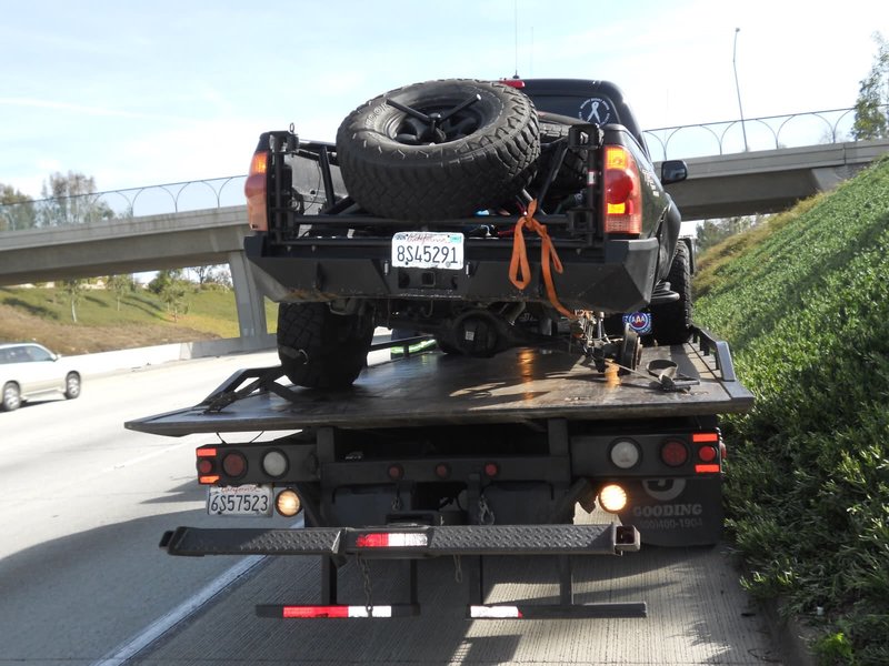

    Wow, I've never had any wheel spacers in the rear you dumb ass, and if you had taking the time to read my original post you would know that. Stop trying to twist the truth into your false prooganda and lies. What happened here was OEM wheel stud failure, probably from me always taking my wheels on and off for maintenance and/or prepping for a weekends run. If you take some time and look it up I'm not the first person that has this happened with OEM studs and without spacers.

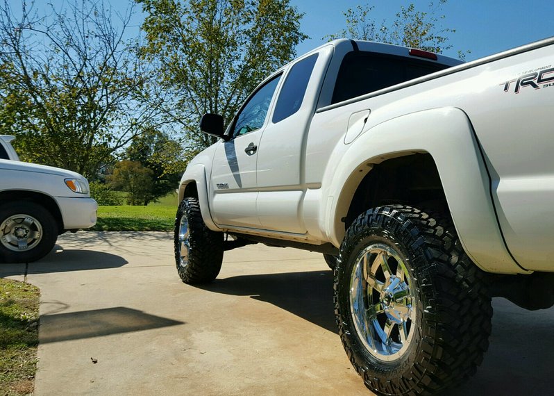

    [​IMG]ok I think I want these in 17". I think I am only going to level my truck. So what back spacing and tires would be the best fit? I kinda want to stay close to factory tires size for fuel efficiency.
