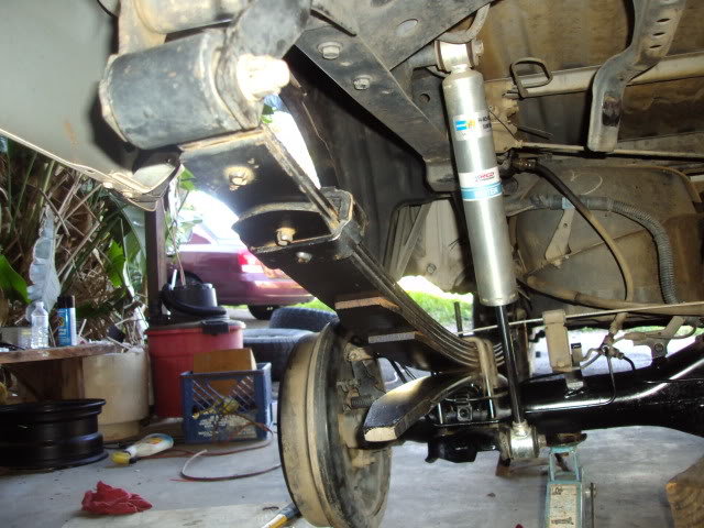

    I was told that when they installed the 3 leaf pack that they took out the over load spring.
    While looking at a few threads on leafs I noticed that the only difference between mine and the stock ones I saw was the 3 new leafs. Am I wrong?

    Your stock overload spring is still in. That is supposed to come out with the 3-leaf AAL (Is that the ICON AAL?)

    not sure if i'm following this correctly but with that overload still there you must have roughly 4" of lift, depending on your bilsteins they might be maxed out hard to tell from pic

    Not quite, with the overload in he is probably getting about 2.5'' max.
    The 3 leaf AAL gives 1.5'', and the overload leaf is like 3/4'' thick; so the 5100's should be fine.

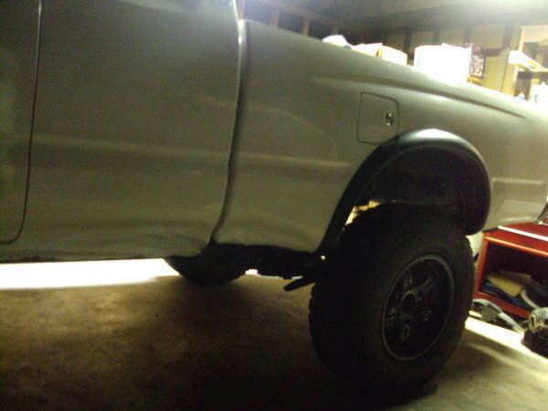

    Not a good pic but this was taken right after spring rebuild w/overload
    tires then were BFG A/T's KO's 32" 's

    Spring rebuild :confused:

    yup, spring rebuild or spring refresh whatever yer pleasure....:cool:
    stock 1st gen. leafs with the addition of 2 Ford springs per side
    3" lift gained , have since dumped overload

    oooooh...I remember seeing that.
    Thats a pretty cool setup.
    How does it ride?
