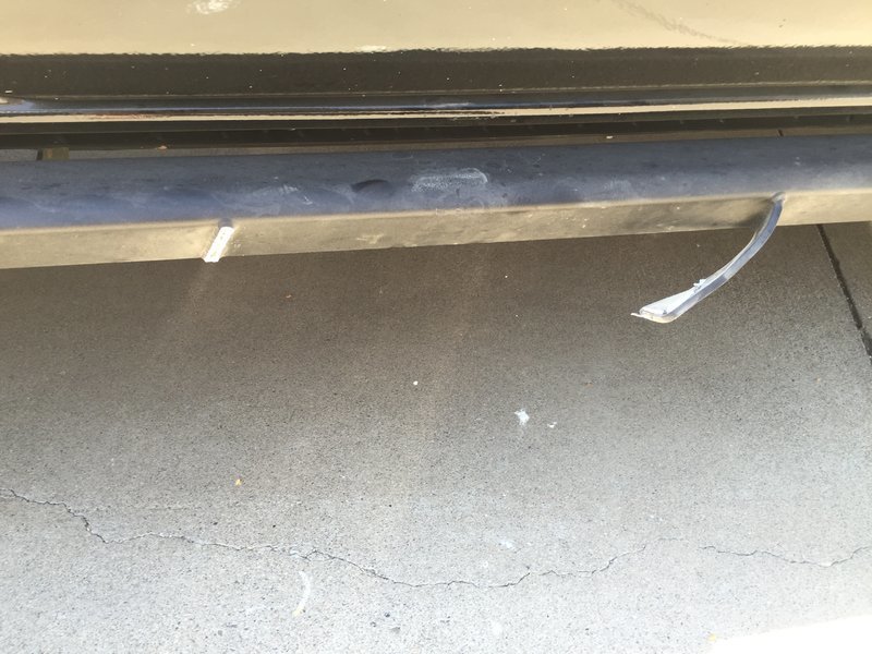

    I've read it here hundreds of times. Running boards are not rock sliders. Learned the lesson the hard way today with my predator tube steps.
    With that in mind, time to upgrade to rock sliders. What am I looking for in rock sliders? Good fabricator, style, length etc.
    I intend to mostly use my taco in desert environments chasing quail, and the more rugged the location I reach the better the quail hunting tends to be. Goal of the sliders for me will be protection of the truck, as I don't intend to hit off road trails or become a weekend warrior.
