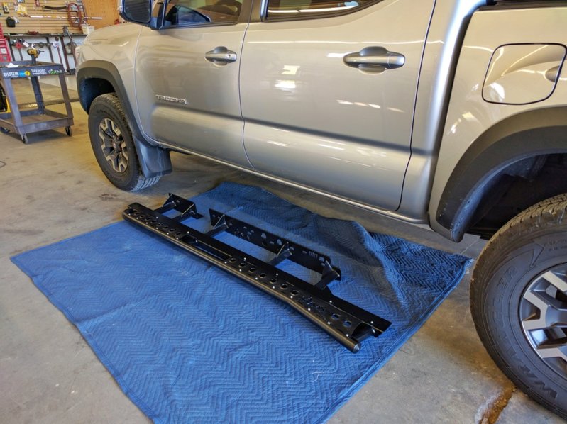

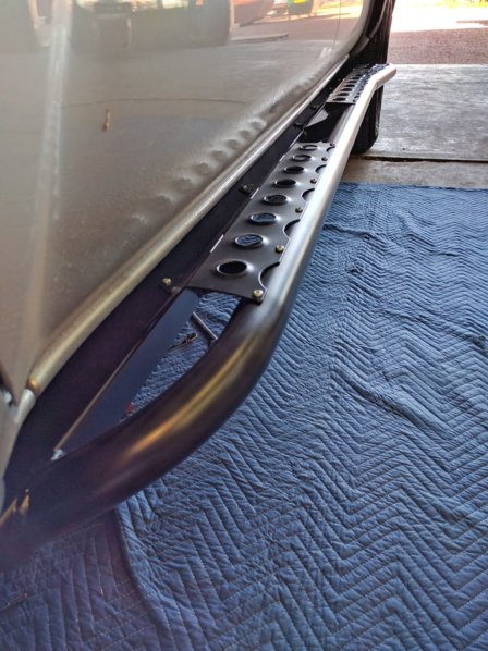

    For those of you looking for heavy duty sliders that also functions excellent as a step without loosing any clearance, check ours out. We have them available for '05-Current DCSB and ACLB. We are currently working on '05-current DCLB right now and will be available in a couple weeks.
    Our sliders feature a hybrid design using square and round tubing. Frame mounting plates wrap around the bottom of the frame rail for more than enough strength (We lifted the entire Tacoma at expedition weight off the ground with our car hoist attached under the main rectangle tube and the sliders deflected upwards no more than an 1/8"). The sliders come standard with kickout and a 25 degree up slope on the outer rails.
    The best part is that our removable step plates still sit at 0 degrees for an optimal stepping platform!
    Current lead time is 3 weeks.

    Looks good. What's the clearance to the rocker panel?
