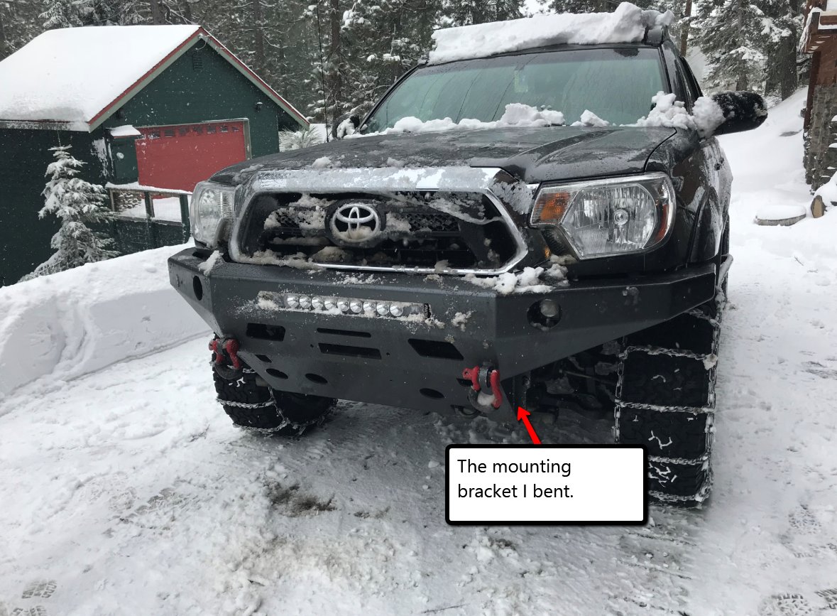

    I've never been stuck but I screwed up last year and pulled out a Chevy 2500 with a strap and only one of my shackles on my Pelfrybilt Aluminum front bumper. Bent the bumper mount out about 1". I gently drove into a tree to get it back to spec but once you bend aluminum its just a matter of time before it breaks. Moral of the story....equalize your tow mounting don't rely on a single point of connection unless its a hitch. :-( I don't have a winch but I suspect if I did I would probably end up ripping the bumper off at some point. Shame on me for going with the Aluminum.
