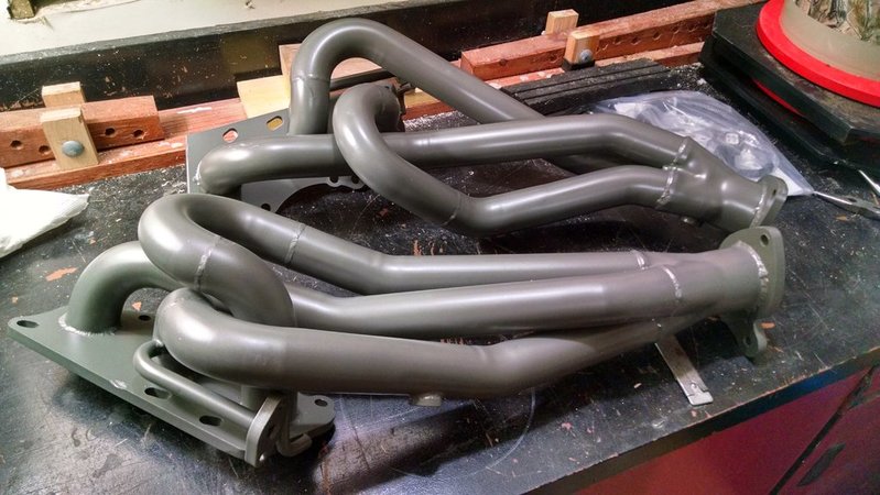

  19. Sep 14, 2015 at 12:14 PM
    #2299
    SconnieHailer
    SconnieHailer [OP] PutterClutch
    Aug 26, 2012
    #85590
    9,765
    Marc
    West Central Wisconsin
    2012 TRD Off Road Double Cab V6 6Speed
    These showed up at lunch today!
