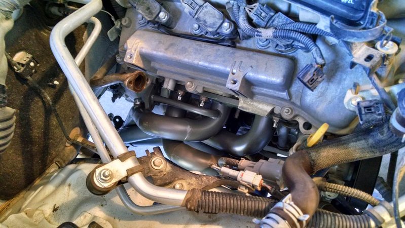

    Well both sides are on. Lots of little stuff left like wires that are too close and need moving for the starter... Connect headers back up to ypipe and bolt up the rest of the piping I had to unbolt to get the driver's side in. On that note, the driver's side was way harder to get in than passenger. I left all studs in since there was no room to torque them once the header was in place... Got it in and ended up taking the whole steering linkage apart not just the bottom out of the top. That gave me all the room I needed to get it in with all the studs in. Anyways, I'll post completed pics tomorrow.

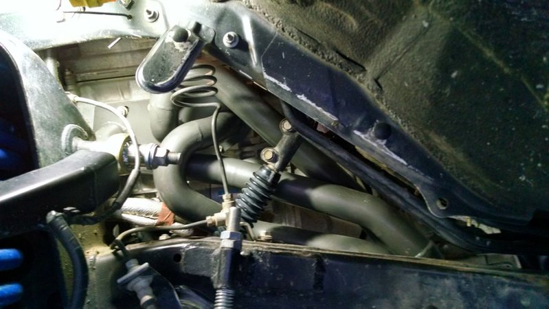

    Driver's side teaser. All that pretty ceramic scratched to hell :pout:

    Nice! Those look a helluva lot better than my buddies' afterwards :rofl:
    Not to Hi-jack but I'm in the planning stages of a trip to your neck of the woods here next Spring! planting that bug in your ear, you'll have to show me around!

    I had some rage moments. I'm lucky my arms are small... I'm not sure how some people could get in there to tighten down the stud nuts on driver side. Gonna be a full 8 hour install not including pulling skids off. Lots of little things happened tho, like that moment when you drop an important nut and it doesn't hit the floor... Also fk air injection systems, would done easily by now if if weren't for that stupid shit.

    Been there. Itll be worth it though.
    On my turbo 240 i would always lose the nuts on the back side of the damn turbo flange. Which meant no wrench or ratchet could fit and it was against every single damn thing possible and you couldnt even see it without tilting your head like an owl

    I remember the drivers was the worst too.
