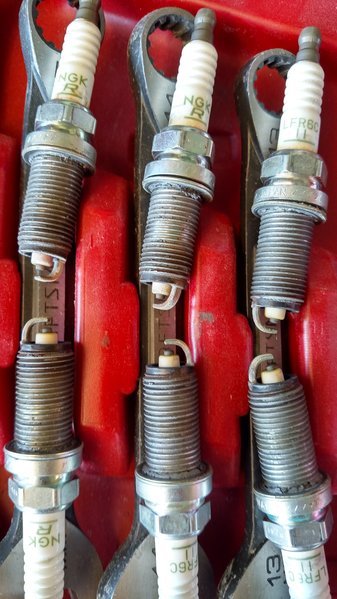

    Alright, need some expert plug readers... @Torspd @Lucario Runner ? How do these look to you guys ? Just pulled them today and their in the order of front of the truck to the right. They were really opened up in gap @.055 spec is .043 max. They also smellEd like blue cheese, like exactly like it. They've been in the truck for maybe 40k max. Headers have been on for the past 10k maybe with the o2 sim. I have a stock air box.

    So I think the smelly plugs is because of old e10 gas. At least that's what it sounds like it is after a bunch of reading. I hate ethanol as a gas, even though it made great power in the Evo it's so hard on everything.

    you'd be correct. what octane are you using? any fuel additives?

    I run 91 almost always. No fuel adders. I might run a bottle of techron thru next tank

    Thanks, i run redline for my trans and diffs and have been really happy with it, not sure why I didnt look to see if they had anything for fuel. I'll report after i run a treated tank through it. So far though on new properly gapped plugs the truck is running so much smoother. Pretty happy about it actually haha.

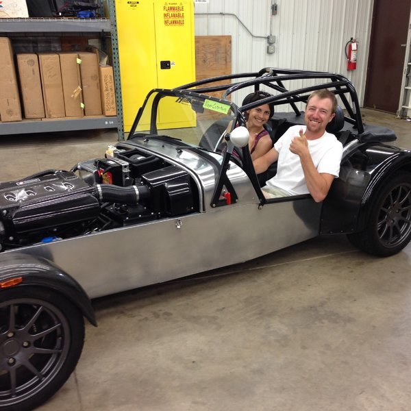

    So this happened :D
    Jk, my dad bought one. Wish it was mine though. So damn cool.

    joshipps
    joshipps Well-Known Member
    Sep 14, 2012
    #86958
    4,050
    Josh
    Wyoming
    95 Tacoma 4x4
    Sick dent
    Pretty decent Evo replacement i'd say

    2002 XtraCab TRD 4x4 SCv6 AutoTrans With Lots of Mods ADS COs w/Compression Adjusters Camburg Uniball UCAs Whiteline Lower Control Arm Bushings Kartek 7" Limit Straps Plastics Guy Front Bumpstops Total Chaos Sprindle Gussets Custom Alcan Springs +800 lbs +3" ADS 10" Stroke Triple Bypass w/Resi Rear Shocks Custom Rear Shock Relocate All-Pro U-bolt Flip w/Timbren Bumpstops 4.88 Nitro Gears ARB Front Locker ARB Twin Compressor Black 17x8 Konig Countersteer Type X 285/70r17 Falken A/T3w Gunmetal 16x8 SCS Ray10s 255/85r16 Maxxis Bighorns Limited Edition (Relentless) Elite Front Bumper Smittybilt X2O 10K Winch Diode Dynamics SS3 Sport Selective Yellow Fog Lights in the Bumper Diode Dynamics SS3 Pro 4,000 Kelvin SAE Driving Lights with Clear Lenses on the Bumper Morimoto D2S Projectors XB35 Ballasts + 4300K Bulbs Badland Sliders FrankenFab Tire Carrier Swingout bumper w/kitchen BudBuilt Front & Bellypan Skids BAMF Rear Diff Skid Dometic CFX 55im Fridge/Freezer Alpha II Hardshell RTT Badland Custom Bed Rack Denso 210-0461 105 amp alternator Dual Northstar 24F AGM batteries BlueSea 7622 ML-ACR Battery controller Peak DBI Dual Battery Voltage Monitor Haltech IC-7 Display with Mako Dash Insert Haltech Elite 2500 Standalone ECU Magnuson MP62 Supercharger w/URD 2.2" Pulley Doug Thorley Headers Denso 650cc Fuel Injectors Aeromotive Stealth 340 Fuel Pump TransGo A340F Reprogramming Shift Kit OEM ECU Delete Full A340F Trans Control with the Haltech 2500 ECU 2.5" Magnaflow Hi-Flow CAT Magnaflow 18" Muffler w/Vibrant Resonator 13WL Brake Calipers with OEM Rotors & Pads Braided Steel Brake Lines Kenwood TM-71A Dual Band Ham Radio STI-CO Flex Whip VFH/UHF 1/4 Wave Antenna Midland MTX275 GMRS Radio w/Roof Mount Antenna Pioneer DEH-P9400BH HU Alpine Amps & Type R components (F) and coaxials (R) Wet Okole Seat Covers Weathertech Digital Liners Deck Plate Mod 1" Diff Drop Carrier Bearing Drop
    Caterham?

    2012 TRD Off Road Double Cab V6 6Speed
    Yep. We'll have it out for a drive tomorrow so I'll bring the GoPro with :)

    Nice! Which version?

    The 480
