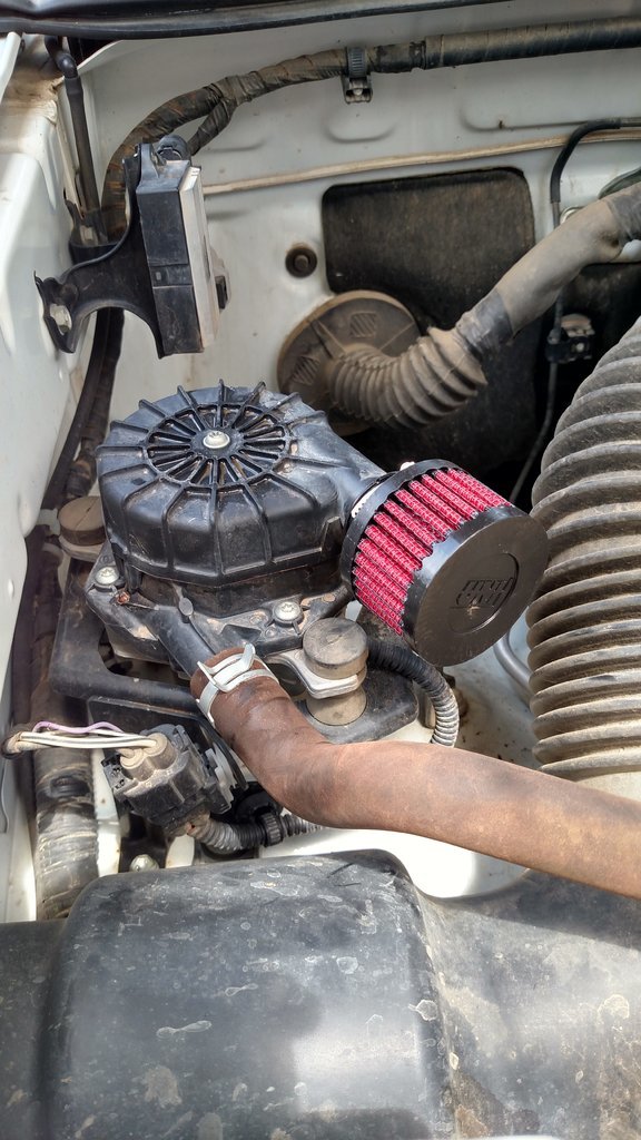

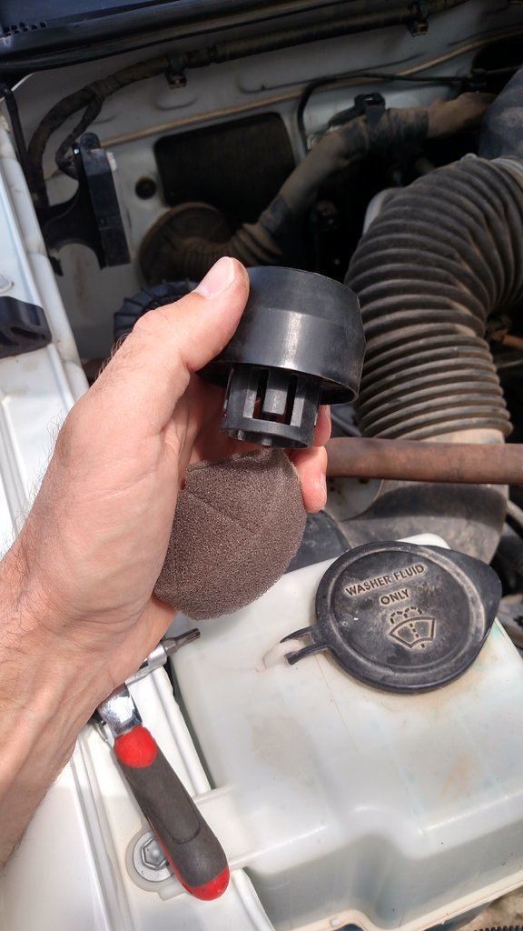

    Fresh mod!
    Replaced the bs foam filter in the air injection pump. Heard of them getting sucked into the pump and causing all kinds of issues. Pulled it out of the housing and put a small filter on the outside. Should fix the problem!

    Any other benefits of this change or just to ensure the foam filter doesn't get sucked in?

    Nope just making sure that foam filter element doesn't get sucked in.
