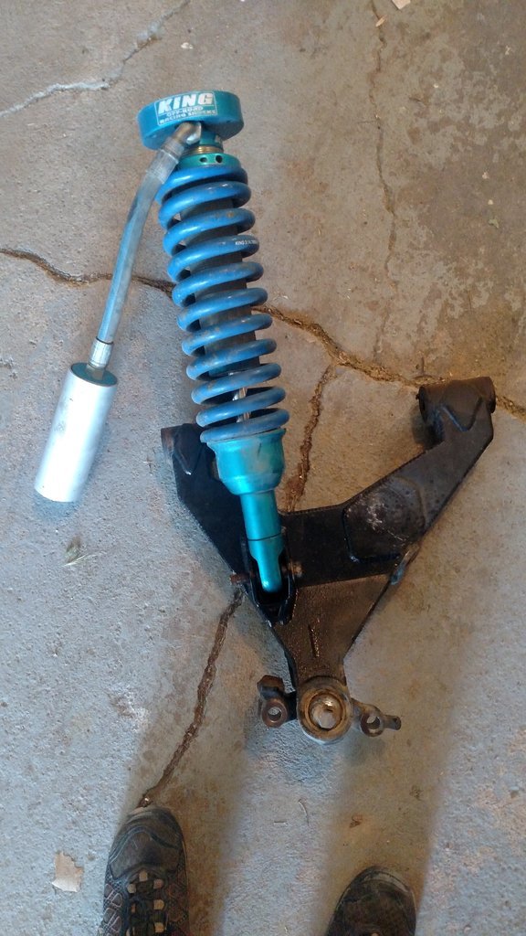

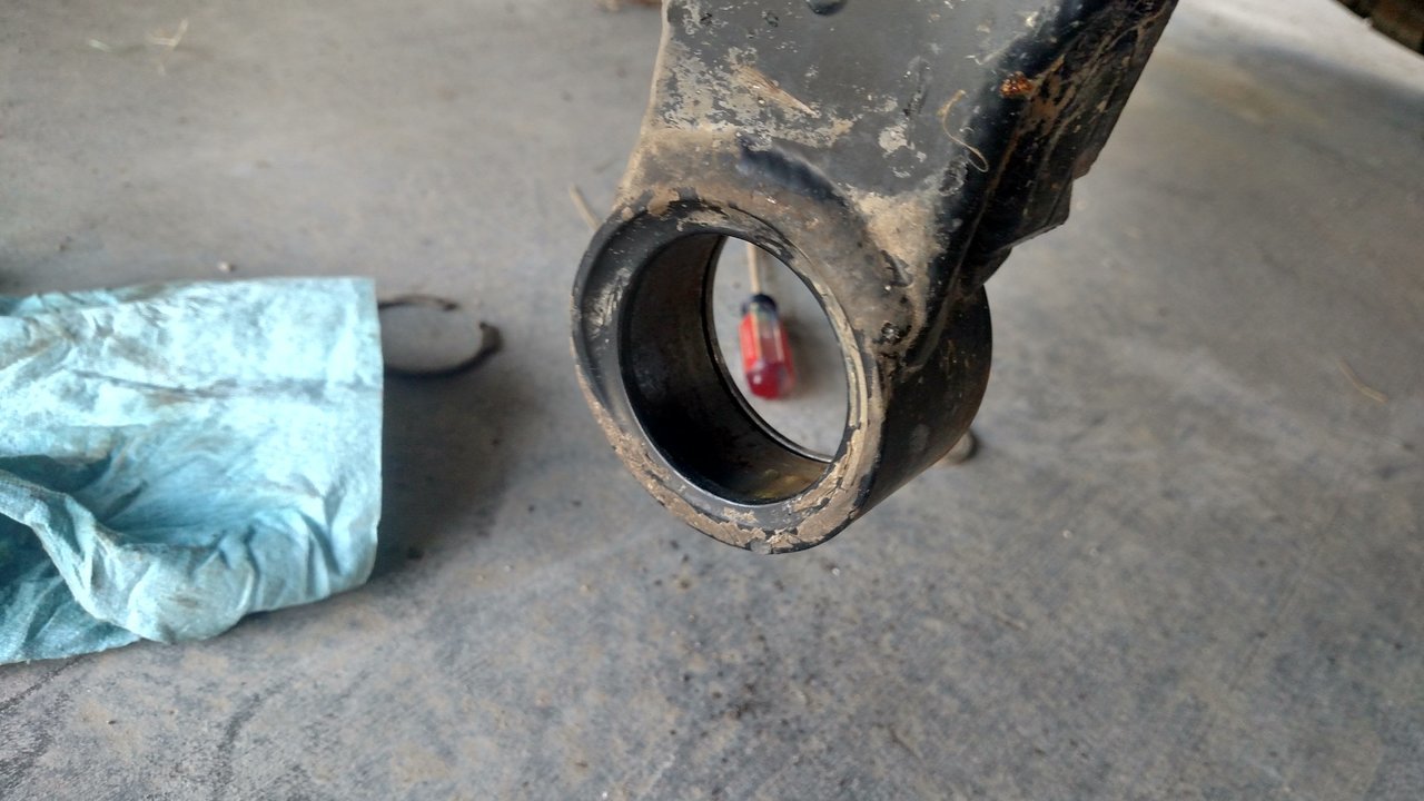

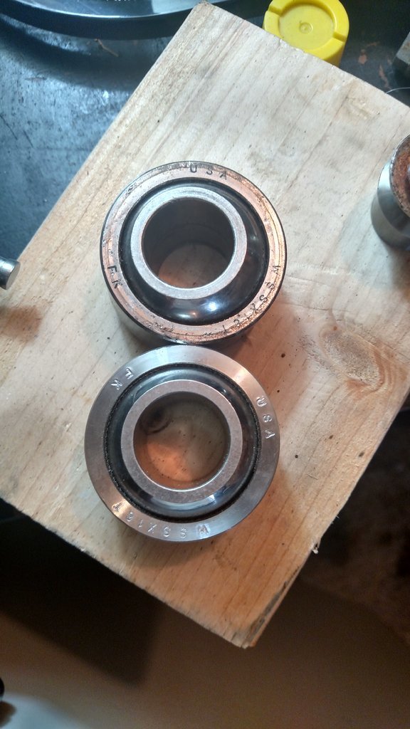

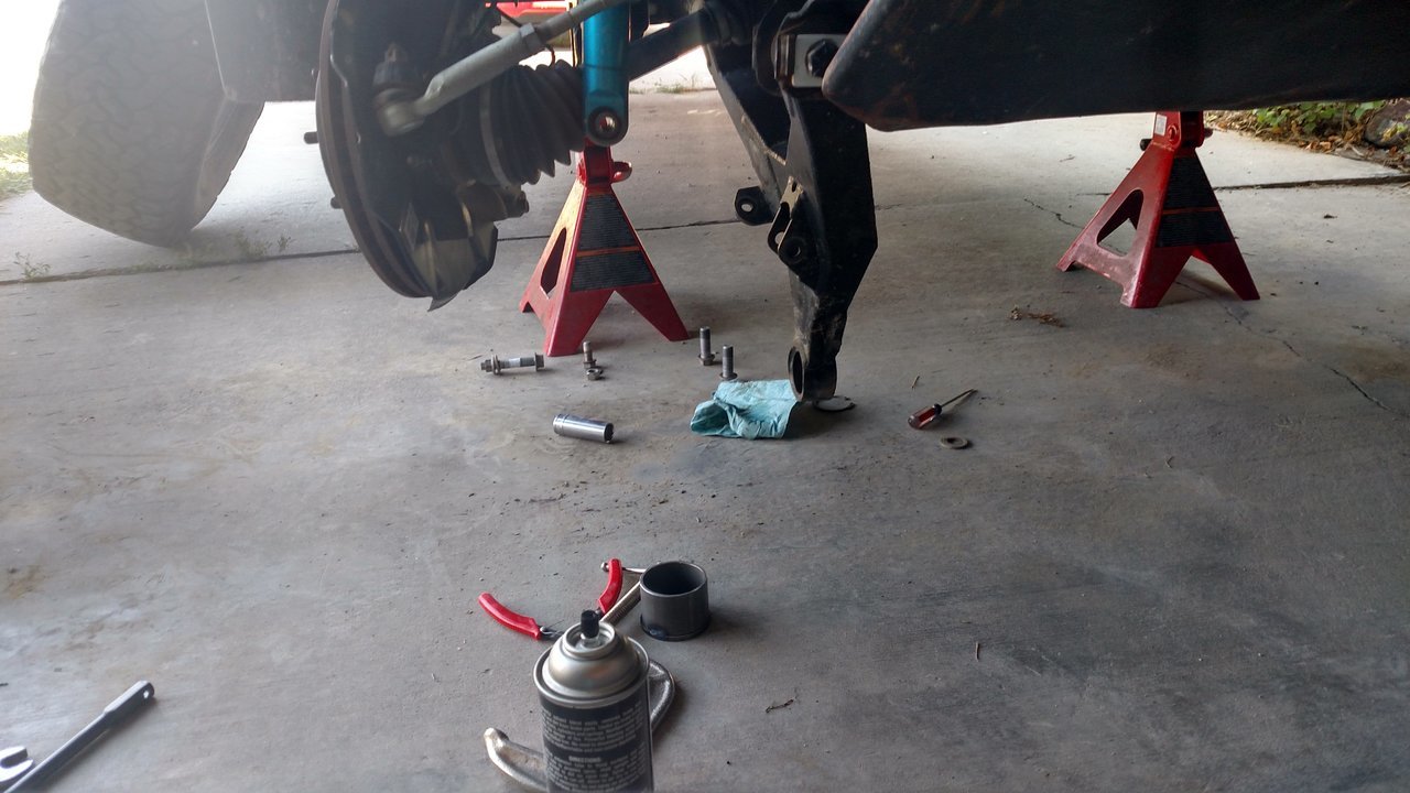

    Replaced the uniballs in my lower control arms today. Pretty easy job, until I got to the driver's side and the shock to LCA bolt was siezed. I even went at it with a 8lb sledge and it didn't budge, was even bending the mount on the lca :eek: I'll probably end up cutting it off :angrygirl: put it back together for now and it feels nice and tight with the new balls!

    :eek:. And I'm assuming you hit that bolt with a penetrant prior to hammertime too? Damn, end up giving it a little coat of anti-seize before re-installation?

    Oh yea I panther pissed all over that bolt and let it soak. I think it's bent is the problem. It's time for a new bolt cuz I'll probably have to cut it out/drill it.

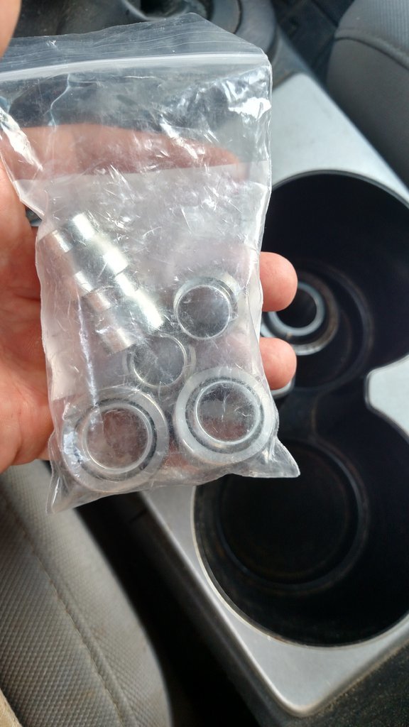

    New rod end bearings and spacers here. Shout out to @Downsouth Motorsports for picking up the phone and having my order done in like 5 min. Knew exactly what I needed right away and got it here in 3 days. Service!
