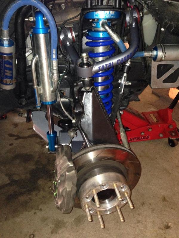

    You need to strap the front, you're flexing the front more than the shock has travel. Because of the heavier wheels and tires, the suspension is drooping out a little more than it normally should.

    Could that be part of the cause of the heim wear on the lower shock mount Drew? My kings are non-extended versions and i'm totally stock lower and upper arms. Oh and my wheels are lighter than stock! 18lbs per wheel :D But yea, I really should strap it up :eek:

    I just went through your build page by page, yes that is the problem. Non extended coilovers should only be paired with stock upper and lower arms, but if you put a heavier wheel, or heavier tire,or both you will over extend the shocks. I noticed you have the DSM uca's. Those arms with the heims will yield a bit more travel, enough to pull on a non extended coilover basically like a yanking or jerking effect. Strapping the suspension before it's full droop would solve your problem.

    I had the DSM desert products boxed uca's on for a while but took them off when i started running the MTR's cuz i could clear them easier with the stock arms and its all been dandy. The DSM UCA's are in my "Oh shit box" as backups for the trail. I will likely be doing a re-build on my coilovers and turning them into extended ones while im at it when i replace the lower hiems on em.
    I'm in this huge dillema to go 2+ or just stay stock width and go stock length TC arms cuz stock wont last much longer with the amount of rock rash on em...ugh...
    Thanks for the input Drew, what length strap would you recommend to get me in the ballpark before i go measuring?

    I've had my share of LT builds, so I can tell you from experience it's not worth it to go LT. I plan to get the race built TC lower arms to go with my TC uppers, so that's what I would do if I were you. I'm going to run bypass front and rear and with them properly tuned I'll give an LT truck a run for its money. As for straps, I think a 10" is the smallest strap. I might have a complete strap kit with clevis' s, 10" straps and weld on bung for the clevis's in my garage. Would only need to get the lower tab mounts, which I can get from kartek.

    I've been drooling over the TC stock race lower as well. Likely what i'm gonna do at some point. I believe you about LT and since it's my dd too and I just wont get the moneys worth out of the LT I think.
    Ordered new lower bearings for my shocks. I just hope I didn't do more damage than I think, guess i'll find out when i pull it if the whole rod end is jacked...
