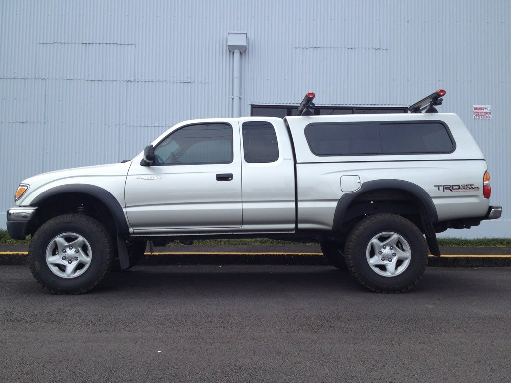

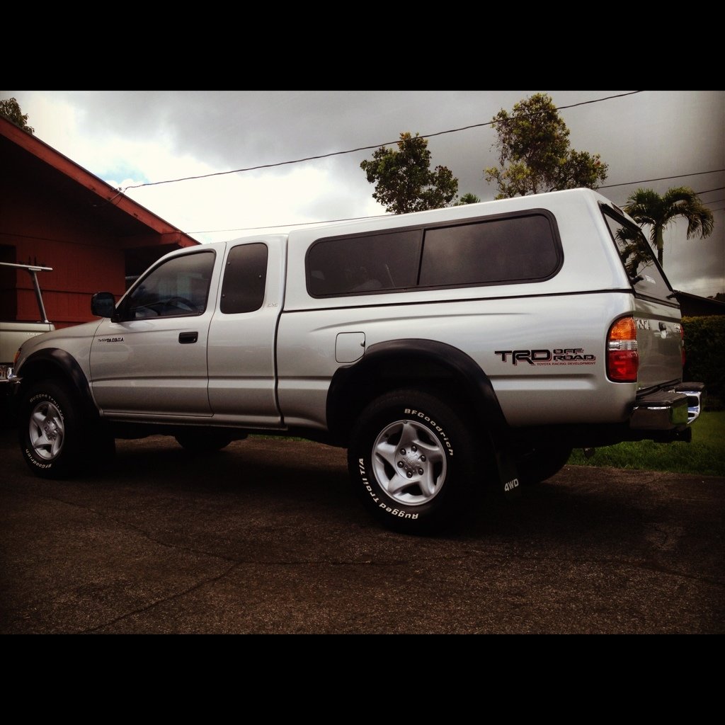

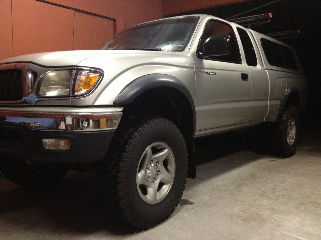

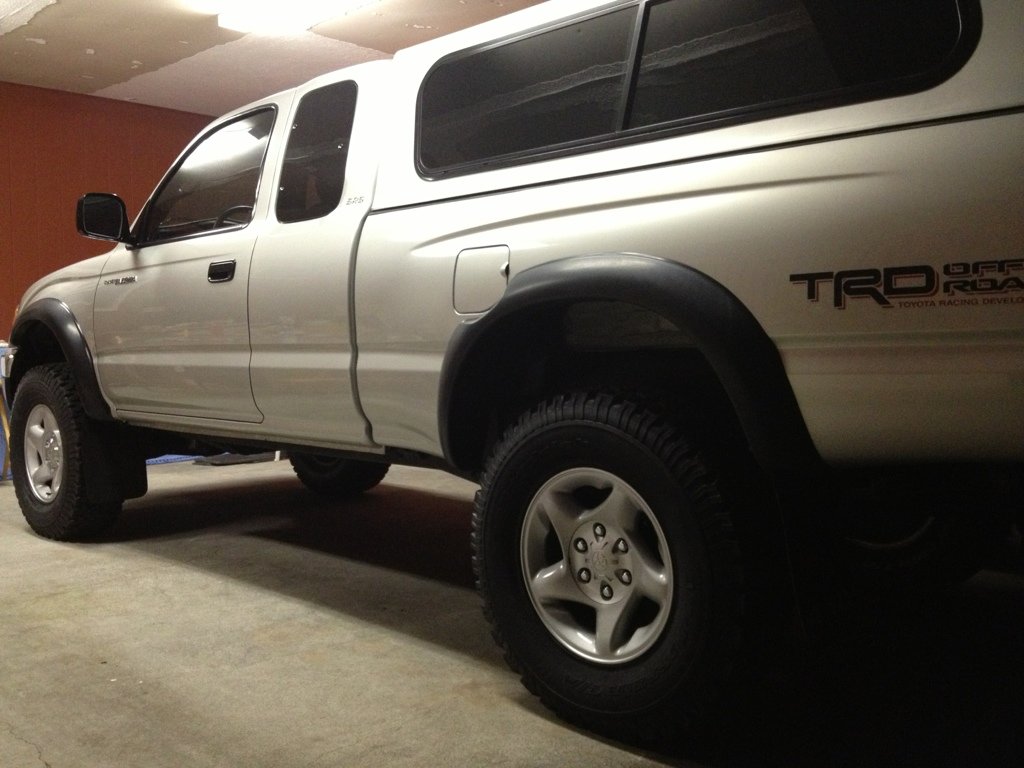

    Started with this pristine 2002 TRD Xtra Cab with only 27K miles. Other than the external auto trans cooler, Snug Top camper and Valley tow receiver it was bone stock.

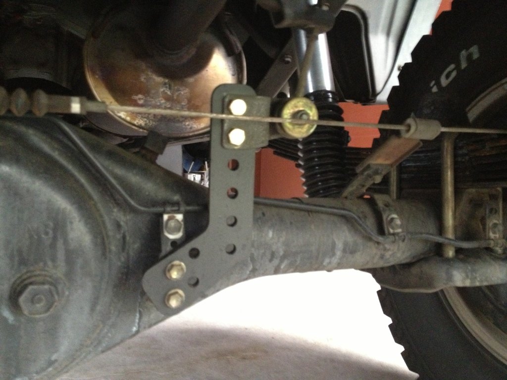

    3843DD78-1A3E-4B73-808A-2F3A0DBB2855-226_7297d240cf674c544b03997f0d29dc4016a32039.jpg
    4DC5C549-080D-41C4-89B5-17F2AED9A2ED-240_66e56688860f34fd079b5f5b4c7e7756b8797ba3.jpg

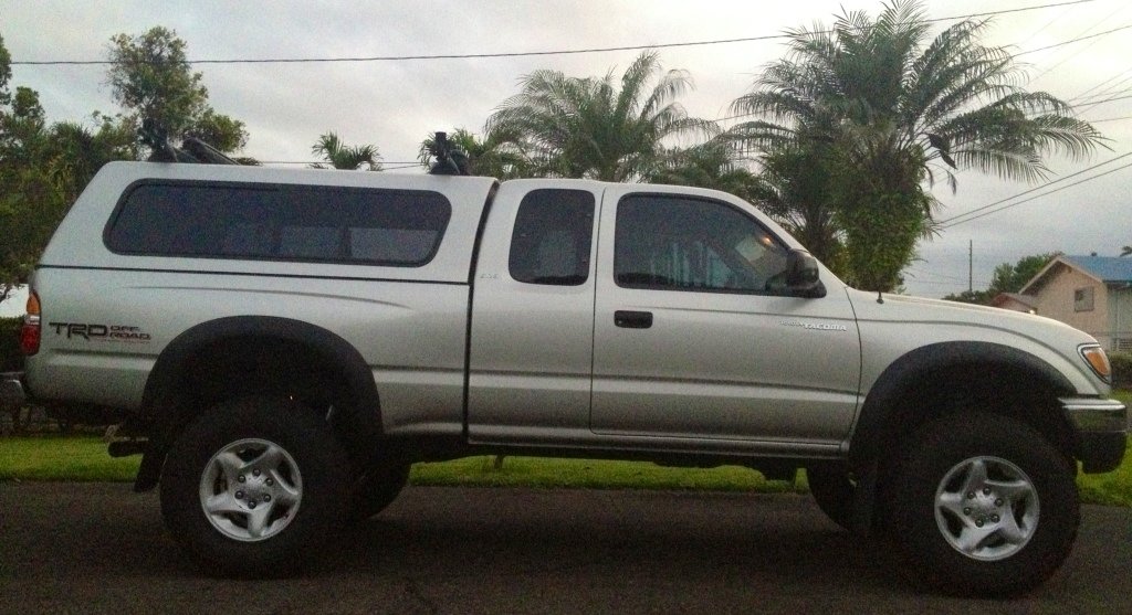

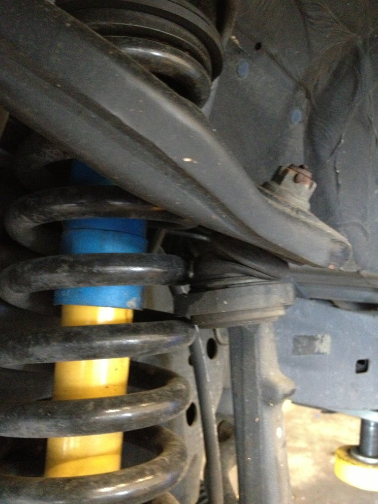

    Installed a 3" EZ Lift. Don't ever buy one.
    C1AC95F0-0B63-4D42-AEA6-8E0BC1FC3869-205_081ccd5fe25f642038d5b30e7026450d79eb933e.jpg
    BFG All Terrain KO's.
    24475215-77A9-43BF-B838-B5363CDA2897-205_14ecd002f02d081ca3c872eaf388bf0a8a011fe1.jpg
    600-800 lbs. on stock leafs with an AAL...not good.

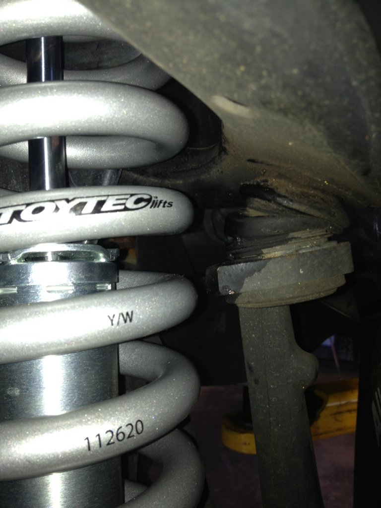

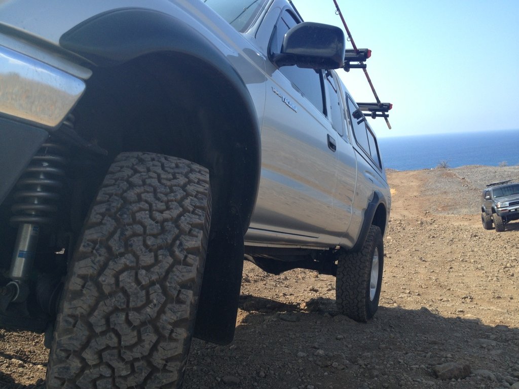

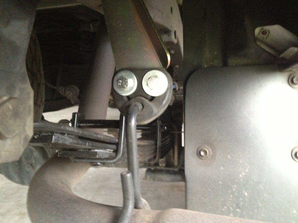

    Don't install a spacer lift.
    At full droop...
    D35C4CB3-8AB7-43AB-91B1-9C3460CFEF91-226_d45b17eb8102f875cde48b8ffcd2edcd937e7531.jpg
    9C555134-8D1A-40D0-9572-2CE923A22627-205_87396b6c2b3dc075ce0b9aa485ed139b415d4ff6.jpg

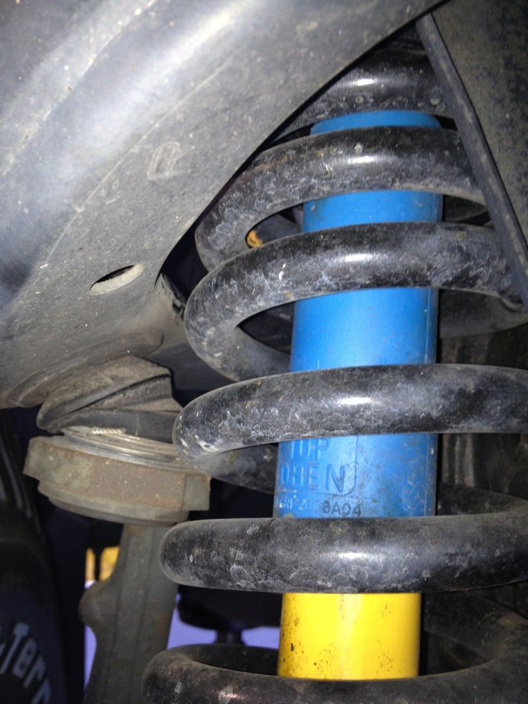

    Do it right the first time.
    CF77537B-E9FA-4463-82C7-7BE4E3567596-226_02561c2e550c4f55e644a897ee5a170a770a7f4b.jpg
    Set at "0" at full droop...
    62E7FE70-C36D-4696-91B4-55521ADA139D-205_19f2cca682997471b7b26d60a0a3303d80a8830a.jpg
    70309020-67D8-4B96-B696-7F36DC0D5358-226_cb7da80d330b81bab0ce6df8b78465cfd3d0a368.jpg

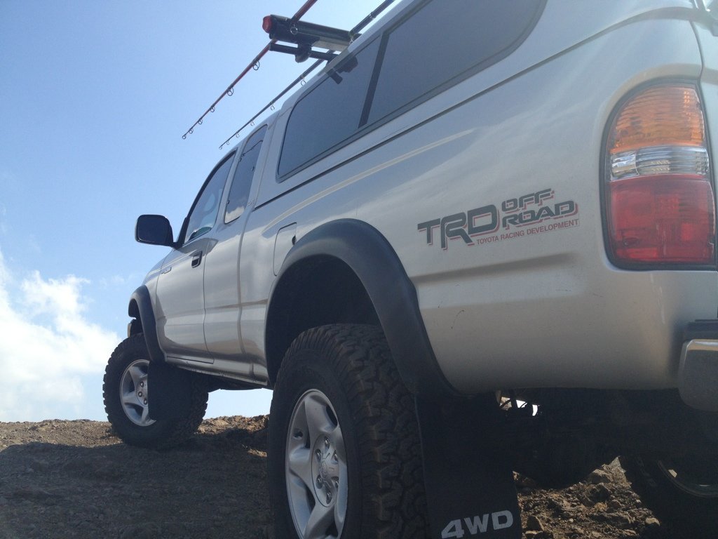

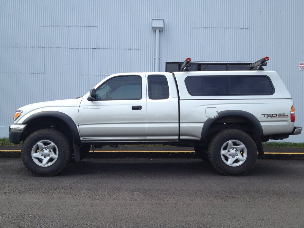

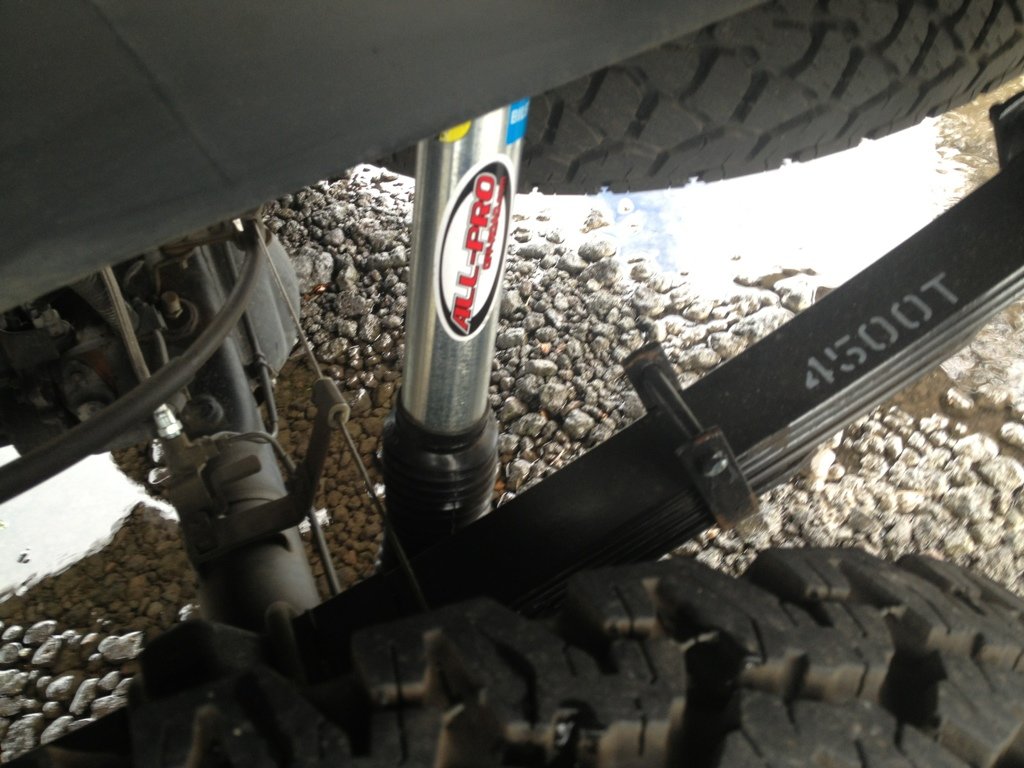

    3" AllPro Expedition leafs = over 5" lift.
    C2AED9E9-A1EE-482B-99C3-A10E418365F1-196_99c080711b92c6022169121ca746353b0207a035.jpg
    BFB3B17D-8AEF-4E84-AE68-87D41797C685-205_edb087b2d79220a94b263c03b215e67d173a3a91.jpg
    868143B9-F630-4B81-AB27-5AAA2A09C87C-205_ed5387304f744ce6ca1798236ab8ef2addd50554.jpg
    3D051C1B-8DFB-475B-8C2F-D18CC5CA12E3-230_6ca01bb3f33517fdad0faee3da3be5c37bfc136e.jpg
    592719CE-09DC-46A1-9990-C46EA2485591-230_7add1ffd786cad90657765803948d2723eec9481.jpg
    4F1FAF01-491F-4E15-A5BC-246B03FA2B8C-230_2ee44639b725b5a2bc1845b66f9f84d12d01c744.jpg

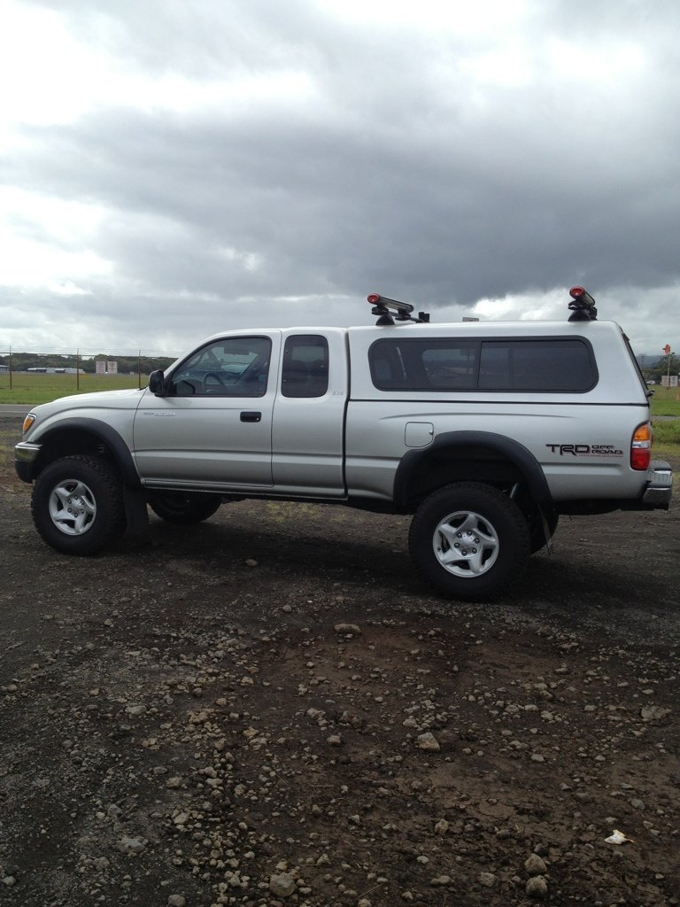

    How it sits empty...
    7A165E10-AA89-406E-B71B-B522128BA78E-246_6fdef9e78db4d9202f0490126bc01264fbe0757a.jpg

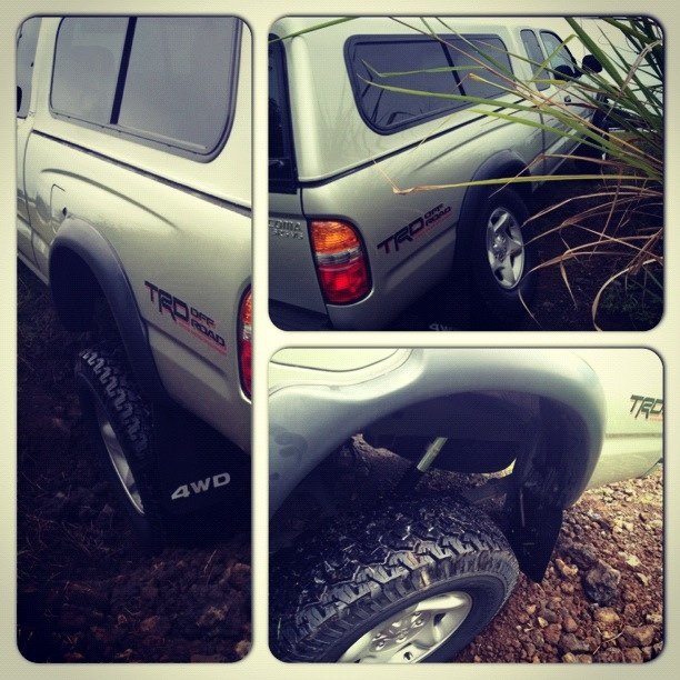

    Played in the snow...
    03E4AFDC-8354-47AC-B573-6D761245D558-460_ac96ecf1f35568257fcbc61d250f1eb9ecaad764.jpg
    ...then decided to paint the flares...

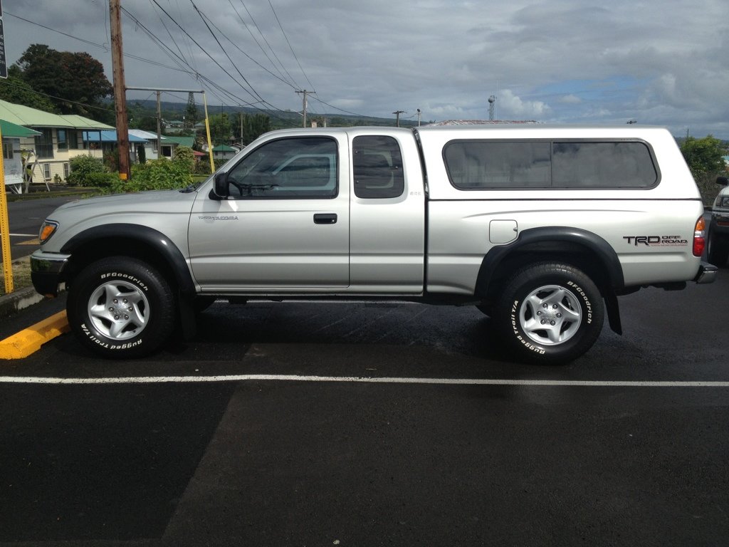

    ECA5A2B6-A817-4C83-B087-F4BF80E1CC10-105_eb408227c603ef9666da5dad30845fd73a404f2b.jpg
