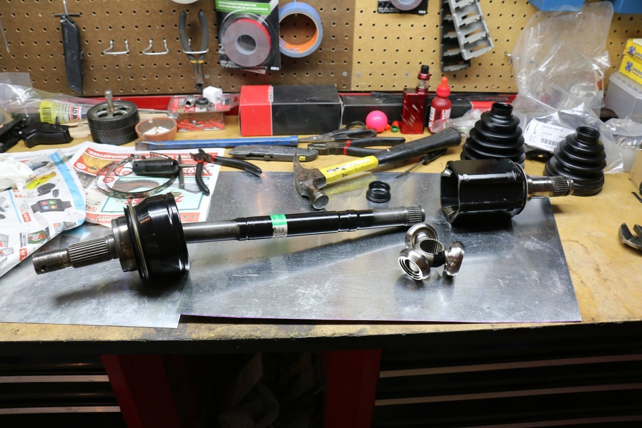

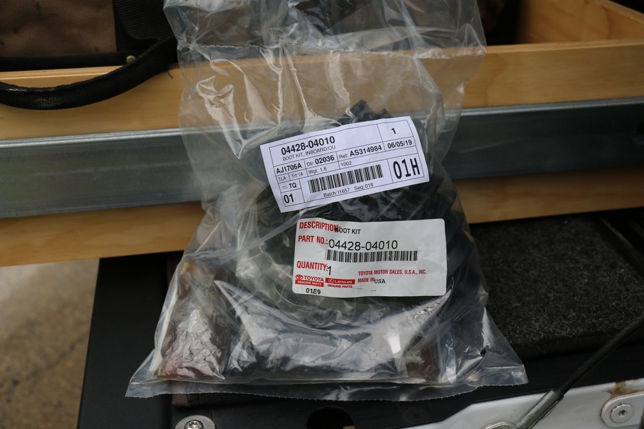

    After 100,000 miles, a hole in one of the boots, CV axle grease all over the front suspension, it was time to rebuild the CV axles. I considered just replacing them, but OEM ones are quite expensive, and aftermarket ones are of varying quality and I didn't want to take a chance. Besides, they are really easy to rebuild, and Toyota sells an all-in-one kit for less than $40.
    One kit is used for each axle shaft.
    Pull the axle out of the truck, and clean it. Yes, get all that sticky, yucky gray/black grease and gunk off, pull the old boots off, and clean some more.
    Once cleaned, this is what you end up with.
    Re-assembly is just as easy. Squeeze the bags of grease into the boots, squeeze the new clamps, and put the axles back in the truck.
    Keep an eye on the boots for a few miles, just in case one of them "burps" grease.
