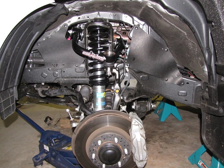

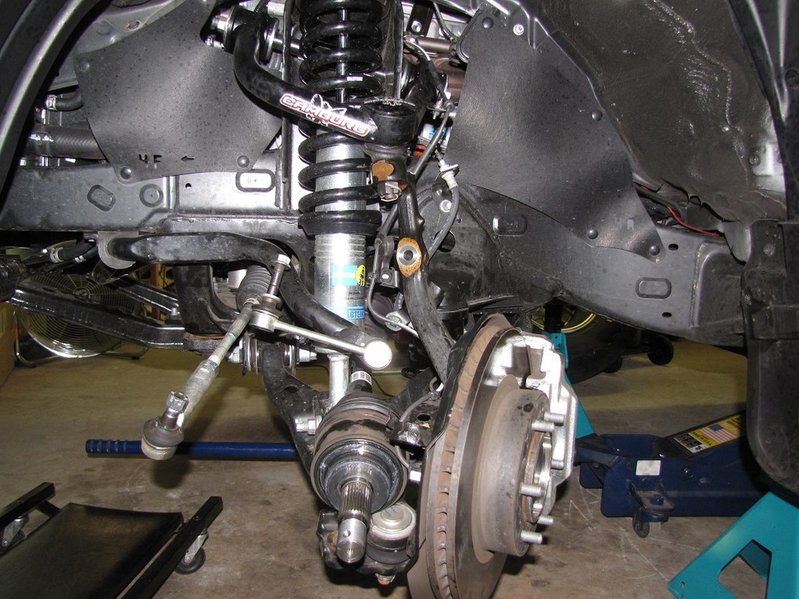

    Today was the big day! And I am pooped. Lift day!!!!!!!!
    Overall, everything went well. The process took a little longer than I planned on, but was not working fast. All in all, it came out great!

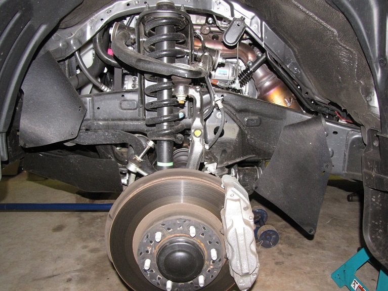

    The Front:

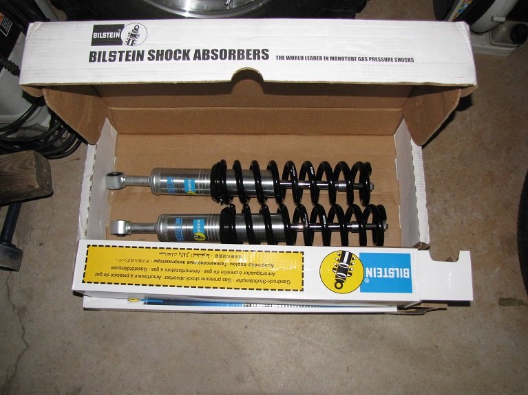

    I decided to use Bilstein 6112 coilovers. I have them at the topmost setting, which pushes the suspension down almost all the way. I'll have to see how it drives/rides, and let the springs settle - I may or may not adjust it. I also installed Camburg UCAs. I changed my mind, and used the ball joint arms. Since I live in the South, where we have rain and mud, I think the ball joint will last longer than the uniball. I will not be rockcrawling or jumping the truck, so the ball joint should be fine.
    I also installed a set of Wheeler's bumpstops. I like their progressive compression (as opposed to the factory solid ones.)

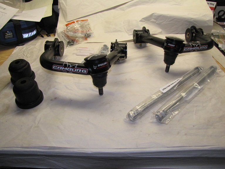

    You can see in the picture, I have replacement UCA bolts. Instead of bending the sheetmetal, I decided to cut the bolt heads off, and install replacement bolts from the other direction.

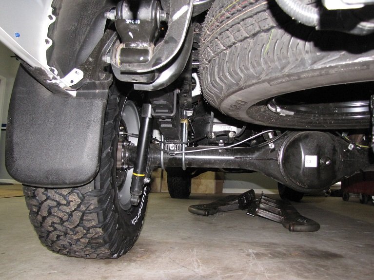

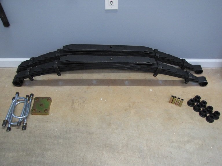

    For the rear, I had Deaver build me a custom leaf pack - 3" of lift, and carry an extra 600 lbs. While everything was apart, I also installed an All Pro U-Bolt Flip Kit. I much prefer my u-bolt ends to be above the axle.
    For shocks, I am going with Bilstein 5165 reservoir shocks. I am going to replace the upper shock mount and get the longest shock I can fit. Now that the new springs are in, I can get an accurate measurement. And yes, I need longer brake lines - way longer!
    I also have Wheeler bumpstops for the rear. I haven't decided how I am going to mount them. I am considering mounting them to the frame as opposed to the axle.
    I didn't get many pictures of the process, but here is a before and after of the front:
    Before anyone says anything, my jack stands are teal. Way back when, Snap-On was playing with different colors, and I ended up with these. They are made by Lincoln in the USA so quality is not a question. An odd color for jackstands - but I'm not a marketing person, so what do I know?????
    Here's a shot of rear after assembly. Yes, I know the shock is not attached. Fortunately, the stock shock is long enough (to fit) so I can use them (on road only) until I get the longer ones installed.

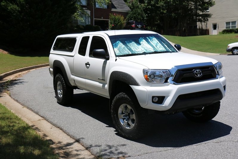

    And finally, the result:
    I like it!

    Wow, I like it too,
    Did you go 600lbs extra because of the topper and related gear?
    Nice wheels too BTW.
    Now hurry and get the rest of your front bumper covered with the fender trim stuff!!! :boink:

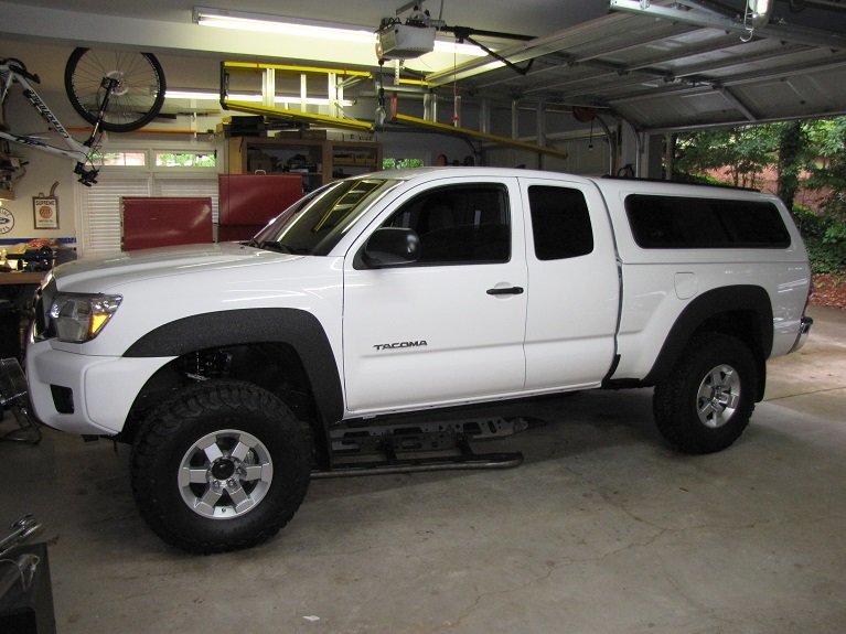

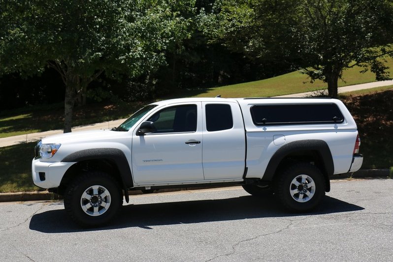

    Here a couple of shots taken after my test drive.
    It sure is nice to sit up high again!

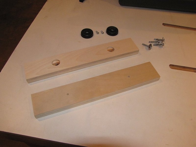

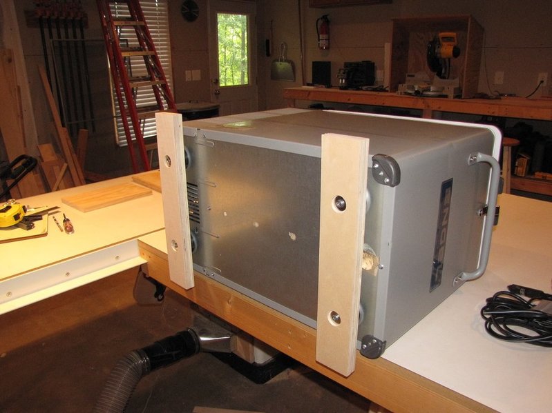

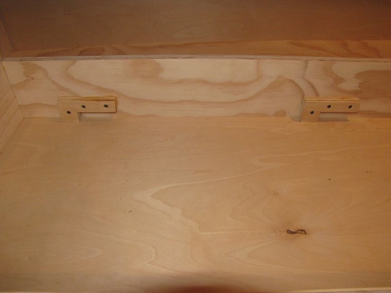

    Having a fridge while off road for a day or a week is really nice. I admit, I used to shun these things, thinking how ridiculous they were. I am a convert. No soggy food, no leaking ice chests, warm drinks turned cold (great in the desert!)
    I built the sleeping platform and drawers to accommodate a fridge, and here is my "quick release" mount.
    First, I built 2 feet/slider assemblies, one for the front and one for the rear of the fridge. The length of the sliders is just less than the inside width of a drawer.
    I attached the sliders to the fridge using longer feet mounting bolts.
    I cut 4 hold-down clamps
    and mounted them to the inside of the drawer.
    The fridge drops in the drawer, and is slid towards the rear of the truck, with the sliders engaging under the clamps.
    When the drawer is closed, the forward side of the fridge hits the sleeping platform, keeping everything locked in place.
    For power, I mounted a 12V power port to the leftmost vertical divider, just beyond the fridge.
    This setup worked really well at Parashant.

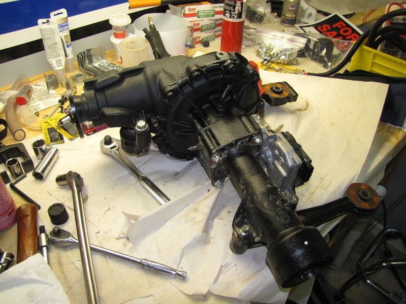

    I swapped out the front gears. I ended up ordering a clamshell from ECGS, and swapping, then sending mine to them - not what I wanted to do, but with my work schedule, it was the prudent thing to do.
    4.56 gears with an ARB. Neither Truetrac nor Torsen make a limited slip for the Tacoma, so it was really ARB or nothing. I was going to leave it open, but at the last minute I decided to get an ARB. Expensive, but I think it was the right thing to do.
    Working by myself, I didn't get to many pictures of the swap process.
    I really like the 4.56 gears with 33" tires. Pulling the trailer on and off road, the engine and trans weren't straining at all. And off road, this setup worked great!

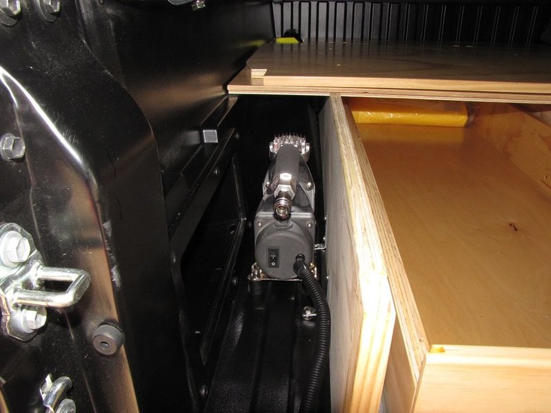

    On Board Air
    I mounted a Viair 400P compressor in a corner under the sleeping platform.

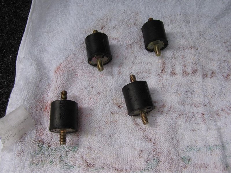

    Since compressors are loud and vibrate, I mounted it using isolator bushings (and fender washers on the bottom of the bed.)
    Leaving the rear portion of the sleeping platform removable makes it so much easier to get to things!

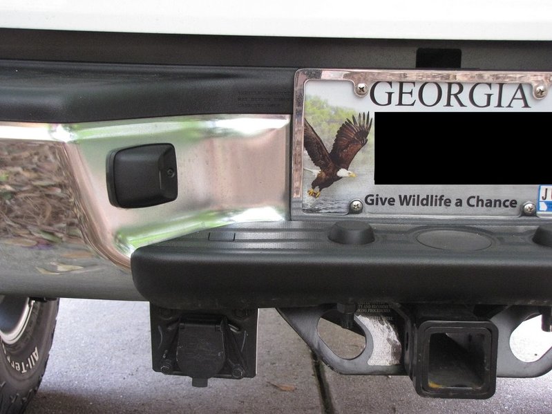

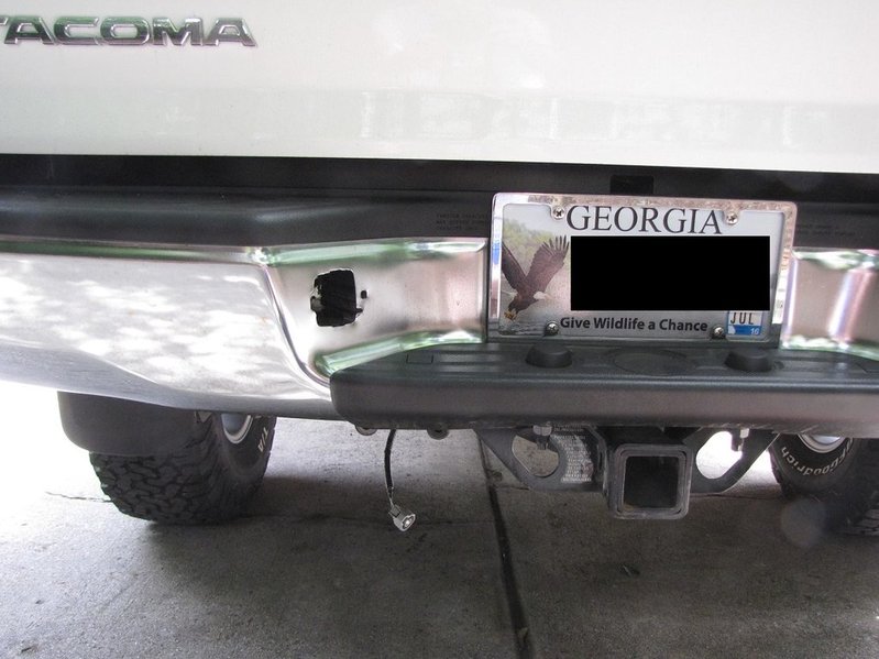

    Like most people, I did not like the way the 7-pin connector hung down below the bumper. It would be only a matter of time before it got ripped off (I already backed into a stone wall with it. :( )
    I thought the easiest and safest option would be to put it in one of the license plate light holes. Not my idea, and thanks to whomever came up with the idea - aren't forums great?!
    A simple mod - I'll let the pictures do the talking.
