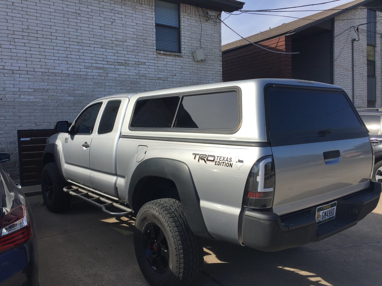

    Well I found a cap and I'm paying tomorrow. Should be installed either tomorrow or possibly Monday/Tuesday.

    Got the shell. Gotta get some racks, any recommendations from TW?
    Color is also slightly different so I'll repaint eventually.

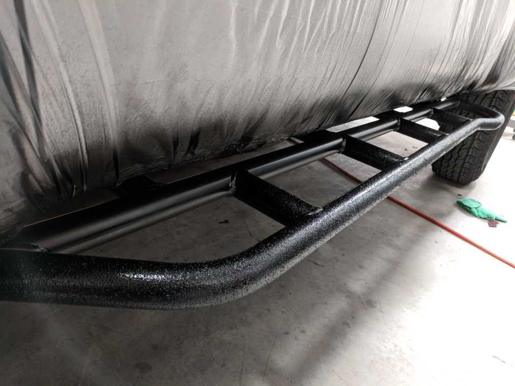

    Sliders getting painted

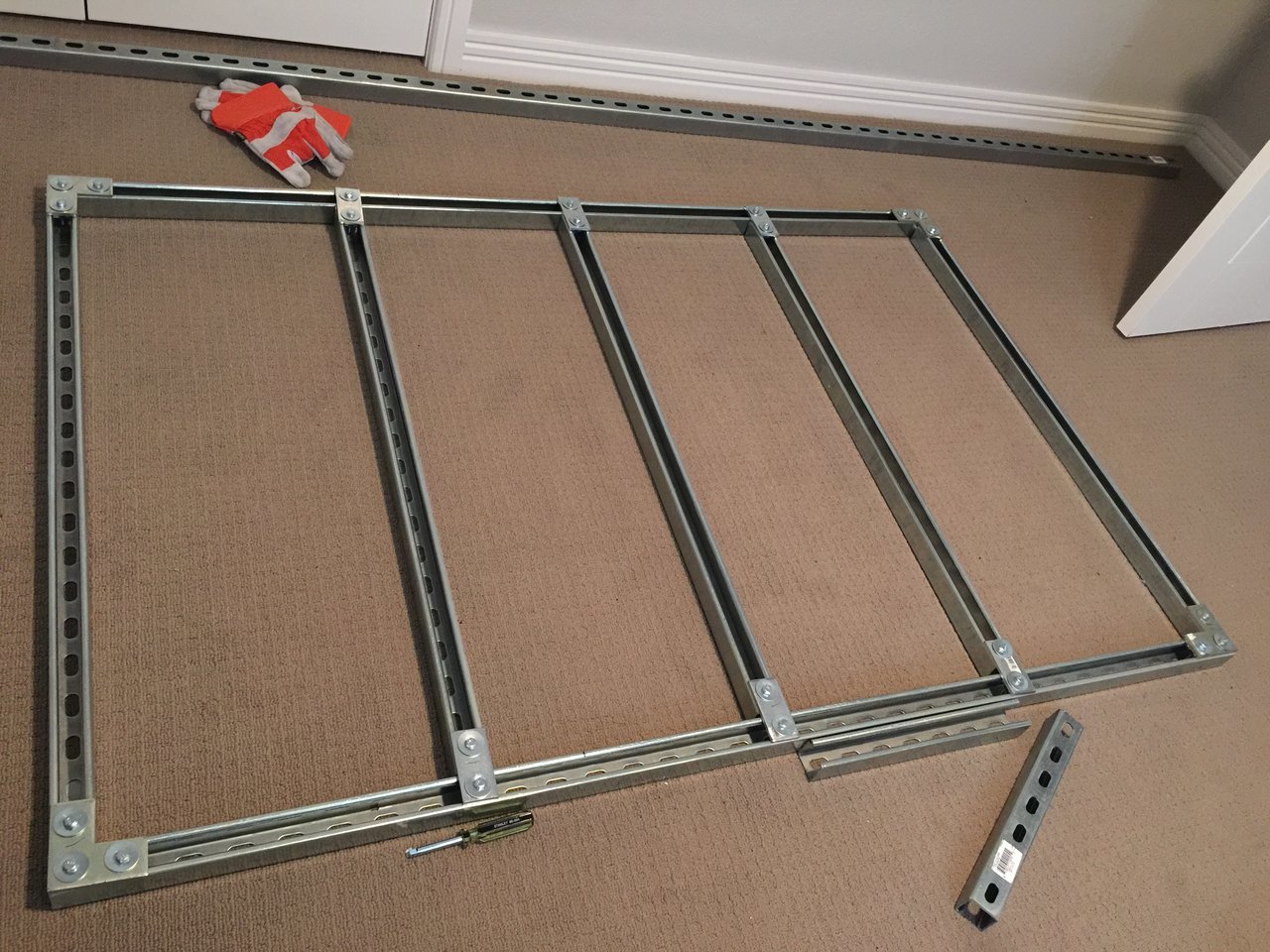

    LONG BED SHELL RACK WRITE UP:
    This post right here is a post in progress so I'll edit it when needed.
    It's a update as I go write up and sorta copy of ERMB's DIY Rack System. Instead of doing the short bed write up he did, I'll do it for a long bed because well... duh.
    Parts list:
    4 - 10 ft. 12-Gauge Silver Electro-Galvanized Slotted Strut Channel
    6 - 1/2in(refers to the hole size) flat strait brackets Galvinized
    4 - 1/2in flat corner bracket Galvinized
    5 - Bags of 1/4in Universal Cone Nut
    24 - 1/4" - 20 x 1.5" hex steel bolts.
    24 - 1/4" x 3/4' washers (Zink coated steel)
    24- 1/4" lock washers
    Measurements:
    5 cross members in total which had a measured length of 39 and 7/8 of an inch.
    2 side rails had a length of 66 inches each.
    If you want to follow what I did then just follow these simple steps:
    - Cut the pieces in the proper length as I have listed above.
    - Lay them all out, corner all the side rails and cross members to ensure a perfectly straight line.
    - Slide the cone nuts with the blue side up into the pre made channels in the strut channels.
    - Then lay the given bracket on top (depending if you're doing a corner or the middle cross members... thread in order onto the bolt: lock washer and then big washer (it's the bigger one, I'm not super technical when it comes to this kind of stuff).
    - Thread the bolt and washers into the cone nut, tighten with ratchet wrench (but not too tight otherwise you'll break the bolts into the cone nut and that is a PITA).
    - Repeat until finished and paint if desired.
    Put together here it is:
