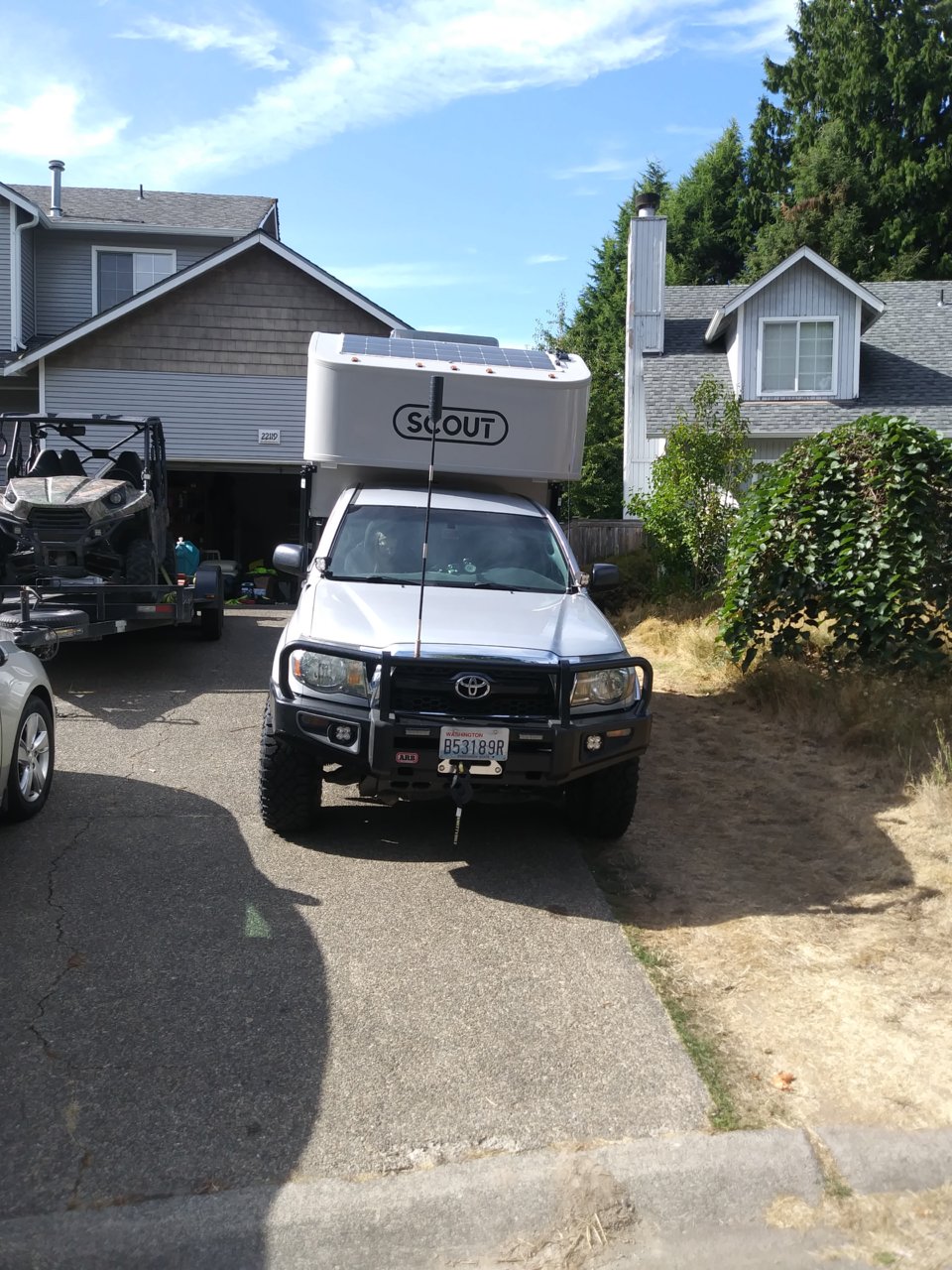

    AND WITHOUT FURTHER ADO...
    JC Heng, vtown and Tacomaroma like this.

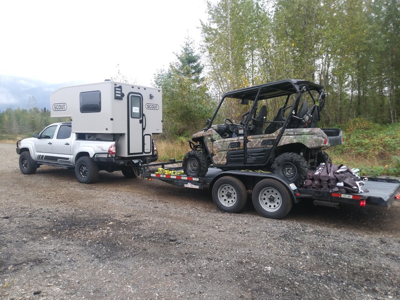

    Had my first experience towing with the Scout Yoho behind my Taco. Handled it great. Even up and over Tiger Mountain on SR18 here in WA. The 4.56s make all the difference, I'm sure. And I can't say enough about the Deaver Expedition Stage 3 leaf pack paired with Bilstein 5160s. Works amazingly well with the Scout Yoho.

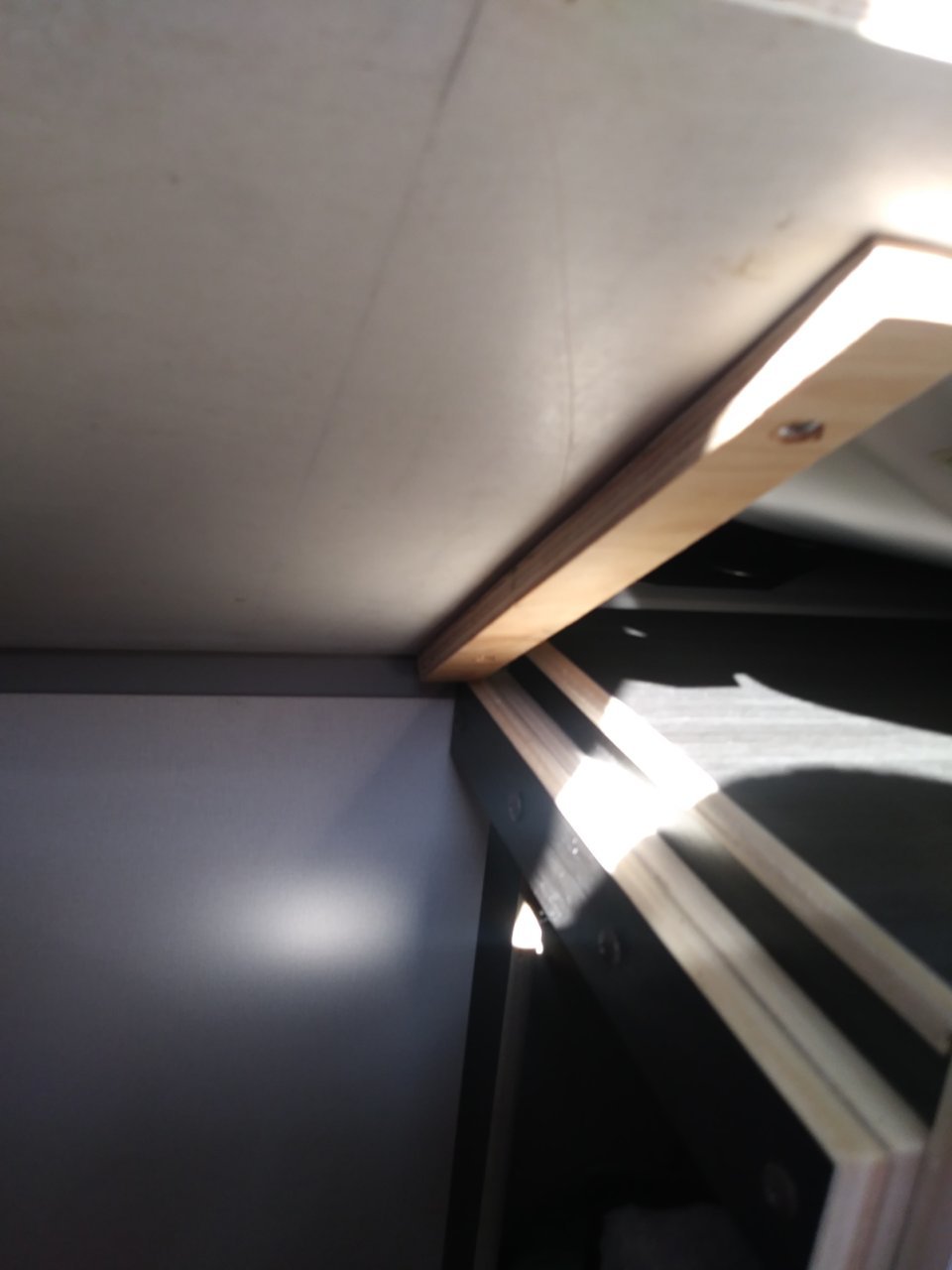

    Adding a few pics of the plywood shelf I made to support the dining area/couch. Really made the seating area much more comfortable for my wife and I on our recent trip. Far more usable space. We'll be making some sliding doors to cover the area below it to hold some trash cans and other items. Will obviously add pics of that once we get around to it!

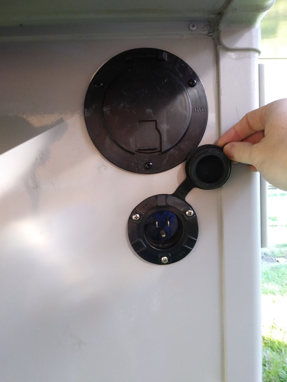

    Installed this Noco Plug Port below the Scout Yoho's cord passthrough. Was terrifying drilling through the camper (doing it on Halloween didn't help). Almost couldn't bring myself to do it.
    I've got a three port adapter I'll plug into this, then into the GZ Yeti, my fridge, and ... something else? When I'm driving, I'll plug the camper into my bed outlet of the Tacoma. I did the 400 watt anytime mod, so I can have 120 watts going into the Yeti from it's power supply, and the fridge will switch over the running off AC as well. Reminder to other Scout Camper owners, the new CFX3 series CANNOT be plugged into 12v and 110 at the same time, this could fry your fridge, and/or your entire 12v system. I have an older CFX fridge that correctly switches between 12v and 110v, defaulting to 110v when available.
