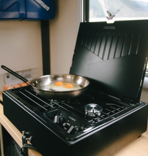

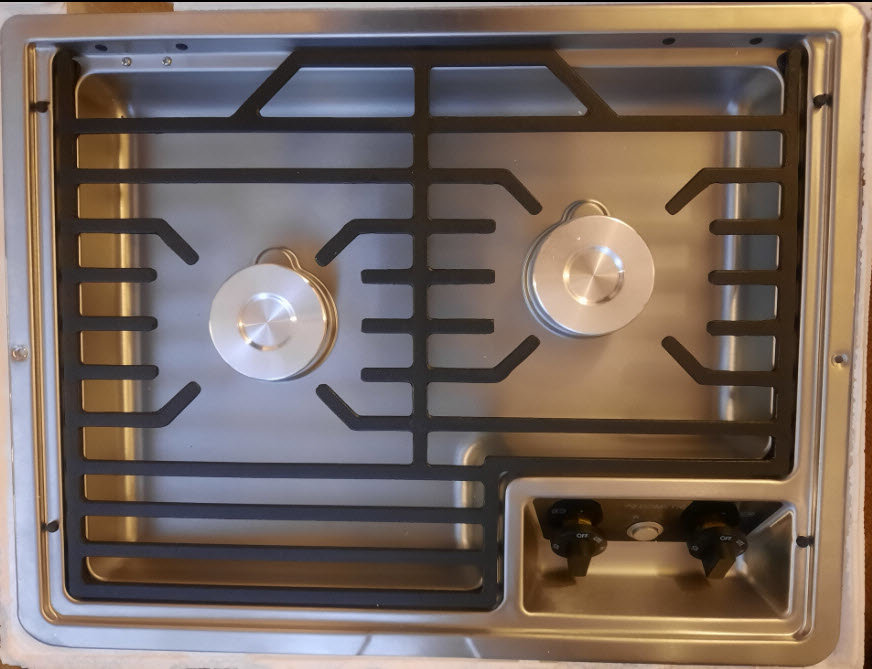

    The Scout camper has an optional cooktop (which I opted out of) that is portable and hooks into the camper's propane supply. The Olympic, and I believe the Kenai, each have a quick connect inside and outside giving the user increased flexibility on use. The Yoho only has the quick connect inside. In the image below you can see the cooktop.
    This cooktop is actually a popular Dometic drop-in cooktop that is often found in RVs, built right into a countertop. Not caring so much about portability my wife and I decided we'd prefer sinking the cooktop directly into the counter. This also gave us the flexibility to order the nicer version! They have three versions. A black cooktop with wire grate and a Piezo push button lighter. Another in stainless steel, wire grate and (I believe) a battery operated lighter. Finally, the one I ordered, stainless steel, cast iron grate, and 12v lighting.
    I ordered mine as a blemished unit from Panther RV Products out of Washougal, WA. If you look at the bottom left corner of the image below, you might be able to see the tiny crease. Doesn't bother me any, and saved us a good amount. Other than that, it came in original packaging and looks perfect. We are really excited to get it installed, and I'll obviously post pictures once we do. I figured I'll have my dad help me, as he has all the work working tools for cutting out the top of the counter. I just need to get out and find the propane attachments.
    260437245_2803321969942906_7755566871333_c08d61da6eb6e41a195911641dea2ecff20ee29b.jpg
    Also plan on using one of these lil guys with a 12v battery instead of actually trying to wire it over to the Goal Zero Yeti. I've got a couple of these from buying trailer lights that came with them to test them out in the store, lol.

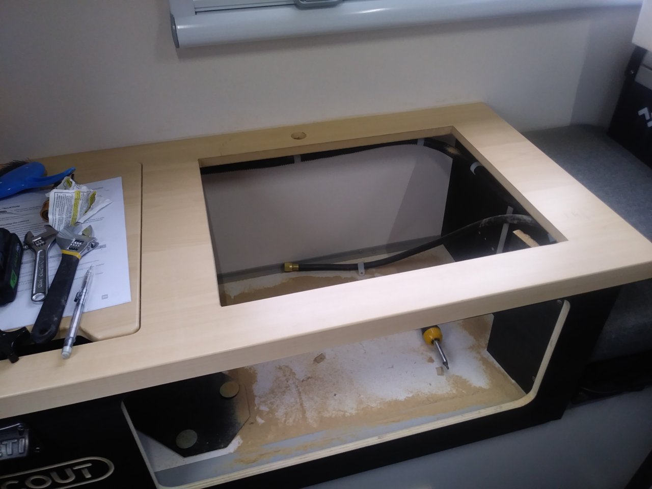

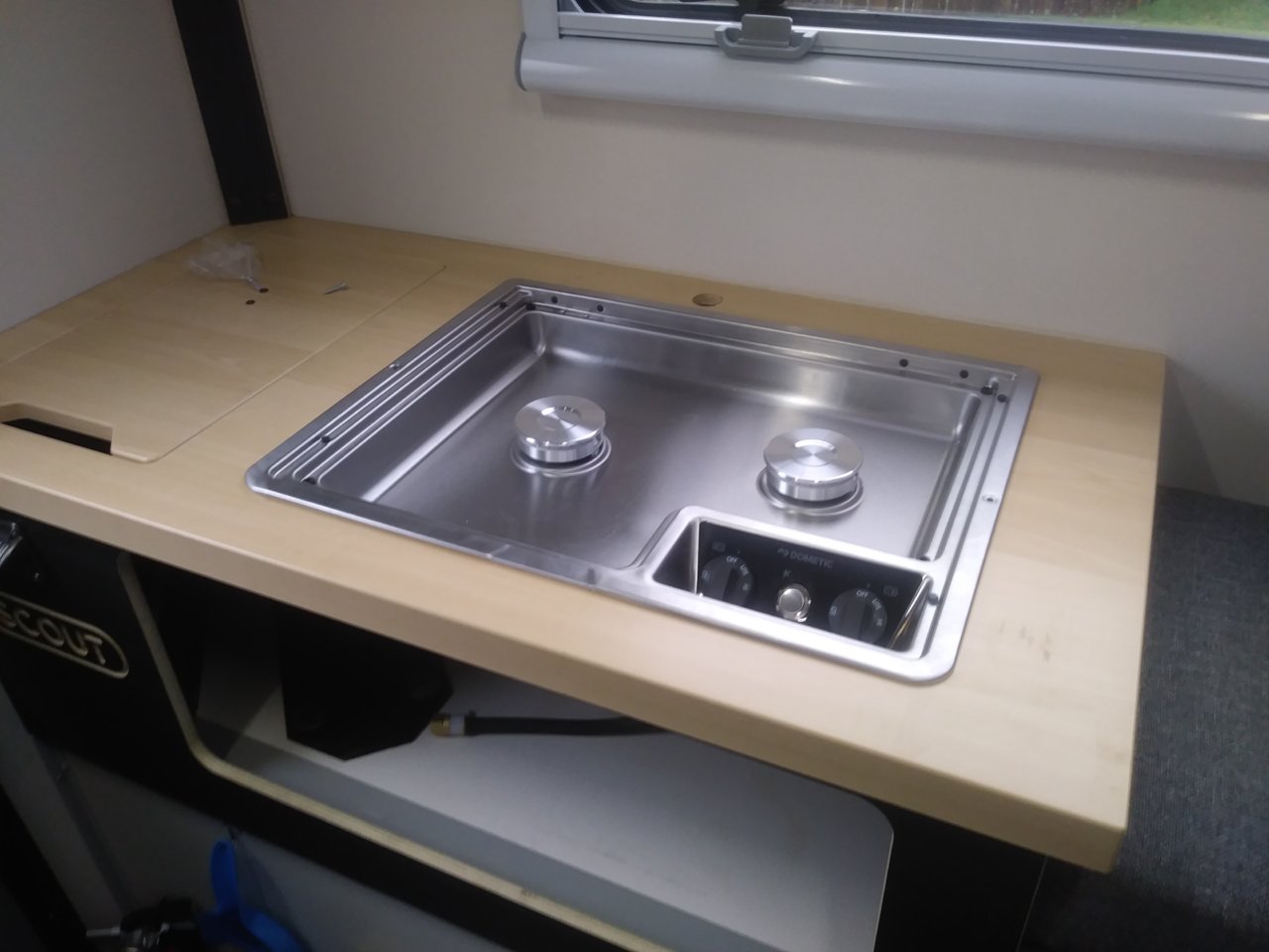

    And here is the finished product! Borrowed a nice Dewalt jigsaw off our local Buy Nothing FB group and was able to install it pretty quick.
    First thing I did was measure and re-measure, and measure again. I had pencil marks all over the top. Obviously you need to pull off the metal strap holder, and it's a good idea to turn off your propane and pull the hose down into the cabinet. You simply unscrew the elbow from the hose, pull the black liner from the tabletop hole, and the hose slides down inside. I also unscrewed a couple of the clips that the hose hangs from under the table top to make sure they were clear from the jig saw.
    The underside of the counter has a one inch border of wood support inside the plywood cabinet which is already an inch or so in from the edge. There is also the wiring running to the 7-pin connector that is under the sink, and the propane line to watch out for. In reality, this leaves only about 2 inches of left to right adjustment available in placing the stove. I also wanted it as far forward/away from the window as possible. I might have been able to move it forward another quarter inch or so, but didn't want to worry about cutting into the 1 inch support strip. This makes your placement decision pretty easy!
    With the elbow off the hose, the hose is the perfect length to attach onto the elbow already installed from the factory on the back of the stove. Runs straight across and connects like it was designed to be this way. Tighten it on with a crescent wrench and it's good. Once it's set in place, you pre drill two holes, one on each side of the stovetop, and then place the included screw in each side and you're done. Well, i might be adding a bead of caulk around the stove, but not sure yet. Couldn't be happier with how this came out. Figure I'll find a big plastic cutting board soon to place over the top of the stove, maybe with some feet that will fit into the stove top to keep it from sliding off when I'm bouncing around on bad roads. We'll see.
    Here's an image underneath, so you can see it doesn't hang down very far. It looks crooked, cause it is, lol. The shield underneath has two screws into the bottom of the burners, then just 3 or 4 zip ties holding it up. That's how it came and that's fine with me. And finally, you can't see it, but I used a command strip to hold the battery against the wall directly to the back of the stove. Makes it really easy to reach in and change it when I need to.
