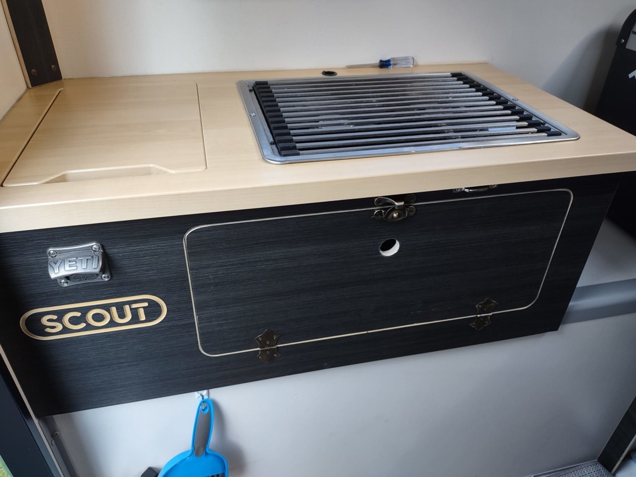

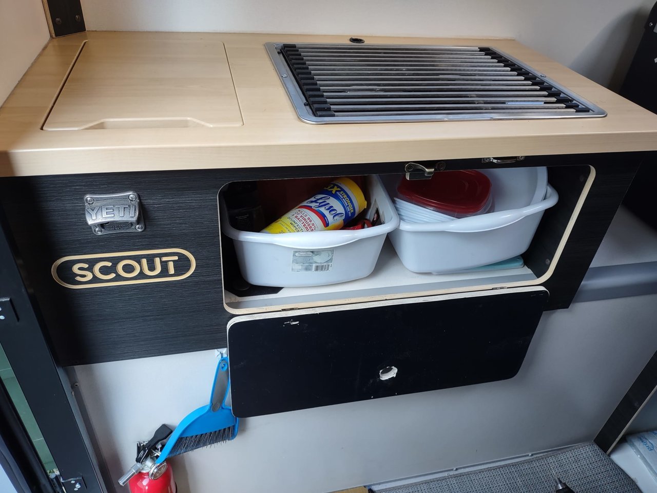

    Latest mod to the Yoho. Added a door to the kitchen cabinet. Lucky for me, a friend gutted his Kenai and let me have all the wood from the cabinets. My woodworking skills are far from perfect, but we are happy with it!
    352296409_633859355004211_69716588512230_7eaa84c771f5cb42d337e8dd9d3b25624aec50cf.jpg
    350805517_622947676211256_16216491396142_a2055fbb16c8ccb5b2c88b59ed5b4daa5bea0cf8.jpg

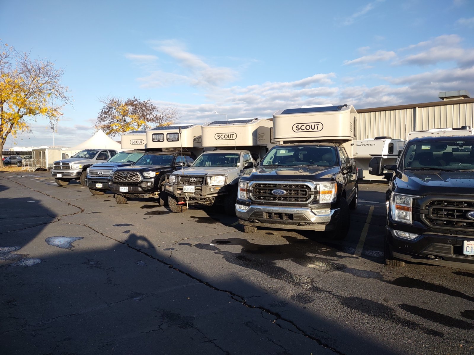

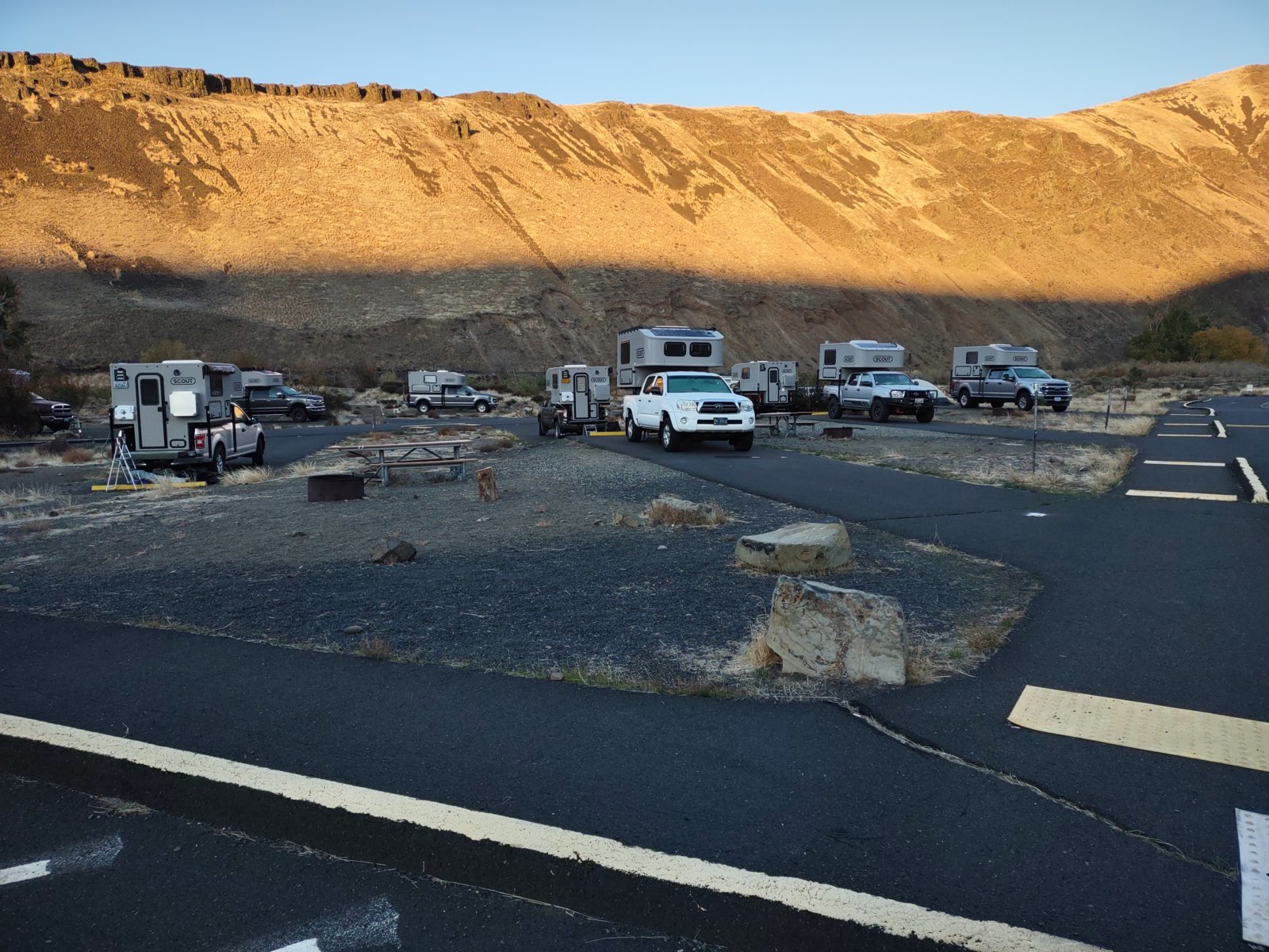

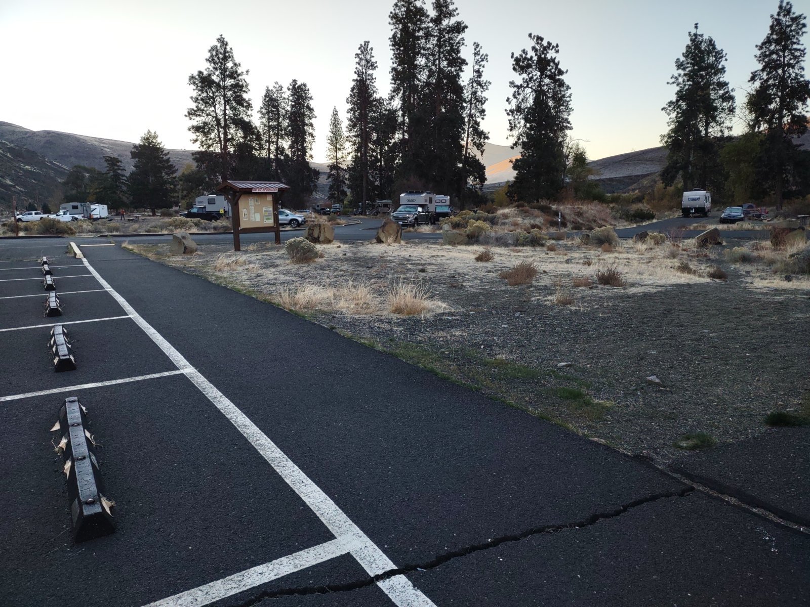

    Scout (adventurer manufacturing) put on a great open house this weekend. Some 35 Scout campers all in one place. Was really cool to see them all, and meet the owners. The open house had breakfast lunch and dinner provided, plus a campout at the end of the day. Factory tour was a lot of fun, seeing how these things are built. They even had our campers in for maintenance, recalls, and updates while there. They put in a new propane hose for me and installed their anti condensation tape that is now a standard feature. They really went above and beyond! They also did a Q and A session to get our likes and dislikes and what we want to see next.
    IMG_20231027_085818614.jpg IMG_20231028_081512296.jpg IMG_20231028_081448081.jpg

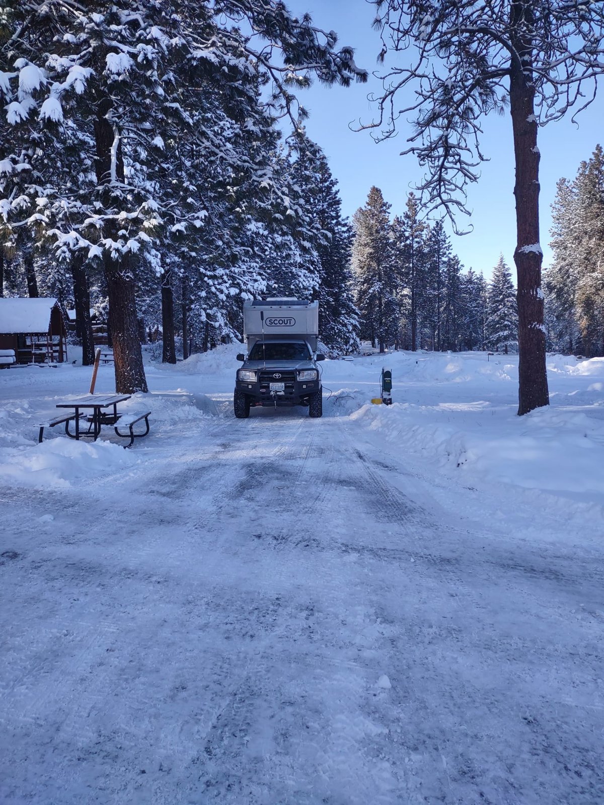

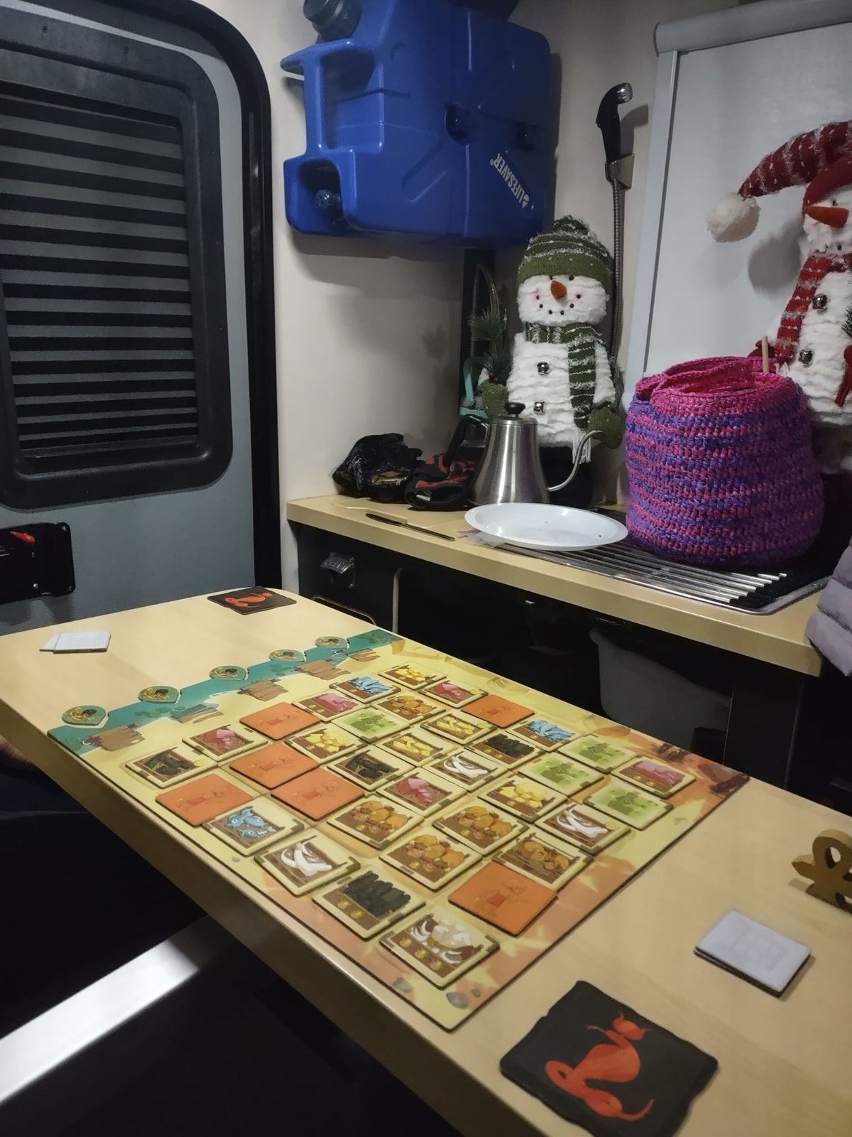

    Our trip this weekend to Leavenworth, WA saw temps down around -15F. Colder than anything I've ever experienced before by like 25 degrees or more. We had electric hookups and ran a 1500w space heater that kept the thermometer above the door reading about 75 degrees. The cabover was consistently 15-20 degrees cooler.
    419025073_10113922892289148_237409531724_7e04e6cd76df509222a2d7e5eb23c02e4ee80e8d.jpg
    418821370_10113922892329068_330444400666_d362f371e39070666b81021e891d30c00ef6092e.jpg

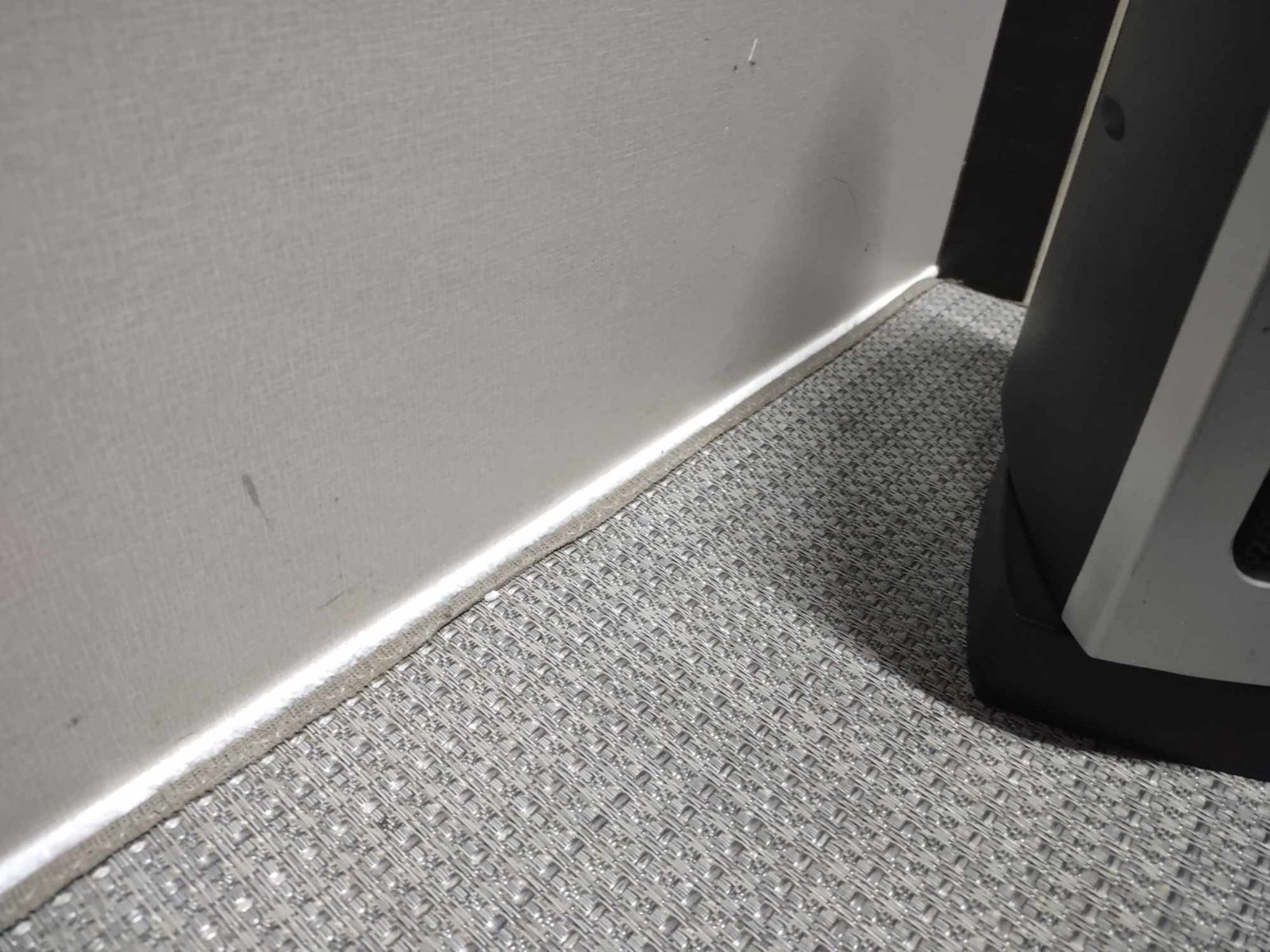

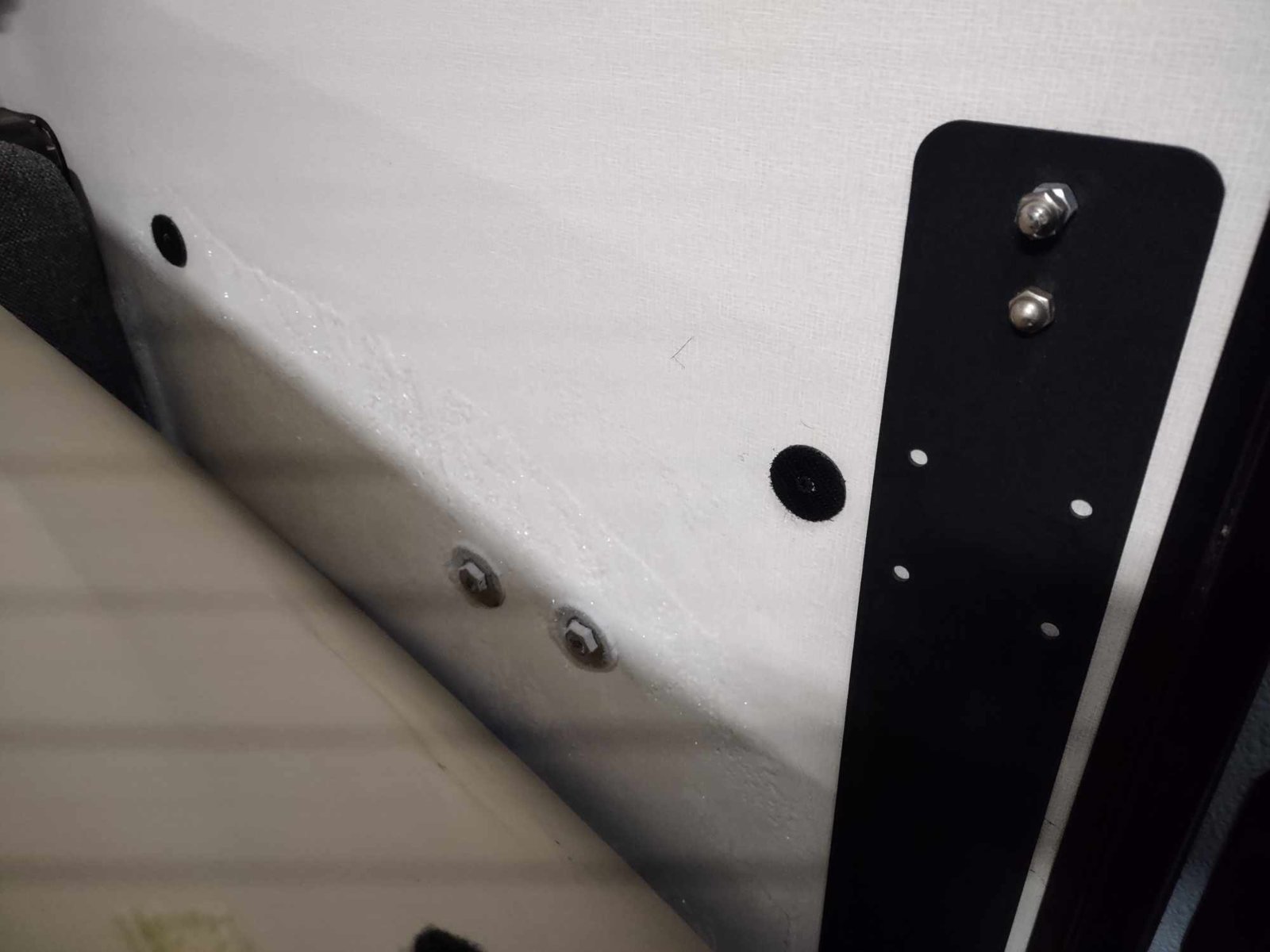

    Thermal bridging definitely occurs along the metal extrusions.
    419132289_905876510812004_33811803776668_59899c4cb2a757522c54fc334103c96be376d3b8.jpg
    My bolts holding my extra propane tank to the rear wall made a serious thermal bridge to the interior, but the couch cushion was still comfy to lean against. I sat there for hours perfectly comfortable.
    419683784_2683921881759537_5702864342775_c9fddaea5a220b7febd8fff329f9b99de0aaca8a.jpg
    White line is ice along the extrusion holding the floor and walls together. Adding a foam pad from Harbor Freight below the Scout's rug made a big difference in keeping our feet warm on the floor. We try to never use our shoes in the camper beyond our welcome mat, so we were in our socks without cold feet. Obviously it helped that the space heater is right there in front of the toilet storage compartment. That's what you see on the right edge of this image.

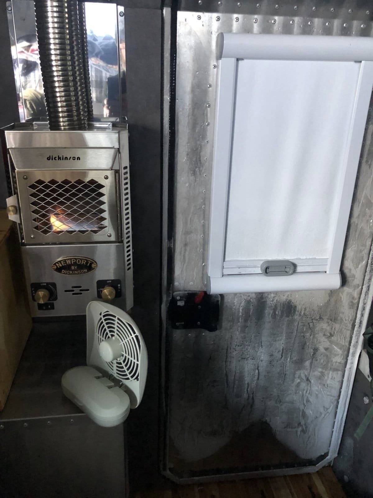

    Found this pic recently in the Kimbo camper thread here on TW. Their metal door gets it even worse than the Scout by the looks of it. I'm assuming the fan pointing at the door handle is to keep it from freezing. I've heard of it happening with the Scout, too, but haven't experienced it myself. Hopefully I don't, lol.
    414664794_10113893257018468_200724040894_a038e0f525b5e3b644c280099ba9b7f560016a3c.jpg
