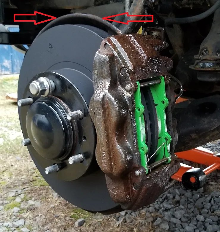

  10. Dec 11, 2021 at 6:23 PM
    EatSleepTacos
    Mar 24, 2015
    #151688
    59,842
    Randy
    West Valley, AZ
    2017 4Runner
    That'll be an easy time to fix it then. I apologize if you already know what we're talking about, but in case you don't, this is what we're referencing. It's a thin metal shield directly behind the rotor.
    tcjacado likes this.

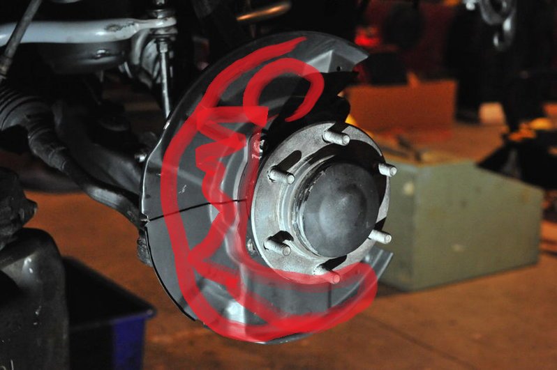

  12. Dec 11, 2021 at 6:28 PM
    EatSleepTacos
    Mar 24, 2015
    #151688
    59,842
    Randy
    West Valley, AZ
    2017 4Runner
    If you're going to remove it, I would fully remove it, which requires taking the hub and bearing assembly off. I would just bend it back and call it good. It's this whole piece in red so it's not something you can easily cut off. Pictured below is what you would see if you took off the caliper and rotor.
    edit: no, they're not required for the brakes to function. I removed mine because offroad going through muddy water, shit would get trapped between the shield and rotor and cause annoying noises.
