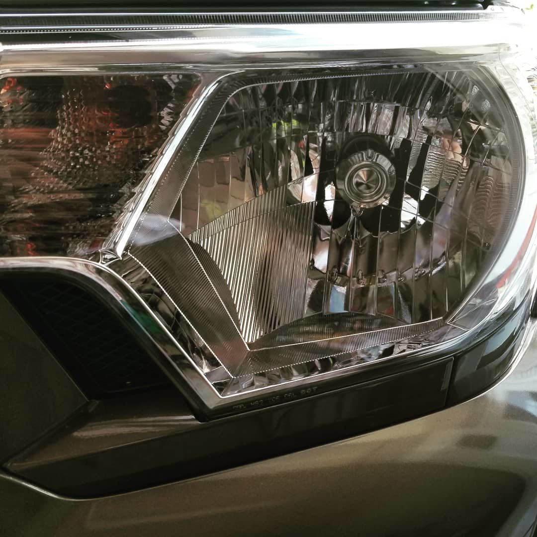

    When I first bought my truck, it took me a little bit of adjusting from my civic to get used to driving a pickup. The hood scoop didn't help either! I managed to "bump" my neighbors car, and luckily there was no damage to him, but I managed to scratch the outer casing of my headlight!
    Aside from buying a new headlight assembly, what can I do to remove this scratch? I thought perhaps sanding with a fine grit and then clear coating the lense could clean it up! Any advice would be appreciated!

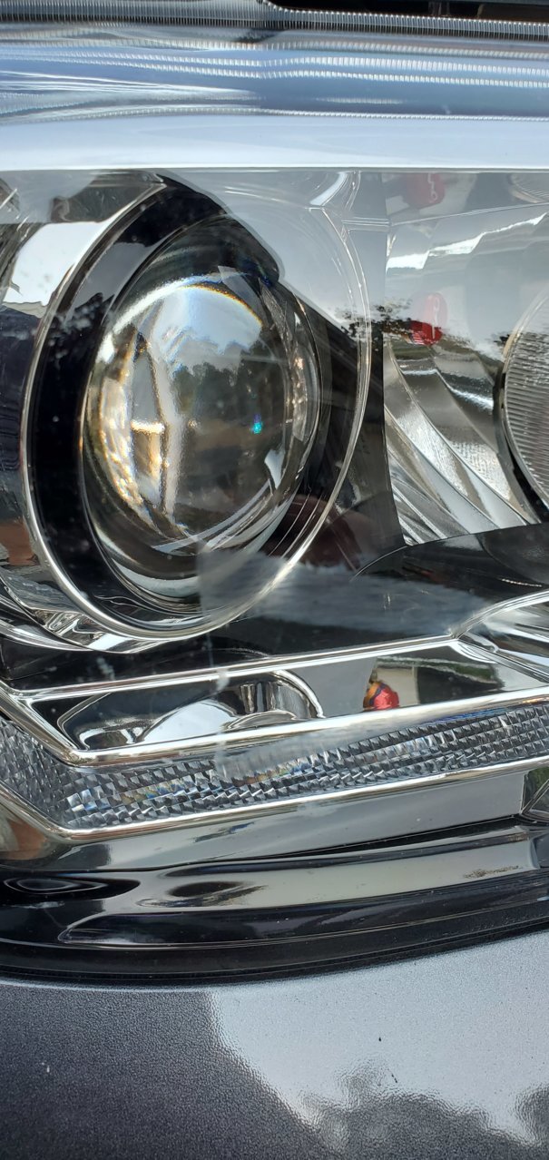

    OP, from the looks of it, polisher + some rubbing compound and that's gone with very little effort.
    Just did the headlights of my '14 Camry with Turtle wax 'clean cut' compound and the softest of the three wheels in this kit on a cordless drill, and they came out like a champ. Probably a minute and a half per headlight.

    Correct I had worse than that on mine. Used the Wolfgang Headlight System on it, and it was brand new again. Then I put 3m pro clear bra over them.
