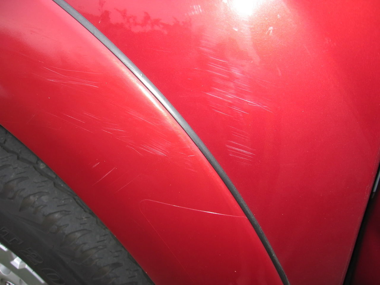

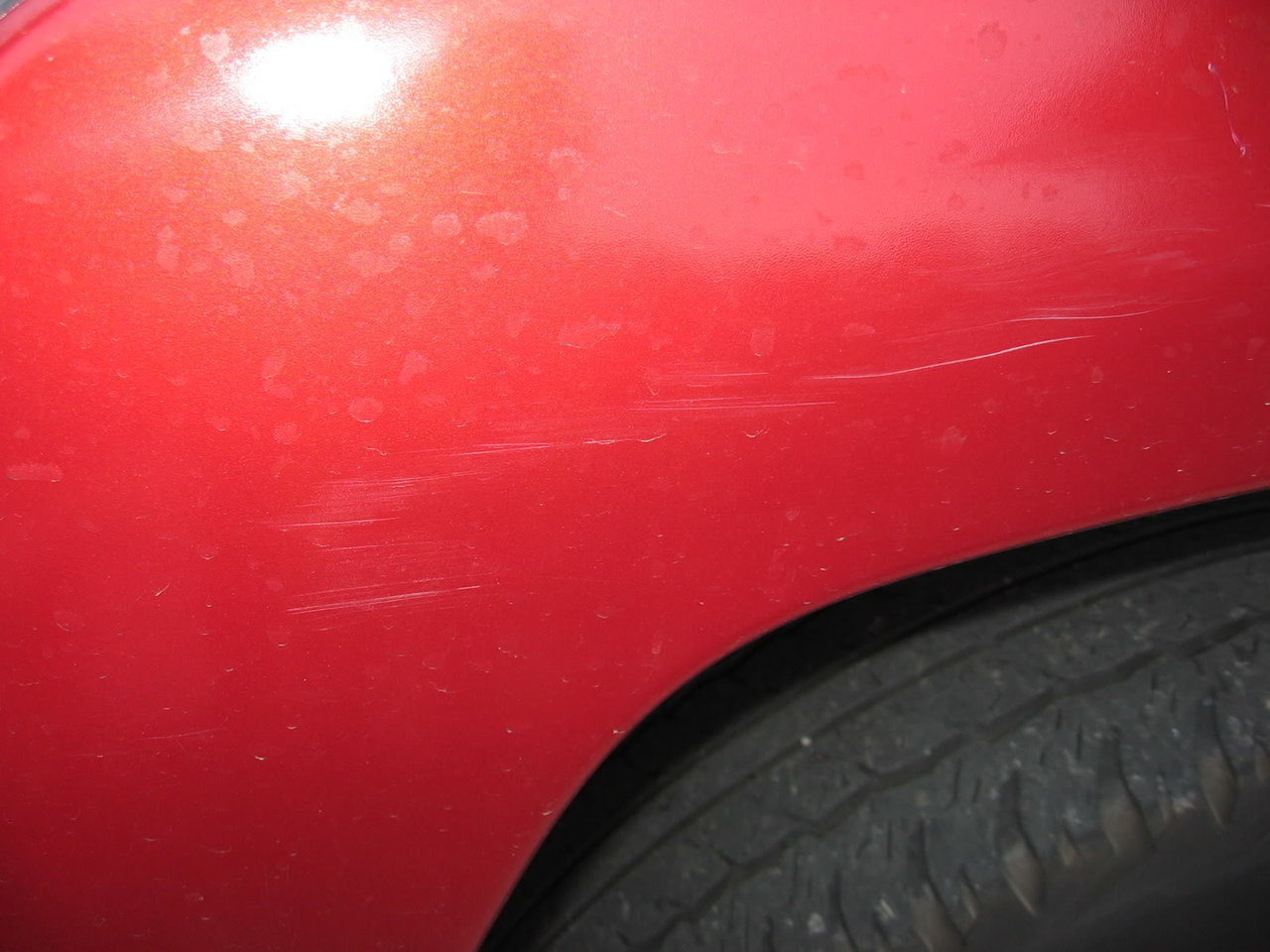

    Some jacko sideswiped my truck (my wife doesn't know where exactly) and has some pretty decent scratches along the whole side. I've had the truck almost 2 months and I'm really ticked off. I can't believe much people suck and have no appreciation for things. At least there aren't any dents (I'm really trying to look at the positive, but man it's hard).
    Any ideas how to get this out?
    Rear fender:
    Front fender:

    I think I would take it and have it detailed by a pro. They won't get out 100 % of the scratches but I bet they will get out more than you or I would get out. They might be able to advise your next step or you may decide it's not so bad and just live with it. Sorry about your truck. Weren't to hard on wifey were you?

    as long as its only a scratch to the clear coat you can buff it out, maybe further on down the road add another clear coat to that layer so its not so thin.

    That scratch isn't bad at all. A porter cable buffer will take it right out for sure.

    It looks like somebody dragged a duffle bag, a huge @ss purse, or those new "green" grocery reuse bags against the whole side of your truck...
    As Kenny said, a porter cable will take it out or pay a detailer.

    Generally, if you slide your fingernail perpendicular to the scratch and it catches, the scratch won't come out. If it doesn't catch, you have a good chance of it coming out.
    If the white I'm seeing is a scuff or paint from whatever scratched it, you're in good shape. If that is primer, you're hosed.
    It looks like you have a lot of oxidation/water stains on that paint so you'll have to do the whole area (or whole vehicle) or you will have one section that looks like new. :D

    As for the water spots, it got oversprayed by my sprinkler system that morning. I was going to wash it this weekend but that's not going to happen now.

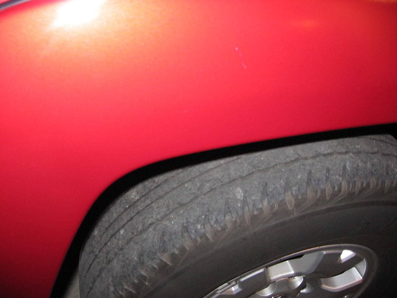

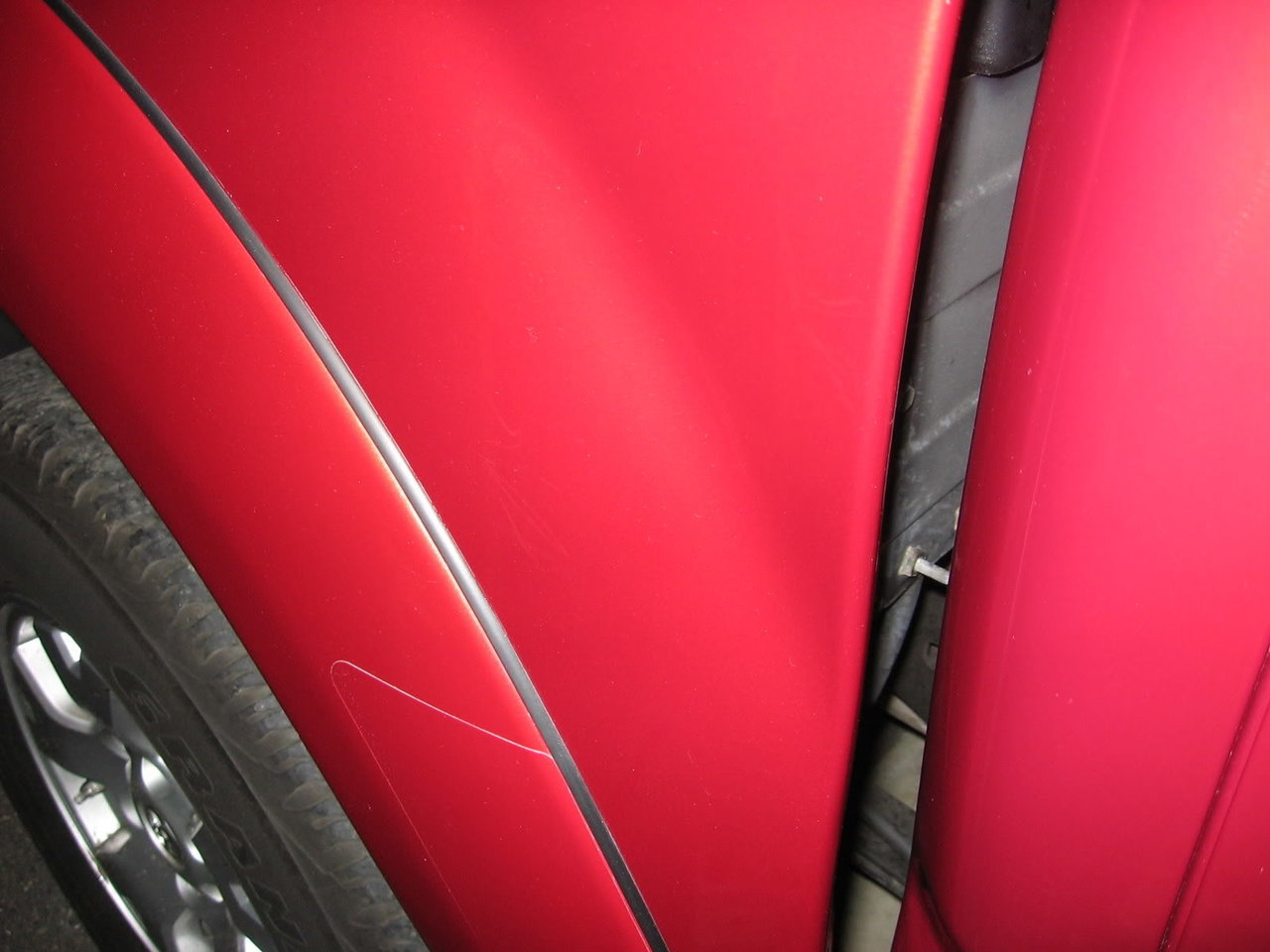

    Here are pictures I took after I had it repaired by my local detailing shop.
    Rear fender after:
    Front fender after:

    That looks great :thumbsup:
    Well worth the $$ spent

    Detail shop did a great job, now have another Sam Adams!
