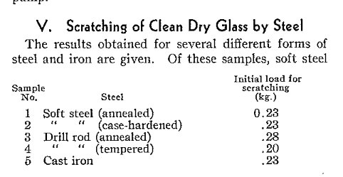

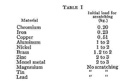

    upload_2023-4-5_14-34-21.jpgupload_2023-4-5_14-34-50.jpg These metals will all scratch glass...depending on force.

    Must've been all them diamonds and chromium drill bits in my pockets that put that half inch scratch on my cell phone screen, definitely wasn't my keys...
    lol
    I'm not even a science hater at all, I got my degree in physics, but some people take results from controlled experiments way too far. 3kg can be achieved by a child (that's for the soft metals in hiPSI's list). These experiments are designed to empirically derive a relationship in otherwise complex interactions. Hardness scales are not laws of nature!
