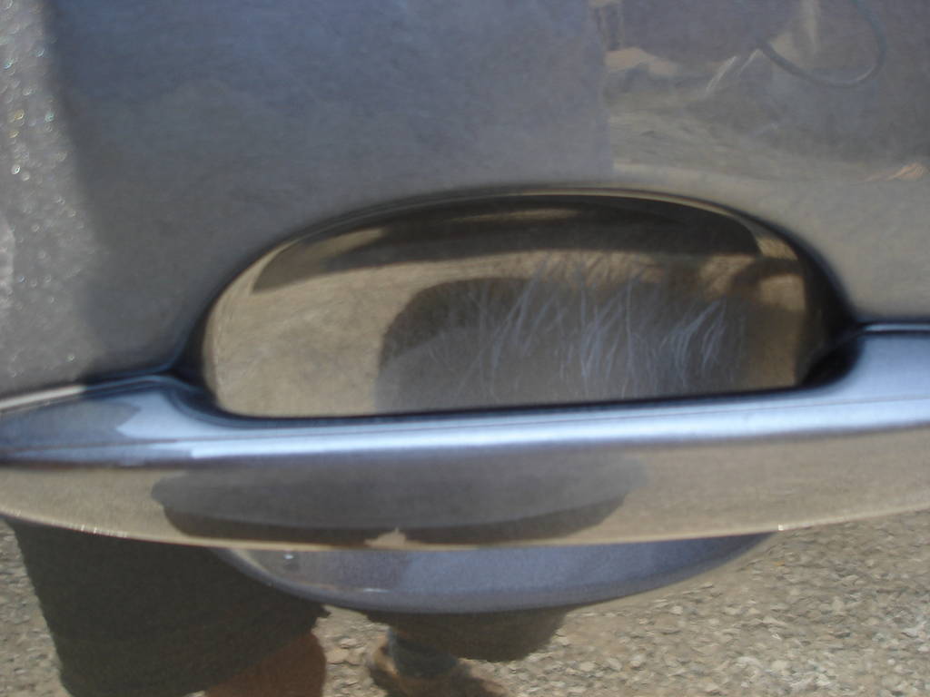

    I have black scuff looking marks under my door handle on the drivers side and i tried to rub them off but they are not coming off. Its under the handle so it is kind of hard to get to. I have a few scratches on my truck that I took care of, but these black scuff looking marks under my door handle are driving me crazy (comes with being OCD about how clean my vehicle needs to be/look) and I was wondering if anyone else has that issue and if anyone knows how to get rid of them.

    Added pictures to the first post.

    Your finger nails don't have to be long to cause that.. I can't think of anything else that can cause that type of damage.
    Here's a write-up on how to repair it and prevent this from happening in the future..
    http://www.xr-underground.com/forum/showthread.php?t=22734

    our paint and clear is really soft.

    Some mild polish, a microfiber cloth and a little elbow grease will take care of that. Wax it when you'e done.

    Yes I used to have the same problem, I got rid of them by using "Once a year" wax they sell it at walmart or autozone, just rub a little and get under the handle with the applicator. Next, DO NOT DIG YOUR NAILS UNDERNEATH THE HANDLE it doesn't matter if you are a dude or a chick this will start scratching the clear coat and dirt is going to build up over time... solution just pull from the handle. Dueces.

    My gloves that I need to wear in the winter do this much more than my nails do! It's very soft behind the handles. :(

    Could be from a gold ring?? Go with the least abrasive to start with, a compound is too aggressive to start with, try Mothers cleaner/wax, cheap and very good. If that doesnt work then go to Meguiars compound, its gentle enough to not do too much extra scratching to the paint. If you go that route, make sure you wax it after the compound.

    It's from fingernails , even short ones .

    You bought you truck used, right? Maybe it's from the previous owner?
    Use a power ball to polish the scratches out and then use 3M clearbra door handle cups for further protection.
