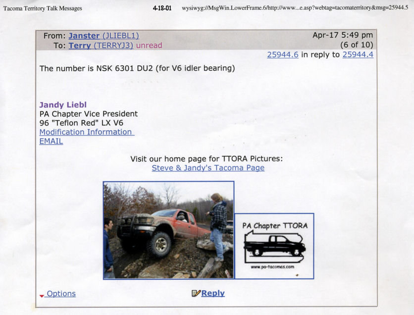

    Last year I paid just over $5 for my bearing. Got it at a motorcycle shop. Pressed the old one out using a short socket and a hammer. Then cleaned the inside of the pulley using some sandpaper and a bit of steel wool. Pressed the new one in using a small bit of oil and a 4" vice. Can't recall the part number offhand.

    AC idler bearing number, from an "older" post.
