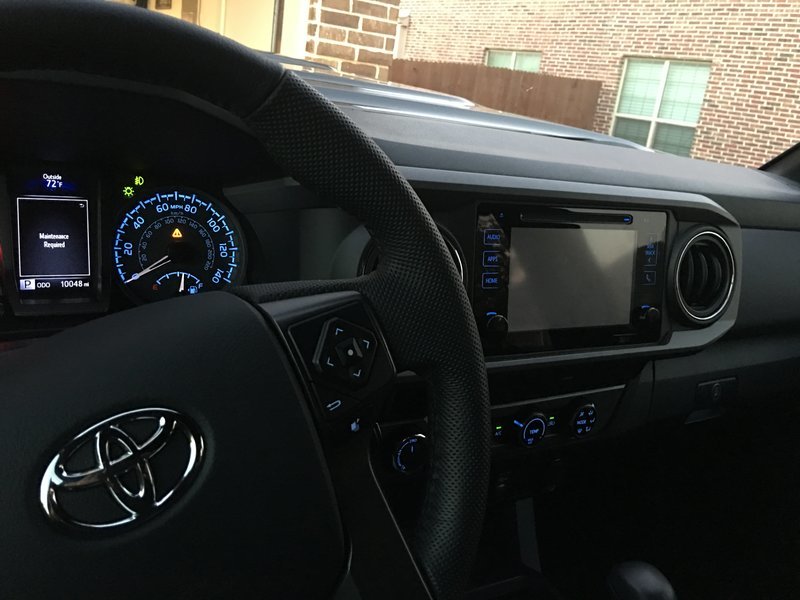

    2016 Taco trd sport , Anyone experiencing the display screen going black after coming out of reverse and the use of the backup camera? Happened 2 times today, just rolled 10k miles. Thanks

    Yup. I posted on this a little while back. Magically fixed itself after a week or so. One person thought it might be related to the service warning. Not sure if yours popped up for your 10K service.

    Here's a photo

    I've been dealing with this for a week now. Narrowed it down to the following sequence: start up / service warning coming on / then reversing / then shifting to drive.
    Was doing it to me on my way to work but not on my way home. Then I realized I reverse out of the garage in the mornings but I don't reverse on my way home from work out of the parking lot.

    Reset your maintenance required alarm and see if it goes away.

    Yes that's exactly what happens. It stops as soon as you touch the screen. Service visit coming up. I'll update with what I find out.

    So I cleared the personal set reminders for service and it stopped doing it.

    I just had the same experience this weekend. It was due to a maintenance reminder. Once cleared, the issue went away.

    Update, had to replace the radio unit. System started just rebooting while in navigation mode. Fingers crossed this time.
