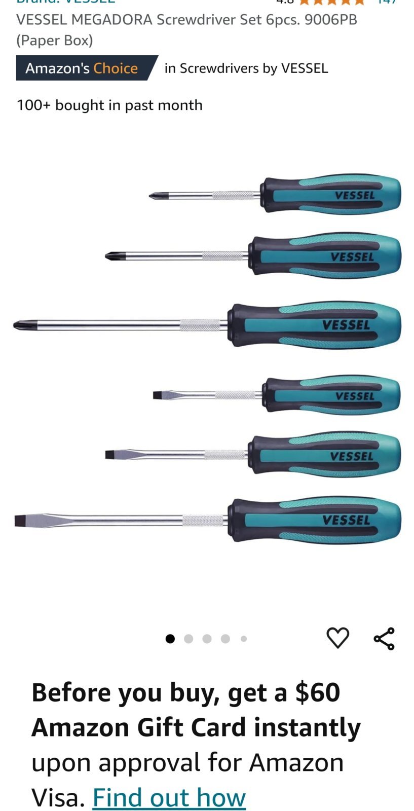

    Screenshot_20240815_230034_Chrome.jpg Vessel Brand, J.I.S. screw driver set. Trust me. Well worth the cost if you are doing any work on Japanese type vehicles.

    Use JIS, do not use Phillips. Simple as.

    JIS drivers will keep you out of trouble.

    Japanese vehicles do not use Phillips head screws. They use JIS (Japanese Industrial Standard) There is a difference, ask an old motorcycle mechanic that stripped the heads out of Japanese bike screws over the years. :anonymous:
