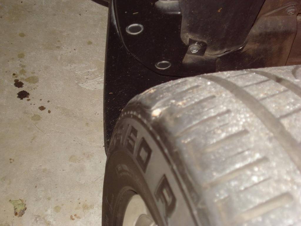

    I was on my way into work the other day as I was rolling through the gate. This guy Marcus looked down at my right front tire and asked if I knew I had a screw in the tire. Well, no I didn't! The next day, I took it to Tire Kingdom. The dude took it back and after about 5 minutes walked back up front and said he can't patch my tire. He said the screw was in the sidewall. Sidewall? Really? He could have a new tire there in 2 hours and that would be $308 with mounting thrown in for free! I knew my tires were expensive but 308? He said that the tire is still holding air so I kindly declined having it replaced. So, my question is, How necessary is replacing that tire? I know that you should replace in pairs so I'm looking at over $600. Is this dangerous driving this way? I drive over 80 mph on the Interstate. I'd hate to have a blowout.

    hey there--since the screw is not in the sidewall of the tire I would plug the tire and "drive on".U can buy a plug kit at any auto parts store or wal-mart.Get the plug kit with the T-Handle grips .u will have a much easier time.Hope this helps-Wes.

    for $600 you could have a whole new set of tires..id get that plugged/replaced ASAP.
    A screw that close to the sidewall is a blowout waiting to happen. You dont know if that screw is curved inside or not and rubbing on the inside of the tire.

    Yeah...You need to do something. I'm not sure I'd be comfortable with a patch right there. 600 bones sucks- but it's better than a blowout and accident or anything.
    Be careful what ever you do man!!

    A tire shop is not going to plug that to close to the side wall

    Missleman, It looks like your tread is about gone (from the pics). I would go the new tire route. That screw is in a bad spot.

    At the VERY least, swap it with a rear tire. Blowouts on the rear are not as FATAL as blowouts in the front. No point in verifying the impact ratings for your Taco!

    do not plug!!!!!!
    slow down!!!!
    find a dealer that will match internet price!!!!(free alignment,balance etc.)
    buy tires and have piece of mind!!!!!
    don't get ripped off!!!!!

    yep, no patch will survive in that spot. Way too much deflection going on that near the sidewall. Suck it up and get some new hoops for your wheels. Safety is never compromised for cost.
