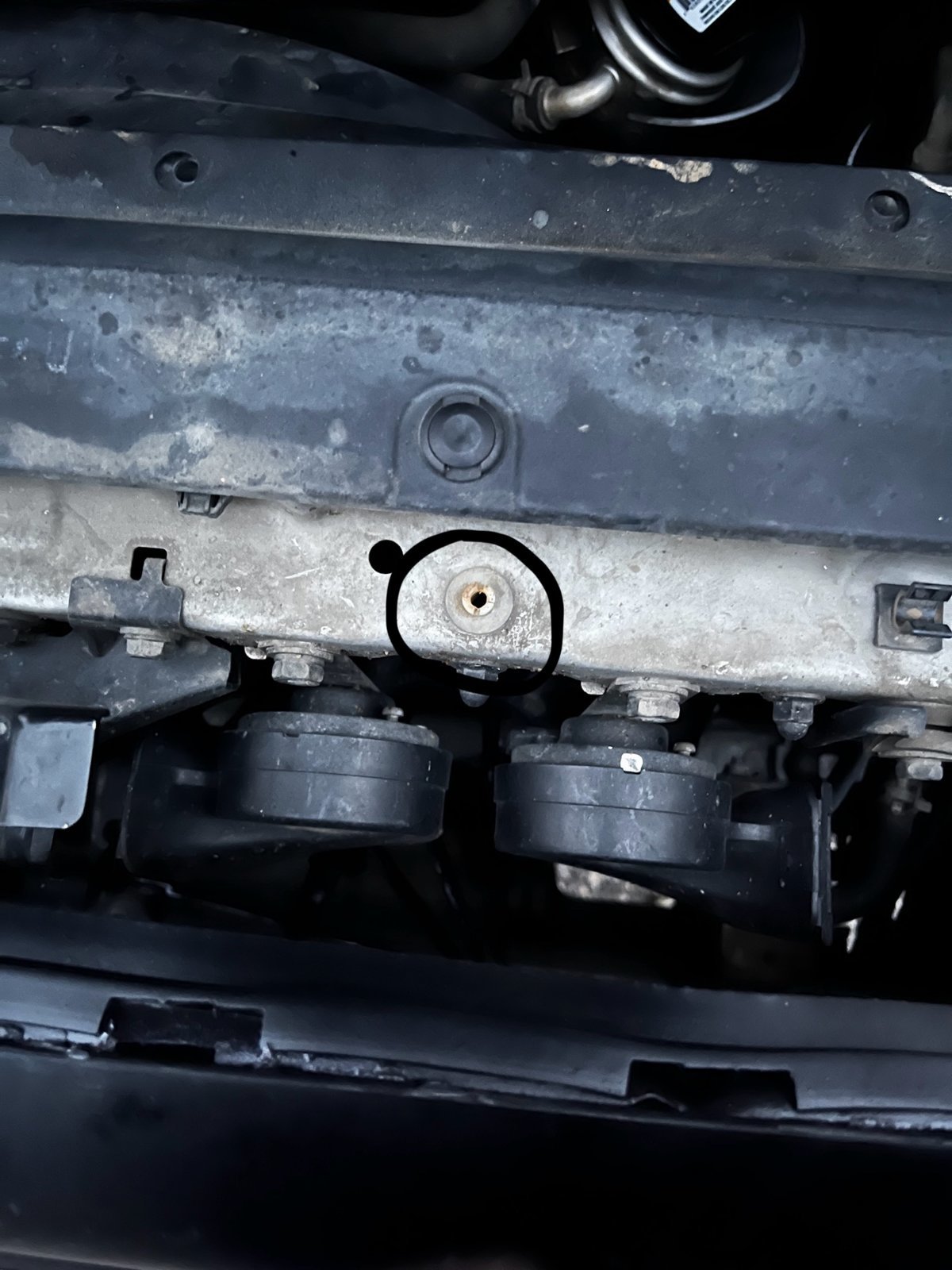

    I just but on a new grill on my 2007 tacoma. I missed placed the screw that connect the girl to the car, I will include a picture. Dose anyone know the screw size for it?

    5mm diameter, abt 19.5mm long, 10mm hex+cross head.

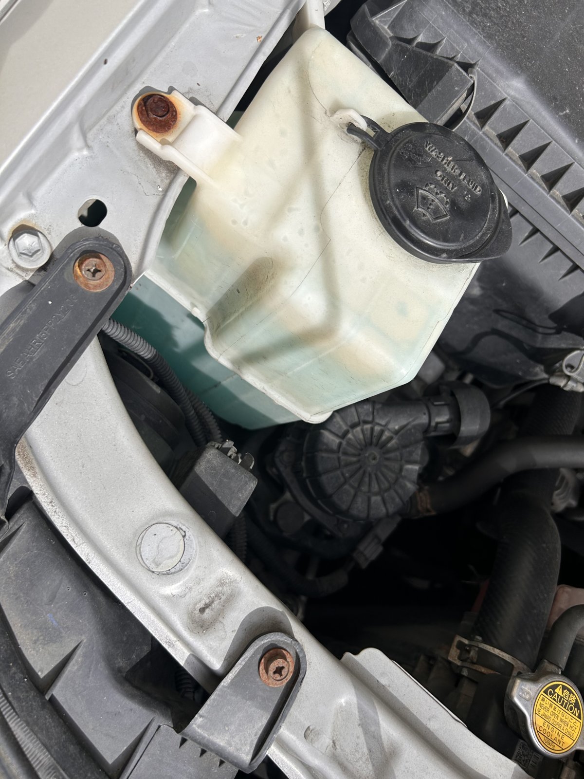

    ...And with a washer.
    There should be six of them across the front of your truck, all identical (90159-A0029). Two on each headlamp and two on the grille. Compare any replacement to the five you (hopefully) still have.
