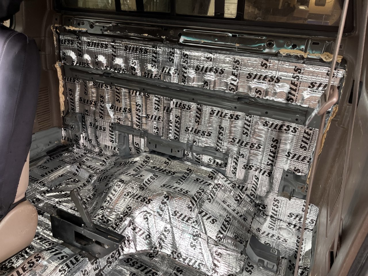

    Short term goals for this build are to make it a more comfortable place to be for hours at a time - sound deadening, piecing the interior back together, better seats, isolating rattles and modernizing the stereo are at the top of the list. As far as performance mods, clearancing the fenders is at the top of that list as all four corners rub at significant compression, and on my off road test drive the front rubbed hard enough to lock the steering wheel. Exterior/appearance mods will be mostly focused on repairing what is already there (the tailgate is bent, there's a significant dent below the RR taillight, the canopy window frame and glass are missing), changing the front end (I'm leaning towards a 2001-2004 front end with the Taco Vinyl "Pro" grille) and wrapping the truck in charcoal gray. Convenience mods will include some sort of build in the bed (leaning towards a 2 tier bed slide with a frame to support the canopy, then adding a RTT on some stronger load bars), an awning (I have an Overland Pros 270* on my Jeep and love it) and re-working the tire carrier to have a lower center of gravity and eliminate the fuel can mount in favor of a modular mount that will attach to the hub portion of the tire carrier.

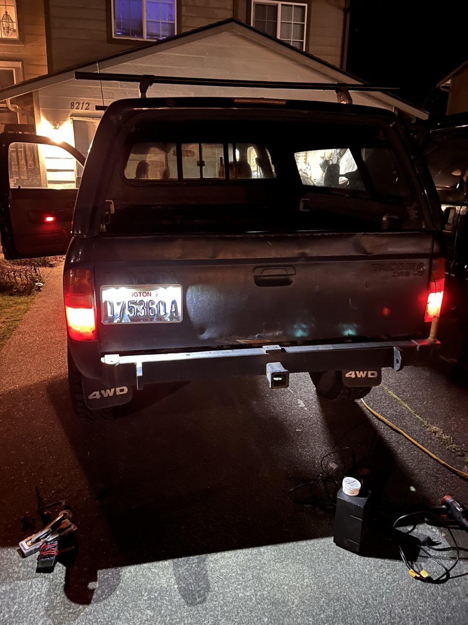

    One of the first projects I tackled was putting license plates on. That shouldn't be a project, but the license plate had been relocated to the tailgate and the lighted mounts were non-functional. 4 hours down the rabbit hole of repairing chafed wiring in the taillight and trailer harness as well as tapping into the original license plate light to wire up the new lighted mounts got me back to what it was supposed to be when I bought it. IMG_5037.jpg IMG_5038.jpg

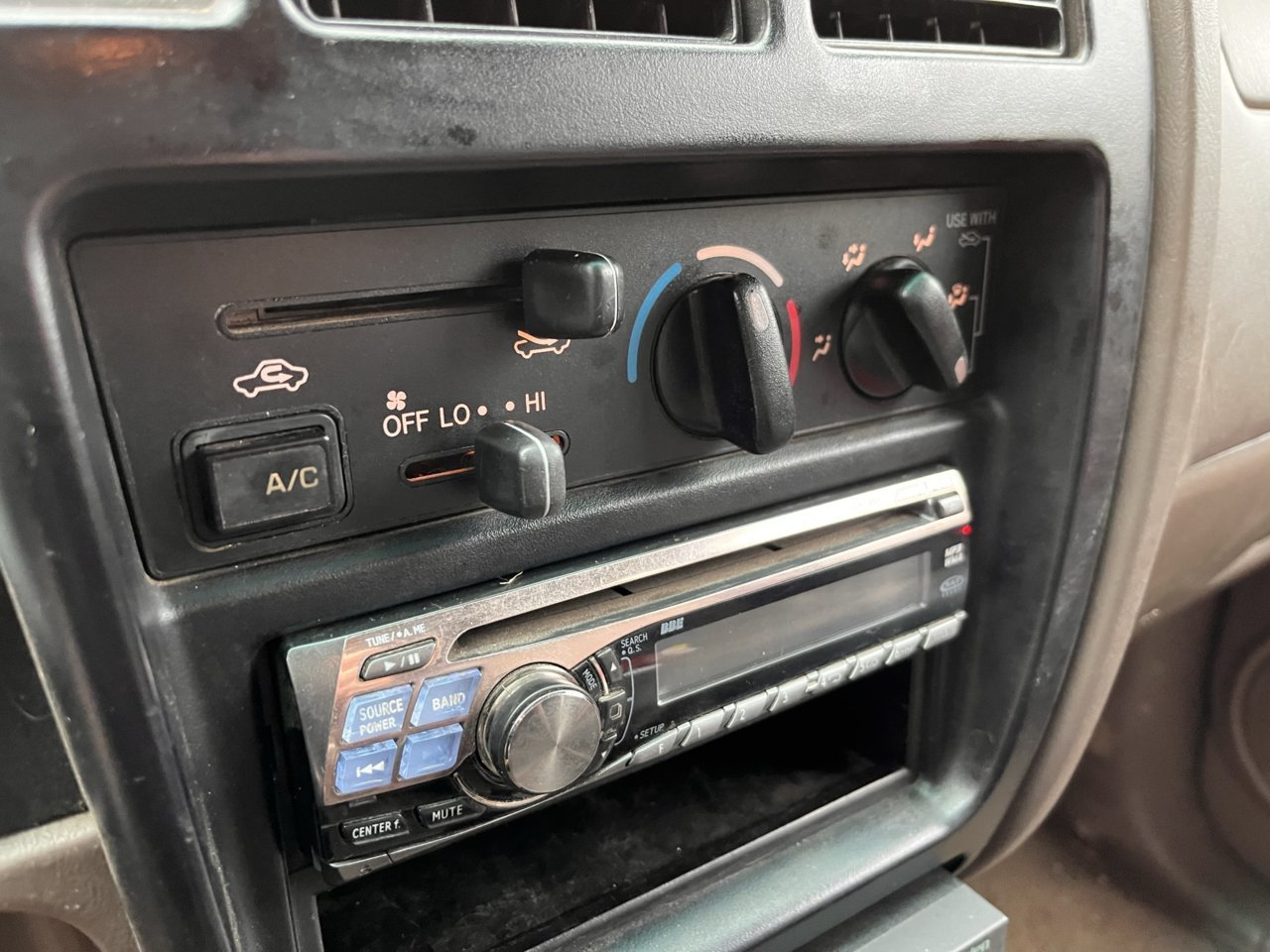

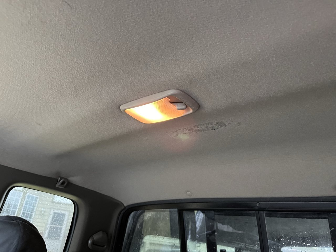

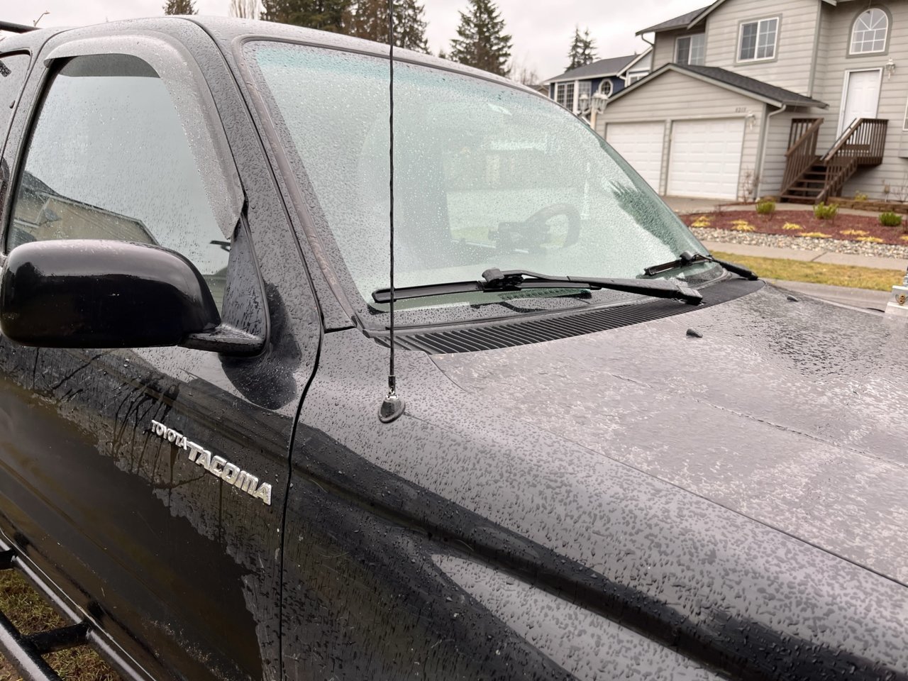

    When I bought the truck the radio antenna was broken, the dome light was missing, the AC button was missing and the climate control lights were burned out. A trip to the wrecking yard solved the majority of those problems and a trip the parts store fixed the climate control lighting. First gen Tacomas just aren't in wrecking yards here in the PNW, so I did some digging to cross-reference parts with other cars that can be found in the yard. The AC button came from a first gen Rav4, the antenna came from a Sienna and then dome light came from a Corolla wagon.
    The dome light in these trucks are terrible, btw. I'm looking to retrofit a map light above the mirror at some point, maybe one from a 4Runner with a sunglasses holder that can be converted to a switch panel?

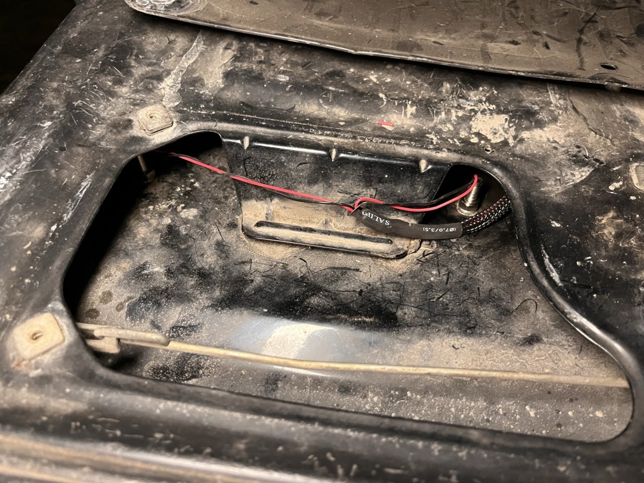

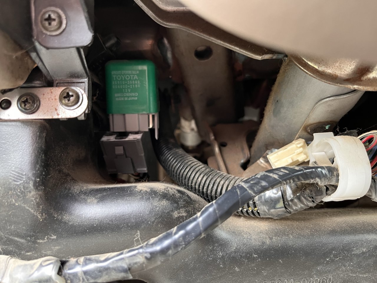

    While I was re-wiring the rear end of the truck, I also did some cleanup underneath the dash. In that process I ended up disconnecting a relay in order to make room for a brush and vacuum further up the dash. By the time I finished with the lights it was cold and dark and in my haste to get inside I forgot to plug in that relay. I had a small panic attack when I had a crank/no start afterwards, but a quick search told me the relay in question was the "circuit opening relay" and it's a go/no go for the truck to start. I have since found the same relay in a wrecking yard and carry it with me as cheap insurance. IMG_5042.jpg

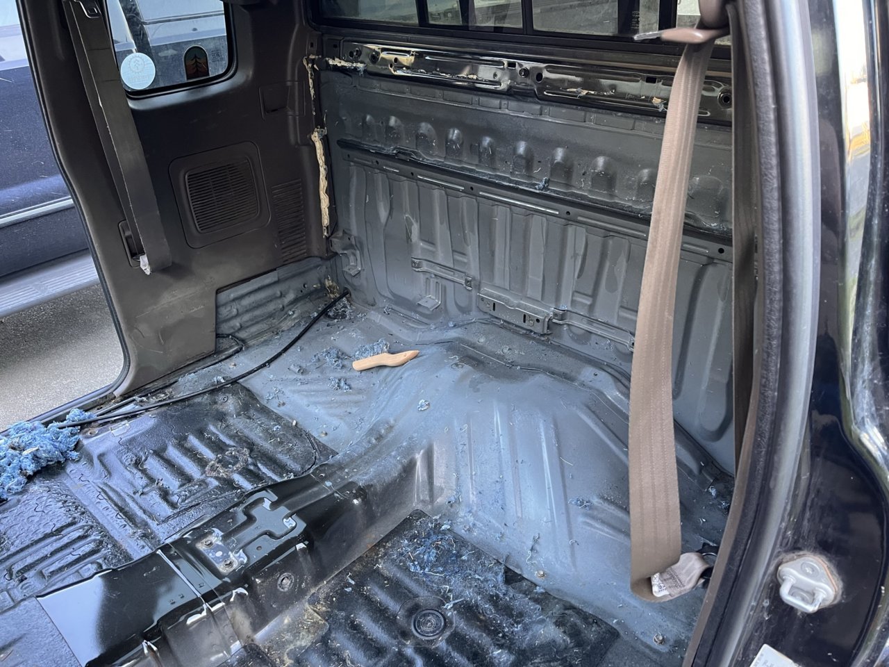

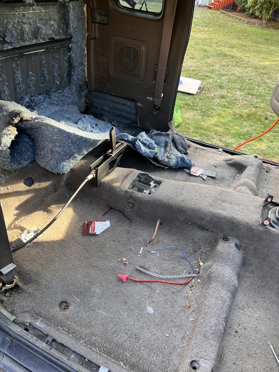

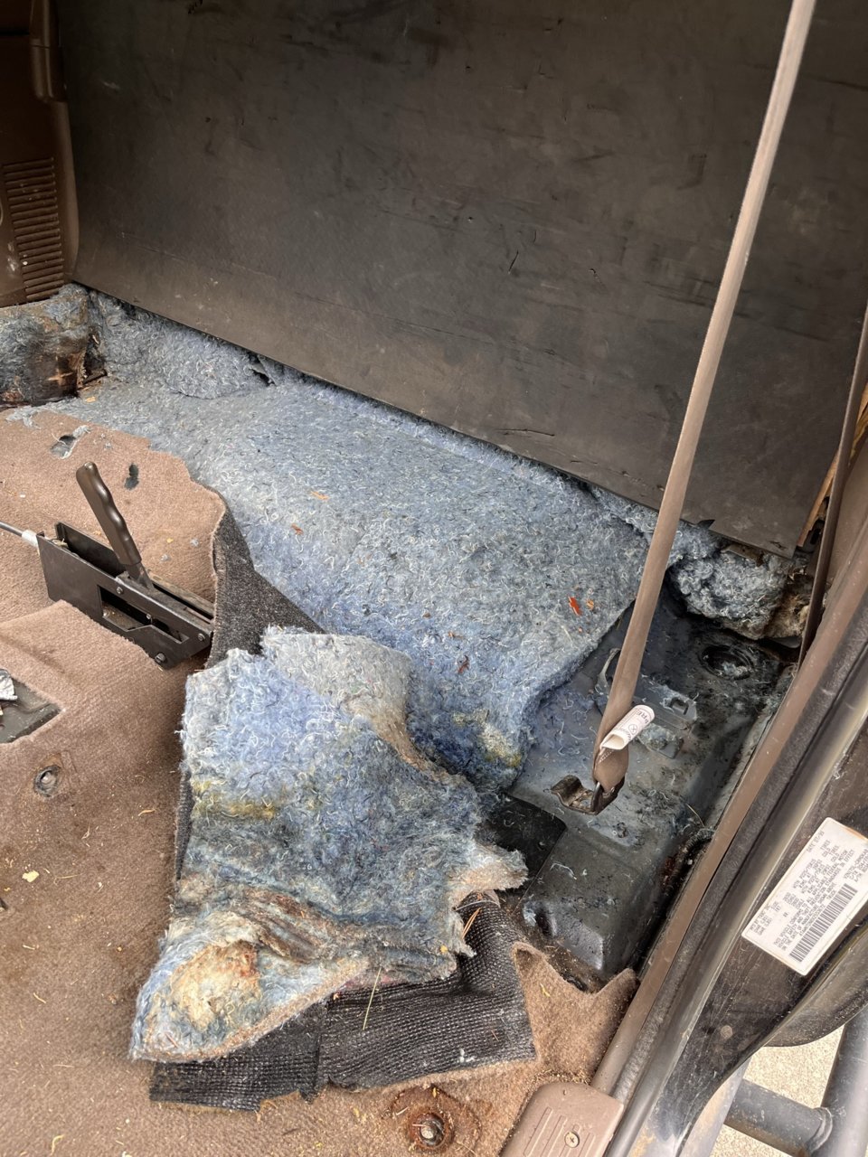

    After getting the relay situation figured out I decided to remove the parcel shelf and clean the interior. By clean the interior, I mean I put my hand down on wet carpet, found rotted wood on the parcel shelf base and proceeded to remove the entire interior a little bit ahead of schedule. Daylight is visible all the way around the rear window seals and the driver's door seal may as well not be installed with how flat it is. Charcoal colored vinyl flooring will be going in as soon as it arrives, and new seals have been ordered as well. IMG_5044.jpg IMG_5045.jpg IMG_5046.jpg IMG_5047.jpg

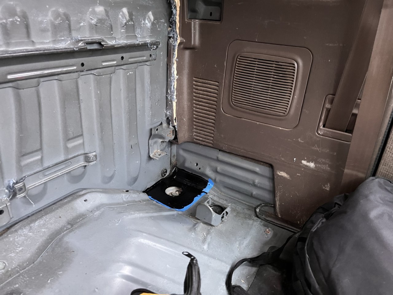

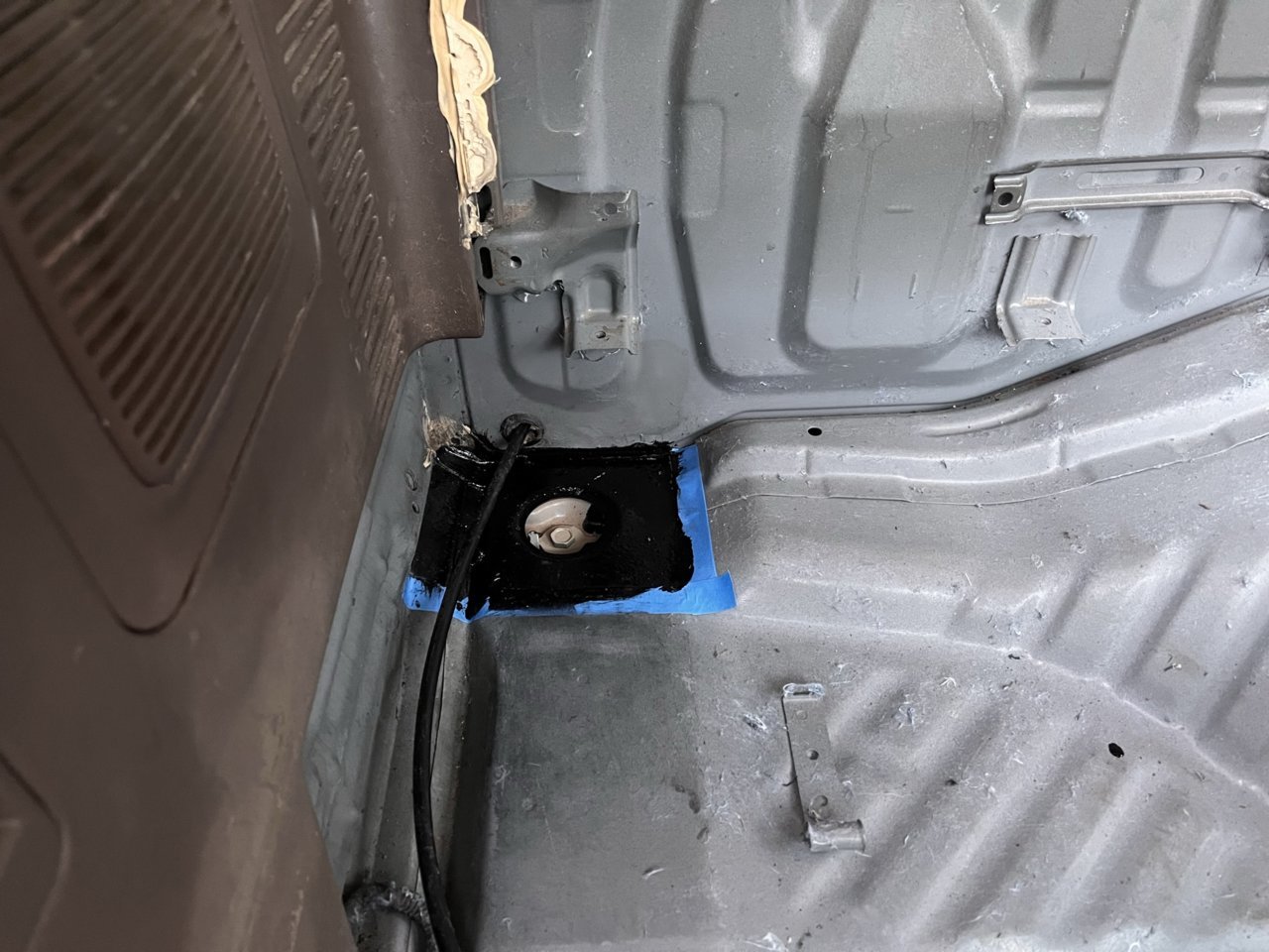

    When I disassembled the interior there wasn't any rust to be found, but I decided to take some preventative action and apply some POR-15 to the rear cab corners where the water was collecting. There's no replacement for the OG of rust prevention, but even at $40+ for a pint can, POR-15 is worth the price for the piece of mind. Thankfully this was just a couple of brush loads and there's plenty left for some work on the bumpers, control arms and frame brackets later.

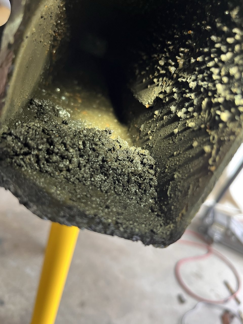

    A picture is worth a thousand words, or in this case what felt like a thousand hours of labor. I spent countless hours with a nylon brush drill attachment and a steel wire brush removing the recycled denim mat that was under the carpet and another entire afternoon with Goo-Gone removing the adhesive residue. In hindsight I'm not sure that removing the residue was necessary, but it was nice to have a clean surface to adhere the sound deadening mat to. Killmat was out of stock and this product looks and feels the same with good reviews as well, so I bought a couple of boxes to start out with. The entire floor from the dash to the back window is covered with minimal gaps and the truck is already quieter than it was with the factory carpet.
    I also went on a small quest to fix the 12v outlets at the bottom of the dash and trace a few abandoned wires from a long ago removed subwoofer. I found a treasure left by the original owner, lost in the dash since at least 2005.

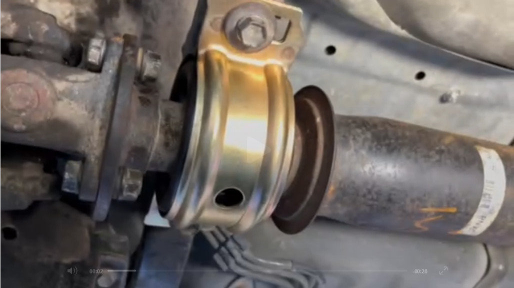

    A week or so ago I decided to track down any obvious driveline noises. Below 20mph this truck had a terrible rotational metallic grinding noise, and above 40mph it would turn into a terrifyingly loud scream. The previous owner already had it in the shop to address this issue and after inspection the transfer case was making some alarming noises and it was replaced with a much fresher unit, but I don't know how they missed the driveshaft carrier bearing. The old one had cracked rubber and was dry as a bone, making all sorts of noises even when turned by hand as seen here. I ordered up a Timken unit from RockAuto and had it replaced in about 25 minutes, eliminating the nose as seen here. Side note - everything I found showed people pulling the driveshaft for this repair, but I was able to just disconnect the joint connecting the forward and rear sections of the driveshaft, drop the rear section out of the way and work the support bearing with the front section of the driveshaft strapped to a jack stand. Maybe that's a side effect of having a few inches of lift and plenty of room to compress the rear section of the driveshaft? Anyway, it eliminated the alarming noise and has left just the faintest of a "whirr" sound - possibly a worn differential carrier bearing, tires, or it could be wind noise between the cab and the canopy... either way, it has gone from alarming to not even audible when there's anything in the cab or the radio is on. driveshaftcarrierberaing.jpg

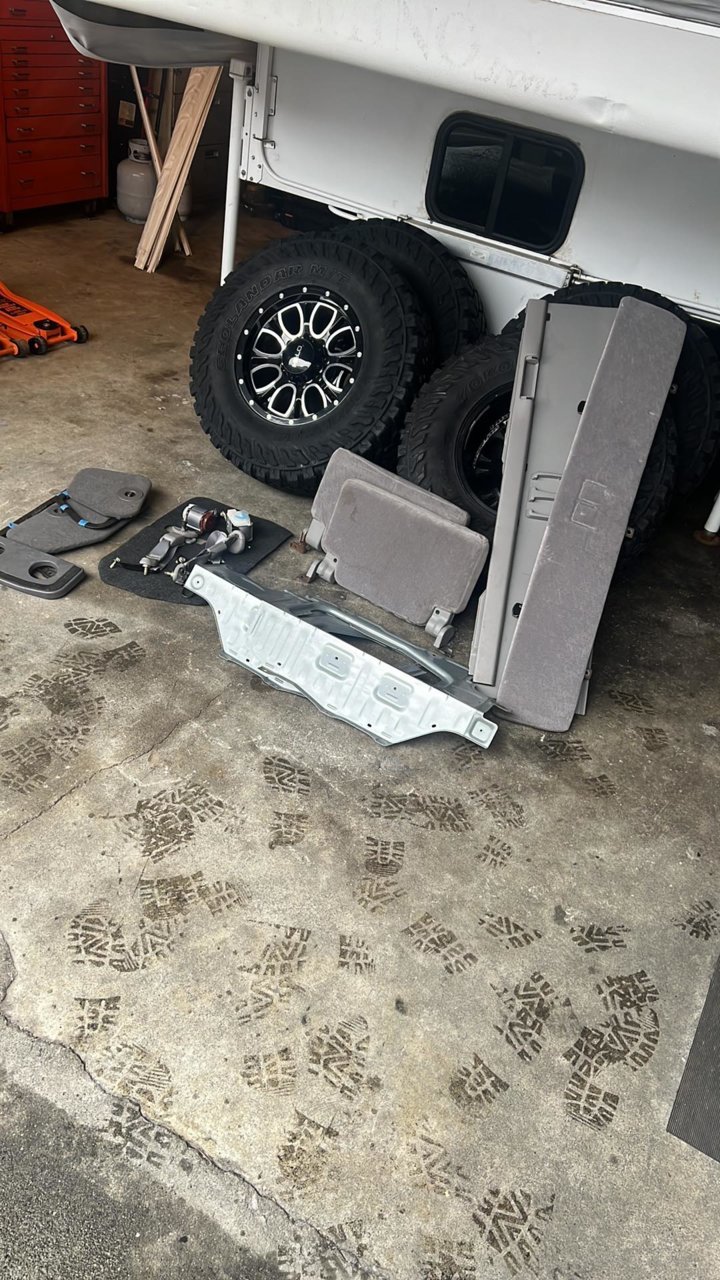

    Facebook Marketplace score! The biggest hurdle to installing a back seat has been overcome - finding the metal pieces that make up the little storage pockets under the seats. Tons of listing had individual pieces, but I found a local guy who had 5.5 first gen Tacomas in his yard and let everything he had left for an extended cab go for a decent price. I will be doing more research on the rear side panels (or if anyone wants to save me the hassle, are 2001-2004 panels going to work in a 1999?) and maybe going back for more. Since much of the interior of my truck is missing or in rough shape, I think I may use this opportunity to switch to a black/gray interior since I'm looking to wrap the truck in a metallic graphite anyway. A quick test fit shows all of the bolt holes line up, and now we just wait a couple of days as I spent a good hour or so deep cleaning everything while it was easy to access.

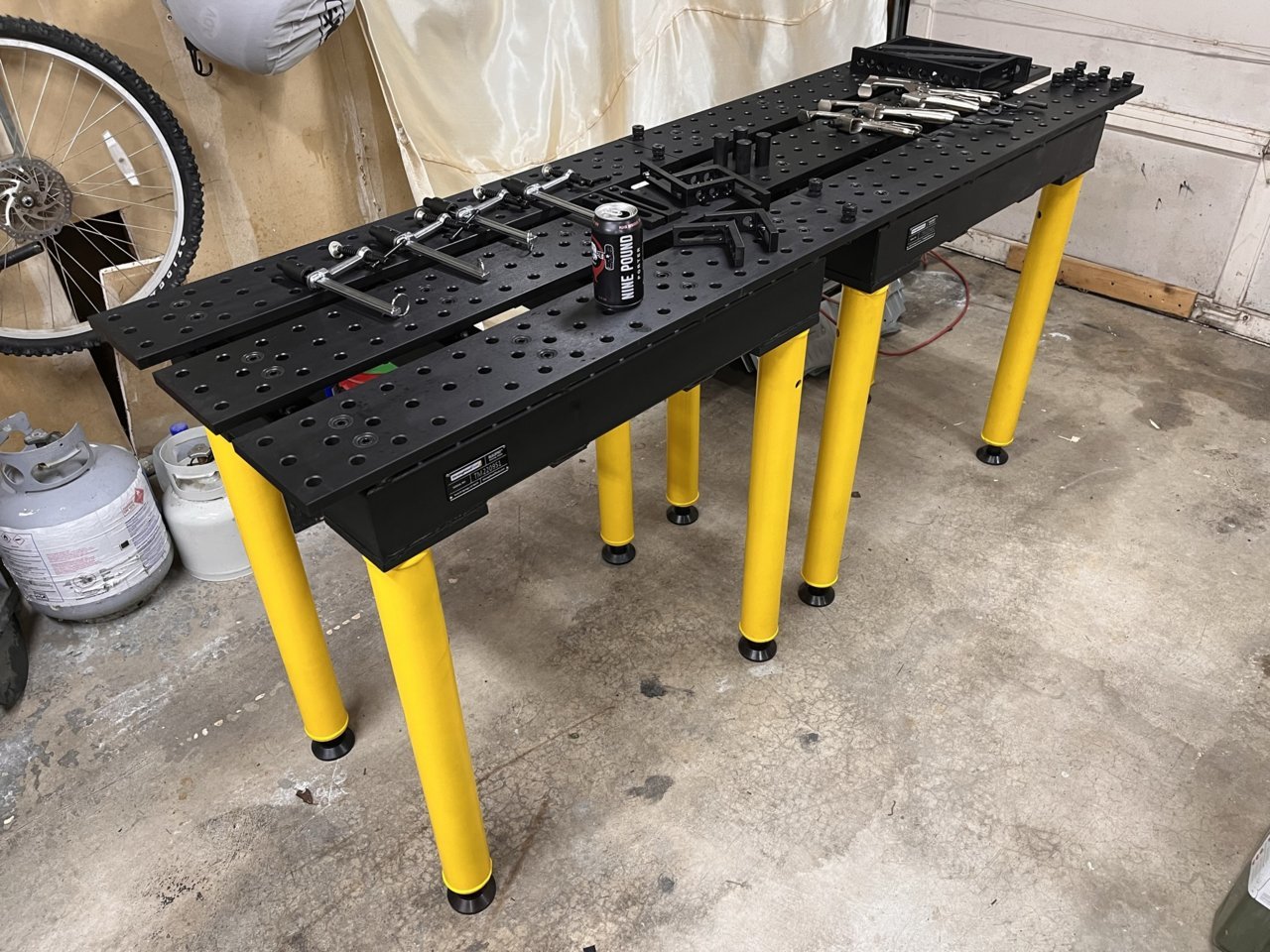

    I'm still waiting on a hardware order to install the seats I picked up earlier in the week, but in the mean time I got a nice gift from Santa (tooling account for a side job). Not 100% Tacoma related, but these fixturing tables will facilitate a couple of projects on the Tacoma. The first project I'll be using these on is the swing out tire carrier as the one that is on there is terrible. I'll be reusing most of the materials, but centering the tire carrier and lowering it about 6" while still retaining the ability to hold a 33" spare currently and up to a 35" spare by moving one piece.

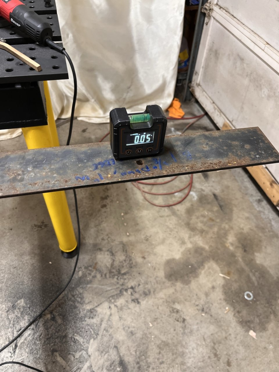

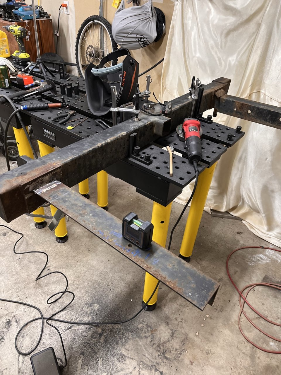

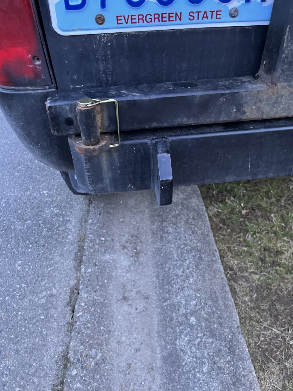

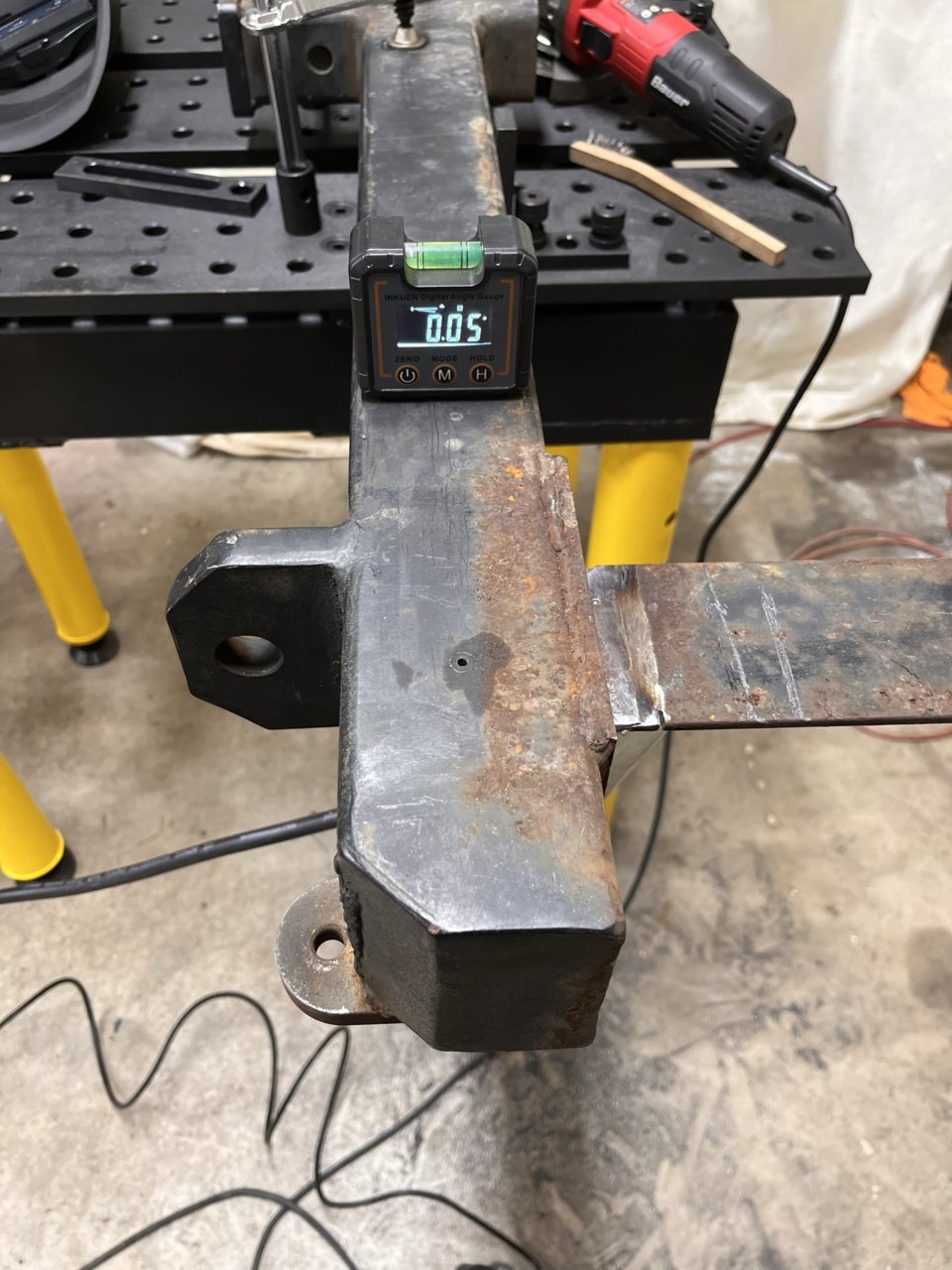

    New fixture table is being put to use today. I started the day trying to square up the bumper on my Tacoma, and after a few attempts at modifying the mounting holes I decided to cut and re-fit the mounts. 4.5 degrees off was where I started. After cutting the original welds (leaving a couple of tabs to hold the position) I beveled the edge of the mount and fit it to almost -1 degrees then used heat to my advantage and got it to settle square with the bumper itself. Test fit tomorrow or Monday, then I should be good to weld it up for good.
    69907200262__E7501AB4-5B52-42E1-ADCE-5C4AFEEBDDAD.jpg 69907201494__7525CDFF-B41B-445C-A74C-598D2C95401F.jpg 69907225030__8E2AC485-89E3-4218-94D2-C2AFAE2FC826.jpg

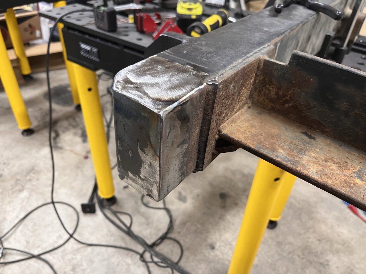

    The past few weeks have been ridiculously busy with life stuff, so I haven't been able to work on things as much as I would have hoped. I have, however continued on a couple of projects. First up is the rear bumper. What started as an attempt to align the swing out tire carrier has turned into a bumper rebuild on account of the number of poor welds I've found. When I cut off the swing out spindle the bumper cap came with it (I didn't even cut that part off, but the welds failed completely). The inside of the bumper was a nasty mess (the metal protruding was the original mounts that were cut flush on the outside and reinforced with 1/4" plate by the previous owner). Through the cracked welds and gaps in a couple of places the whole bumper was full of water and years of sediment were left after I drained it.
    I've since welded new caps on and ground them flush and filled the original mounting holes on the left side so I can drill new ones that are actually aligned with the other side (the left side needed to move aft 1/4" and down 1/8" to match the right side).
