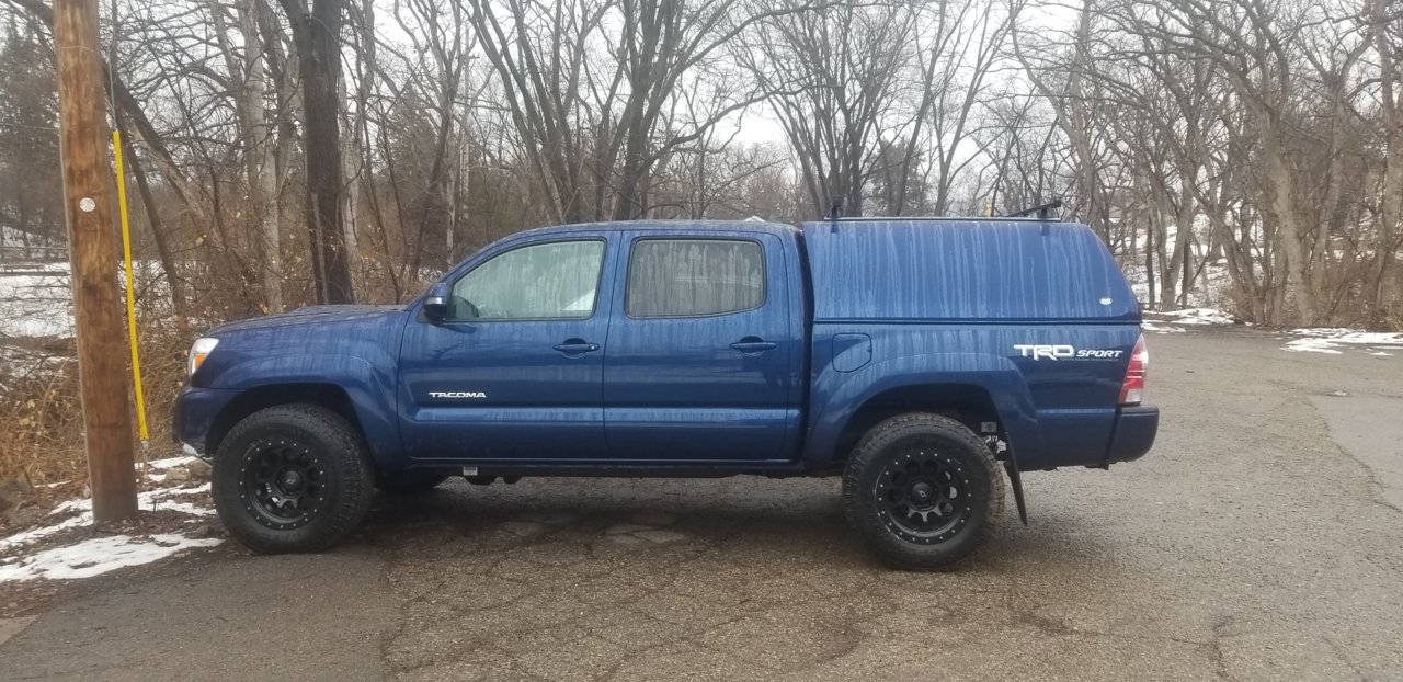

    20190223_083801.jpg17×8.5 ray10s
    265/70/17 tires
    Only rubs on air dam when at full turn and going up or down a hill or if I'm hauling ass lol. I would imagine you should be fine with lift, I'm trying to figure out a solution for my minuscule rub currently
