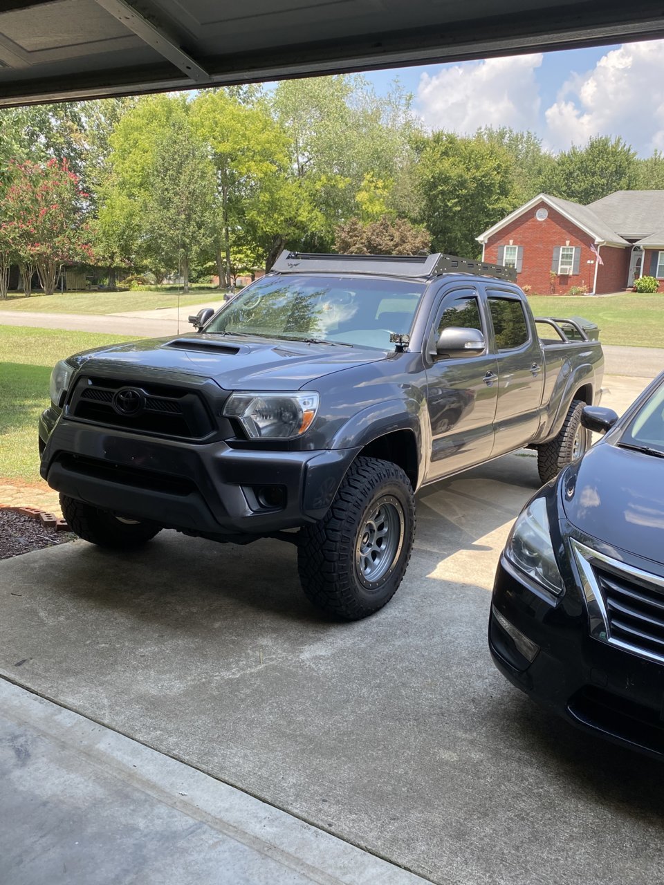

    I have a 2in level up front, 17x8.5 scs ray 10 with -12 offset, 265/70/17 and no rub.

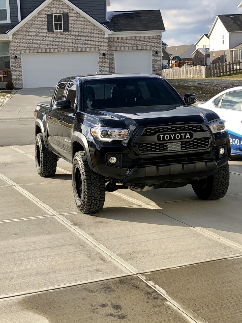

    Stock suspension in those pics. I now have a small lift, Bilstein 6112s on the 3/4 settings so about 1 1/4" in front. Go to my profile and look at my posts and you will find some other pictures I have posted if you want to see it with the lift. Actually just changed to a different wheel set up also.

    I would stick with a 265/70/17.

    I would rarely rub at stock height. An alignment pushing the wheels slightly forward would have taken care of it but I waited to get it aligned after the lift. Some very minimal trimming would have also fixed it.
