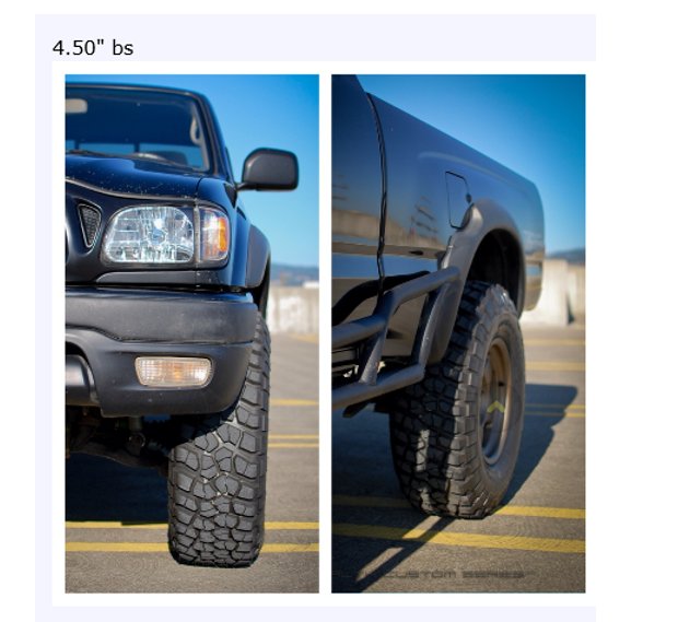

    Hi Mike,
    I just PM'ed Charles, he had the same question. Here is a pic I have of the 4.5BS on a 2004 TRD (NOTE: ironically this is Vins truck I believe and double ironically, its the same as mine: 2004 Black TRD :) )
    Fitment: I will tell you I am stock and running 265/75/16 and I rub ever so slightly on turn in. I am lifting at the end of the month so will report back if that changes anything.
    The 4.5 is fucking perfect IMO. Right to the fender

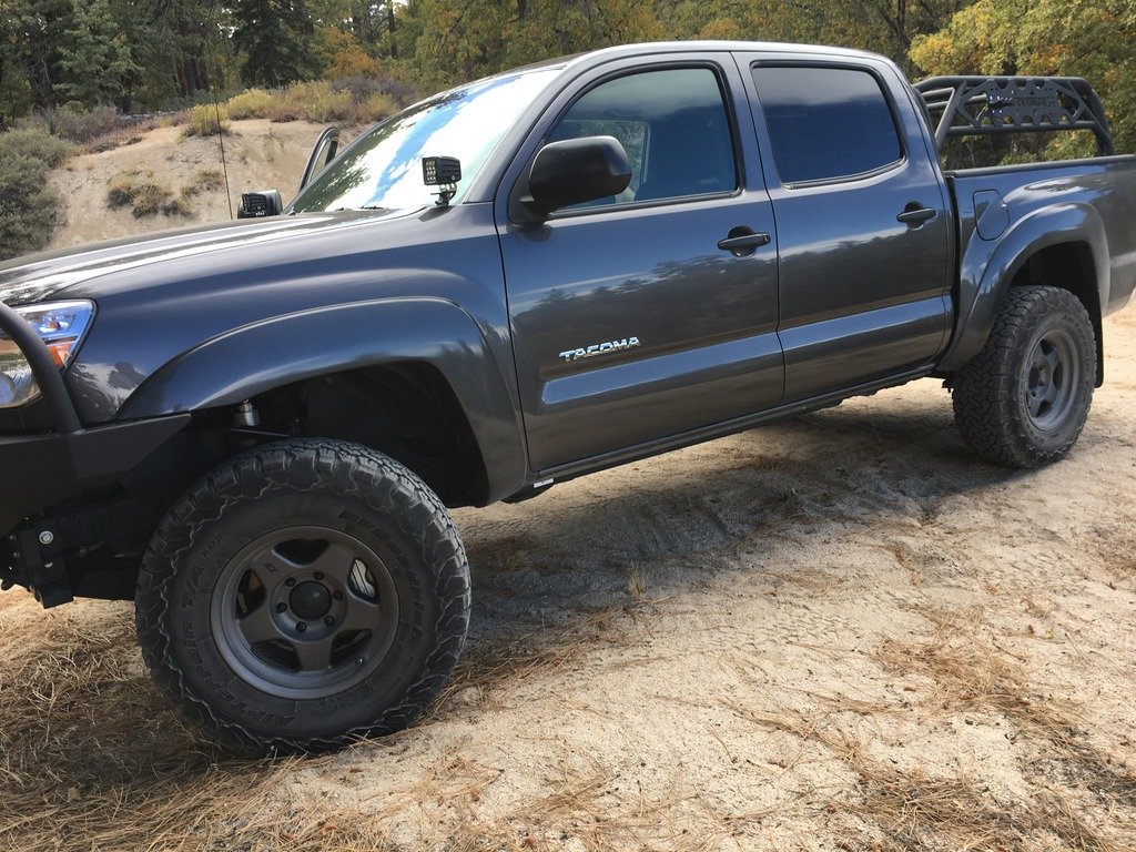

    Here's my new F5's. Gunmetal grey with Magnetic grey. Running 265/75/16 BFG AT's on 2.75 ICON lift

    That is fucking beautiful!! I have the same wheels and ditch lights too but love your rig man.

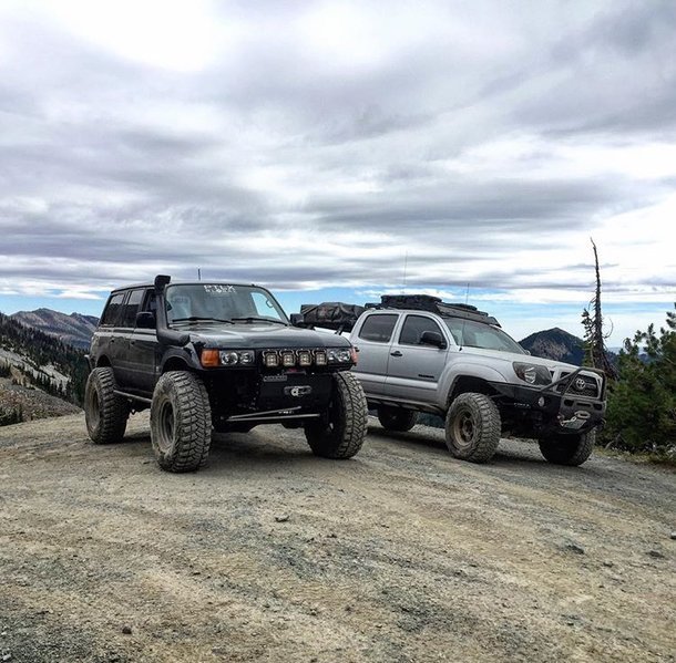

    You're better off with the standard backspacing in the 17's. I'm running 35's and a BBK it's the perfect offset.

    Does your friend have a build post somewhere? I love his truck.

    He does on ih8mud but can't remember what his build is called

    No rubbing on the frame. It's not the same offset as a 16. A 17 has a -12mm offset so that helps.
    BBK = big brake kit
