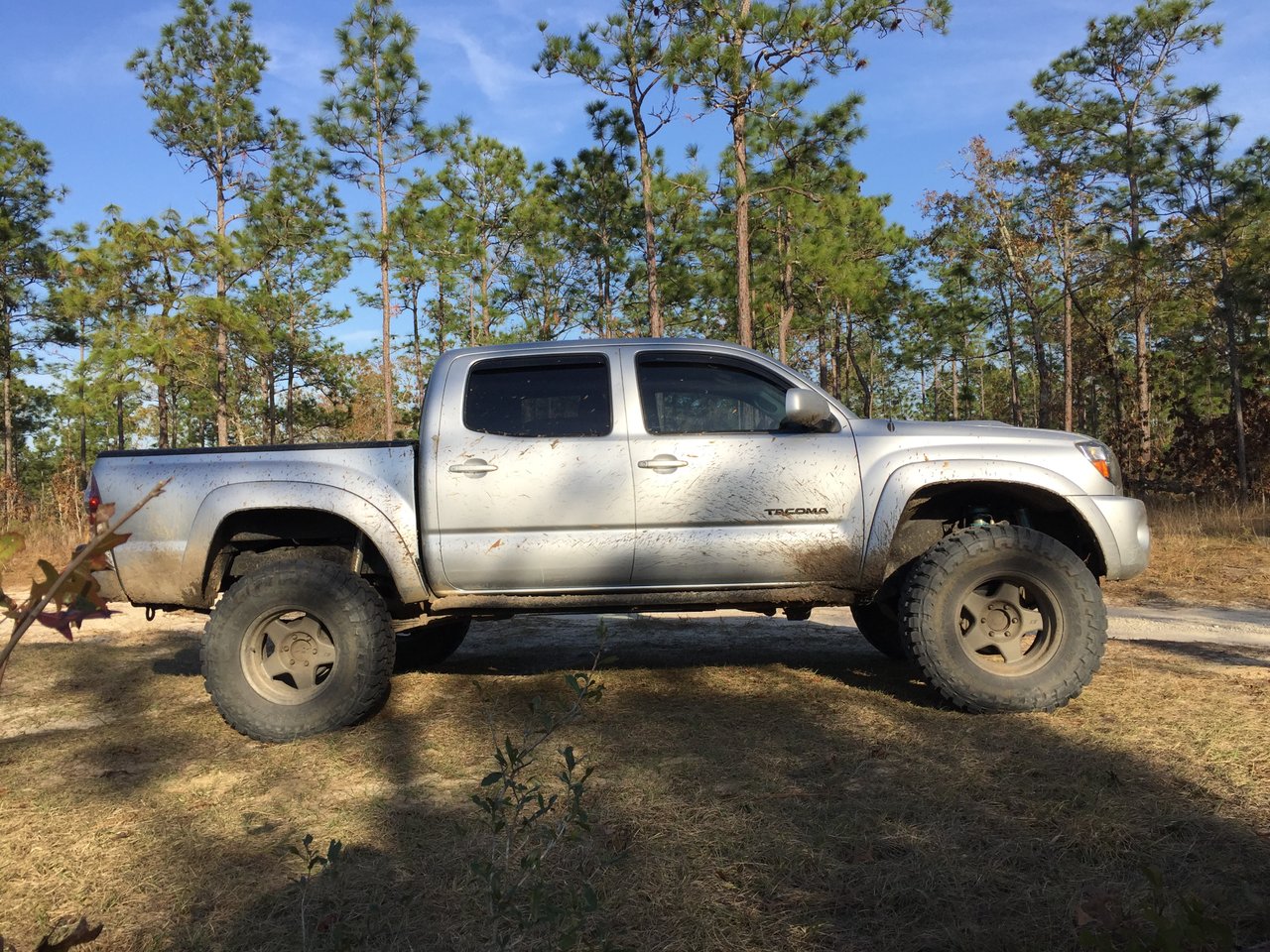

    Got lucky and picked up a in box set of Gunmetal 16x8 4.50"BS off fellow member @phytophthora. I swapped out my rims yesterday( to cheep to get new tires) and this afternoon when to shoot some pics and noticed the paint flaking off from the middle where the hub goes on 2 of the rims. Total bummer but I went out and wheeling anyway. I have email SCS to see what can be done but they still look soo good.

    Man, it looks Toyota painted them with the same coded paint they are that close! Nice Job. Pisser about the paint flaking though.

    I know I was worried it was going to be too matching but its just different enough. @SCS is saying it "neglect on the tire technician's side" so I guess im going to check out a paint shop to see if they can touch it up or at least stop it from flaking more.

    Unfortunately, we see this happen more often than we like. I can say without a doubt that it's from using improper equipment when the tire tech does the balancing. 95% of the time, it's from them using a front cone mounting system where you get metal to metal contact being tighten down onto a painted surface. The tech should have used back coning or even a pin plate adapter. Both methods would have resulted in a scratch free balancing job.

    This, and just sliding it onto the balancer shaft with an 60+ pound tire without dragging it on the shaft. With no center cap, there s nothing to hide that.
