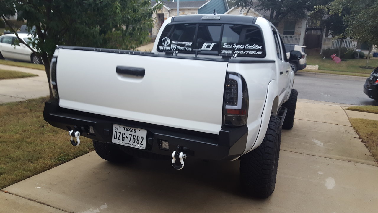

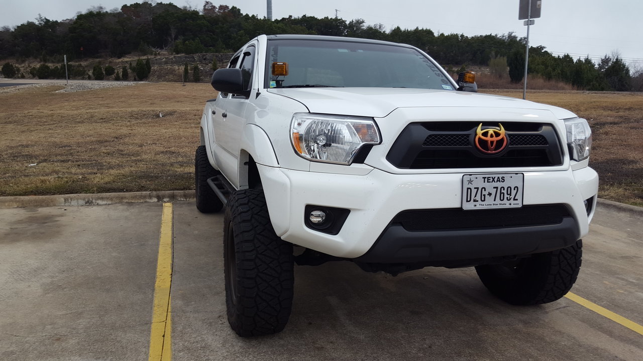

    17x9
    3.5 backspace
    -38 offset
    Nitto Ridge Grapplers
    285/70/17​

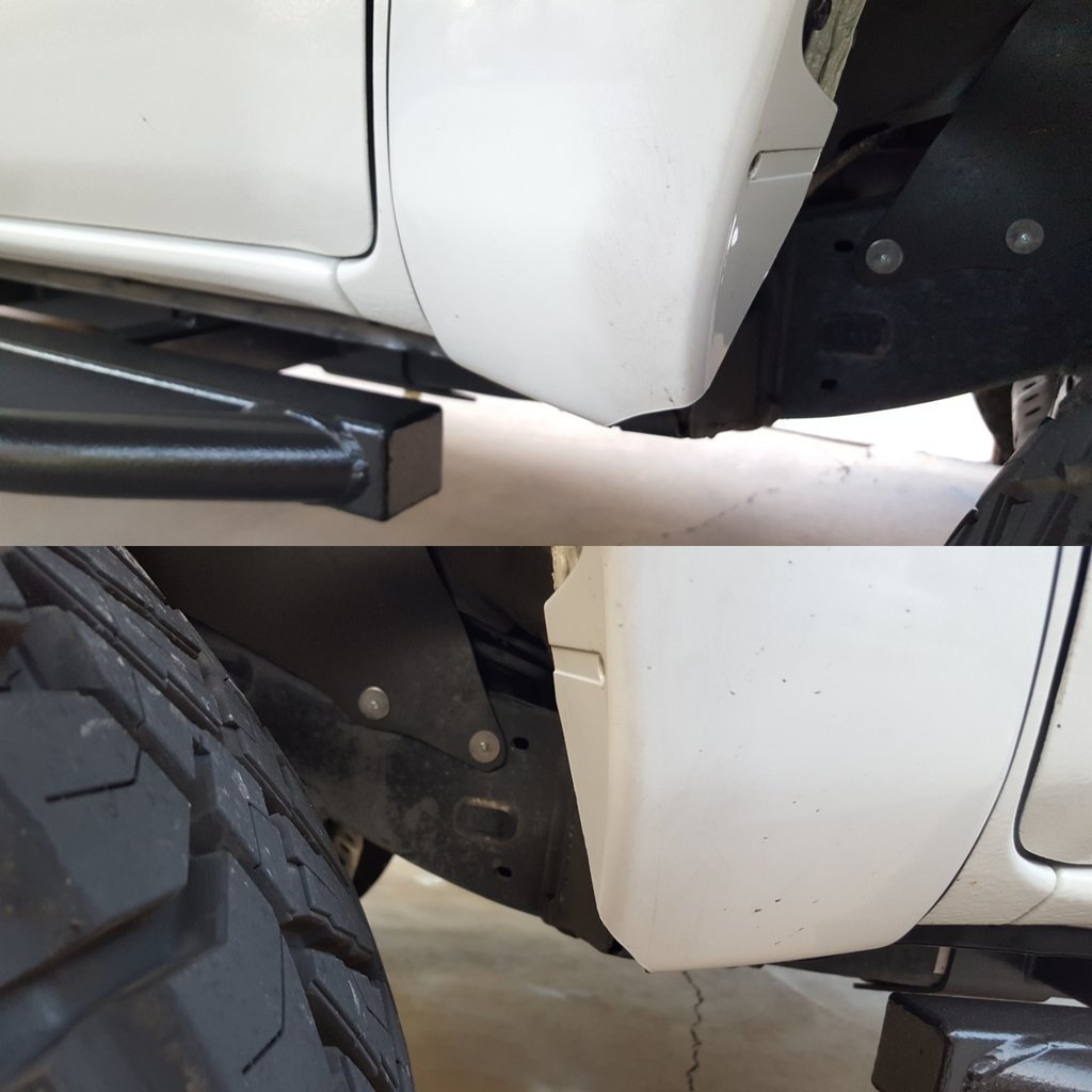

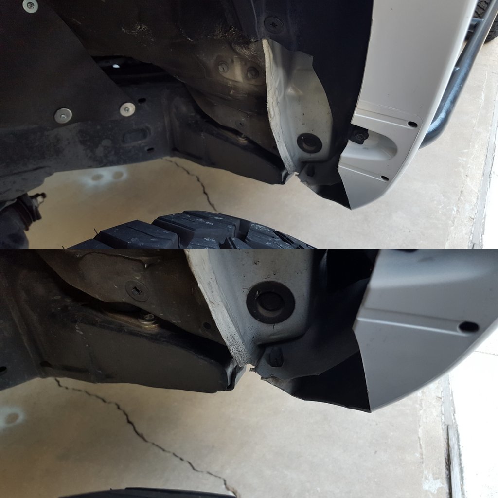

    how much did you have to cut to make those 17x9's work? Do you have any pictures of how much poke are you getting as well?

    I had to trim a tad bit more than usual I'd say. This is largely due to the fact my aftermarket spindle setup pushes the front wheels out .75" more per side. Increasing the scrub radius.

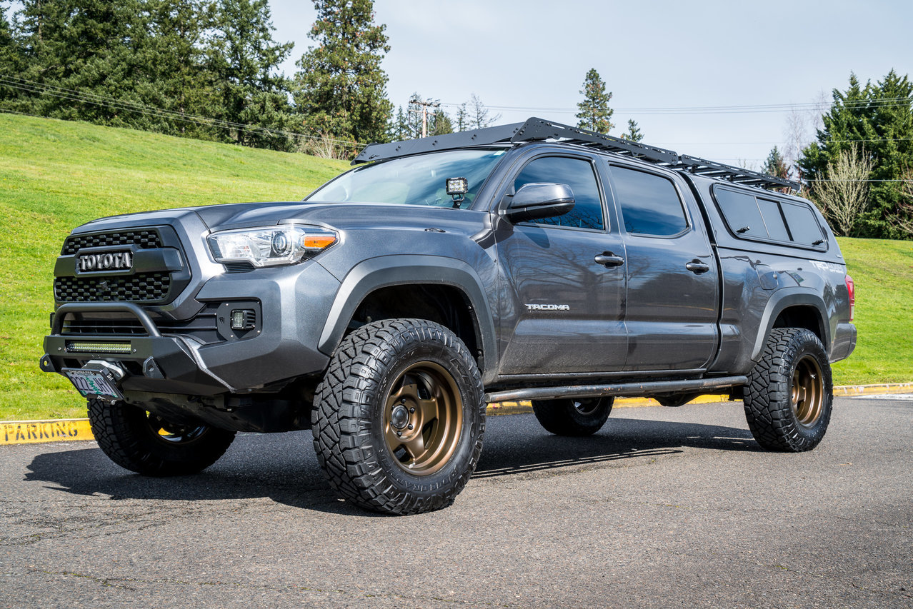

    So, I did a thing today :D

    Hngggggggggggggg
