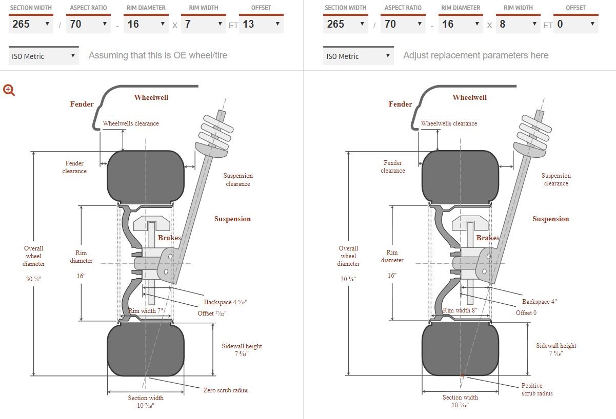

    exactly. so if the offset is zero and the wheel is 8" wide, you're backspacing is 4".

    here's a visual

    Backspace is the distance from the inside edge of a wheel to the mounting face. A wheel’s backspace is equal to ½ the wheel’s width + offset (in inches) + ½” (see image for reference).
    That 1/2" they reference in this article is interesting. That's the first time i've read that. The site pick I posted obviously doesn't take that into account. Ugh.

    The 1/2 is the thickness of the mounting surface.

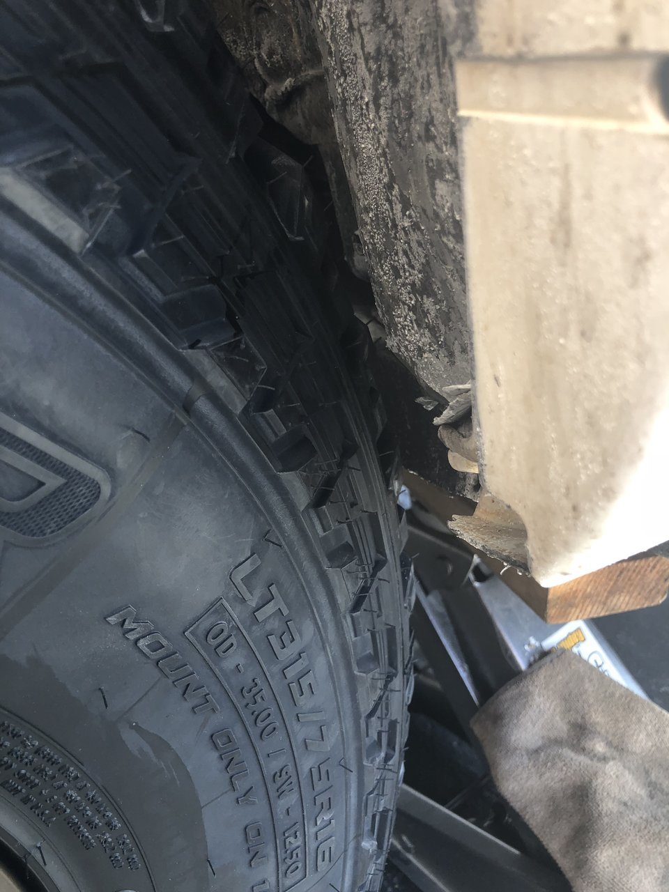

    of course. trying to understand if it's an issue of the cab mount or just fender well liner. so far everyone on here is running bigger tires on the 3.5". or stock tires on the 4.5". but really the appeal of the f5 is that deep dish which you only get with the 3.5".
