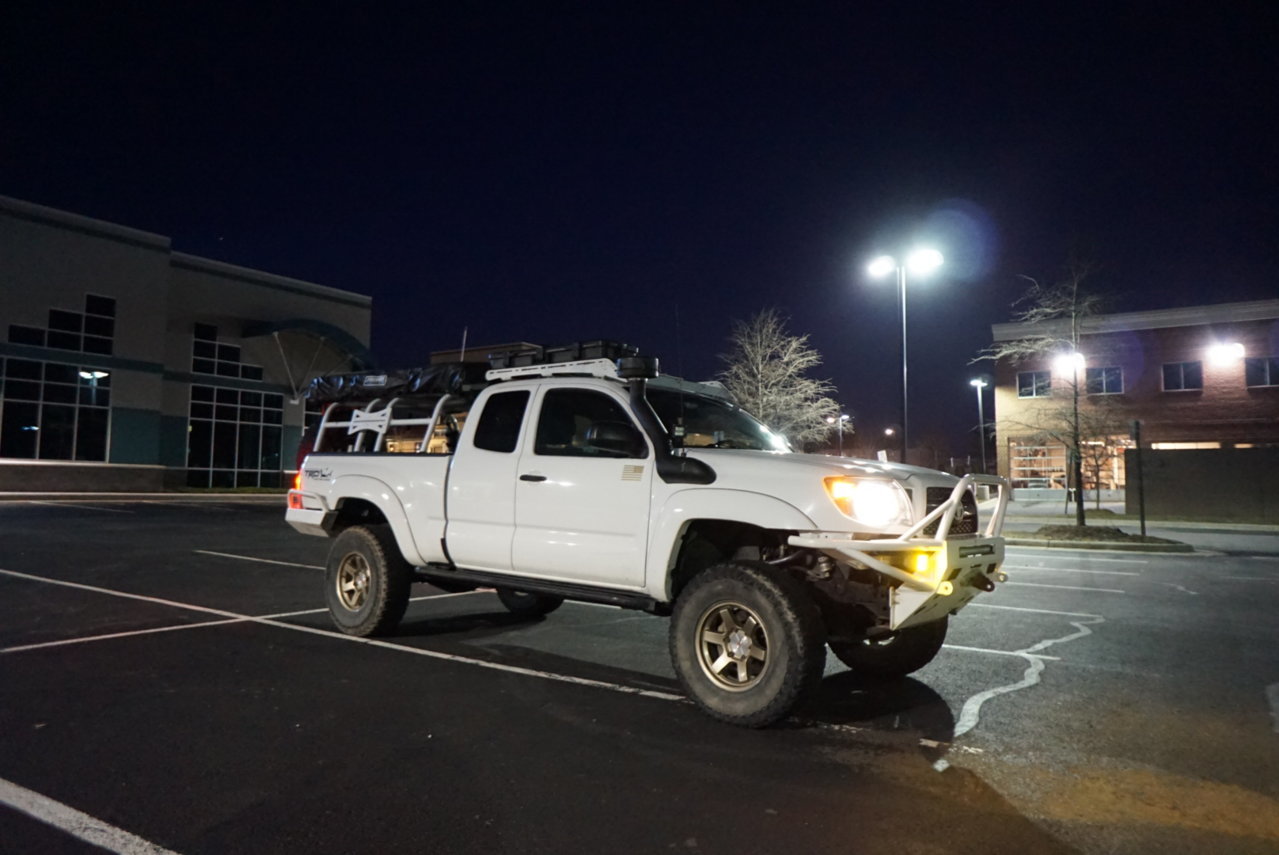

    The F5s are 16x8 3.5BS/-25 offset. I went from 16x8 4.5BS/0 offset on 255/85/16 to the F5s.
    Gold wheels are 0 offset
    Gunmetal F5s (with bronze spare) are -25 offset

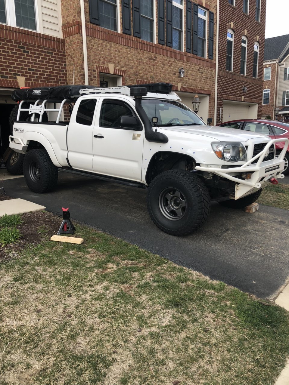

    I am going to redo my CMC soon. I would see if a 3rd gen has the 3.5bs. You might need to trim. Ive had 255s for a long time. Let me see if I have an old picture to show the trim from before..
    Also, I have alot less bumper, and I cut 2" from my fender to fit the 35s.

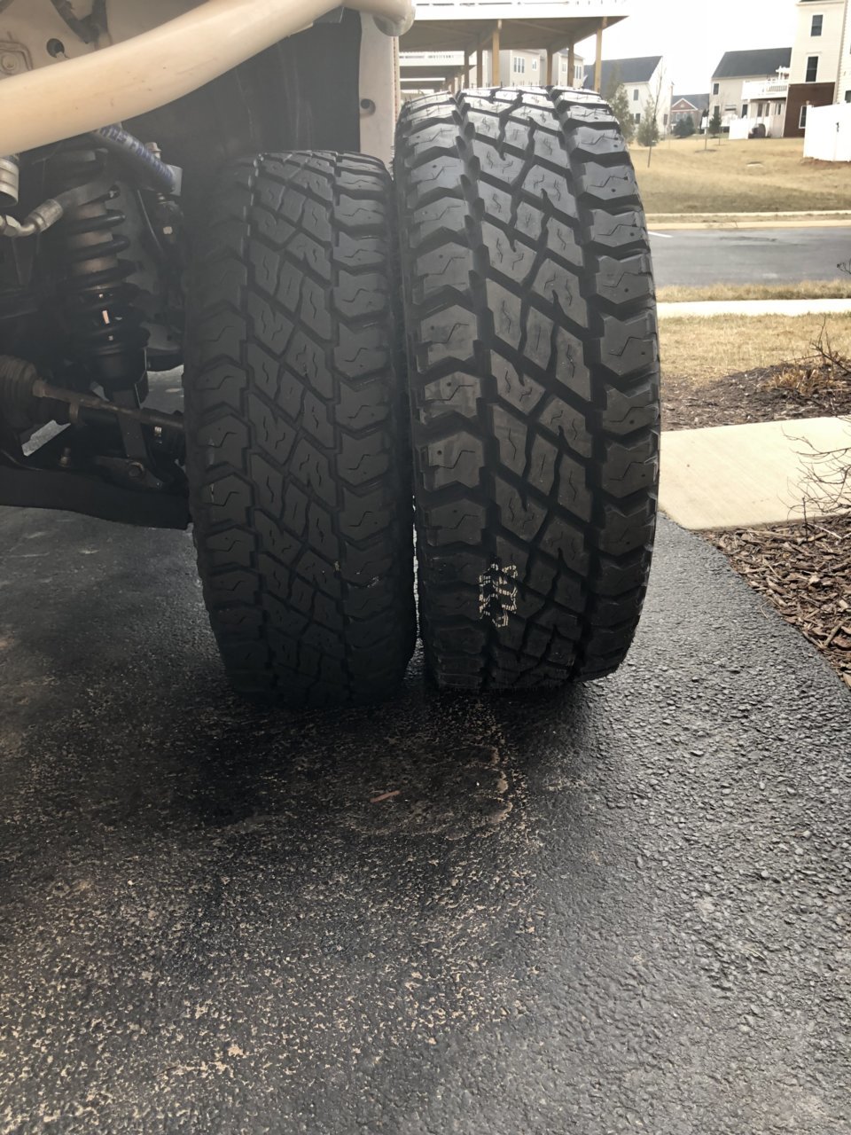

    Im pretty sure they wont. Make sure you try to get as close as 3* of caster as you can, to move the tire away from rubbing.
    Kinda related, but not really.. 315/75 vs 255/85

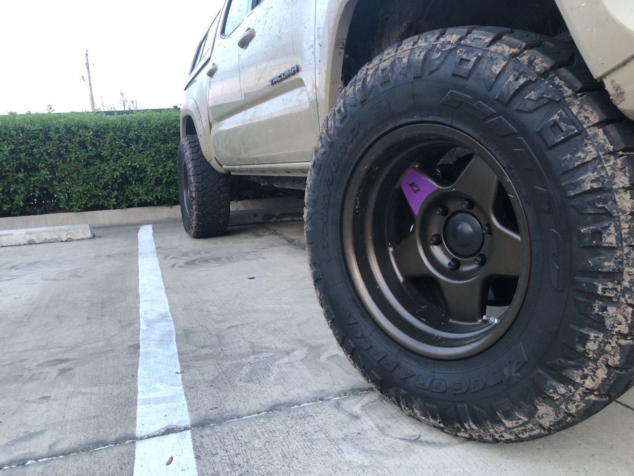

    Loving the wheel stickers

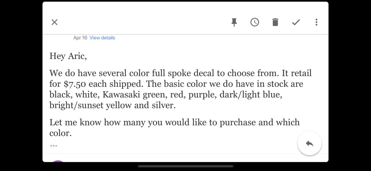

    Any chance you know what color wheel stickers they have available?

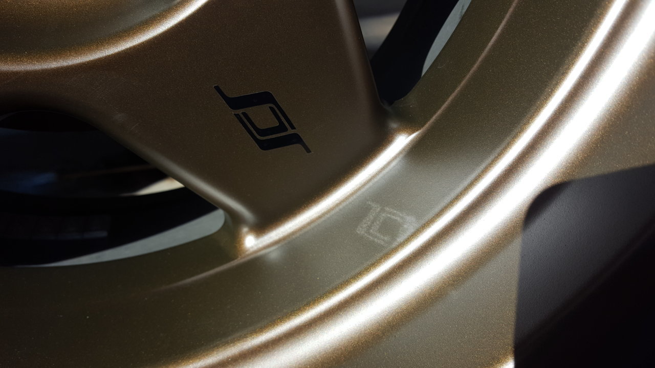

    Yep

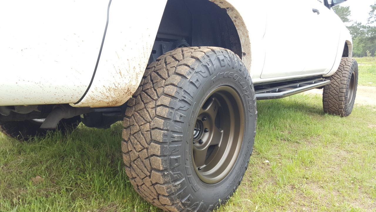

    Bold choice!
    Would love to get em' in a "chrome bronze" finish. Been meaning to change out my stock black SCS with that but maybe the whole spoke is the answer! :thumbsup:
