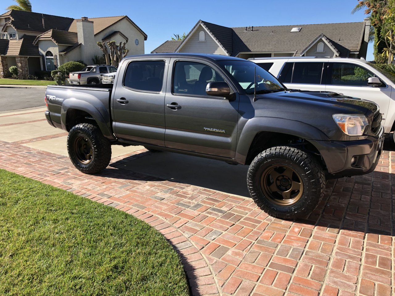

    Man, those look really great. I went with the 4.5 BS, but your pics sealed the deal with choosing gun metal vs black on a silver TuRD.

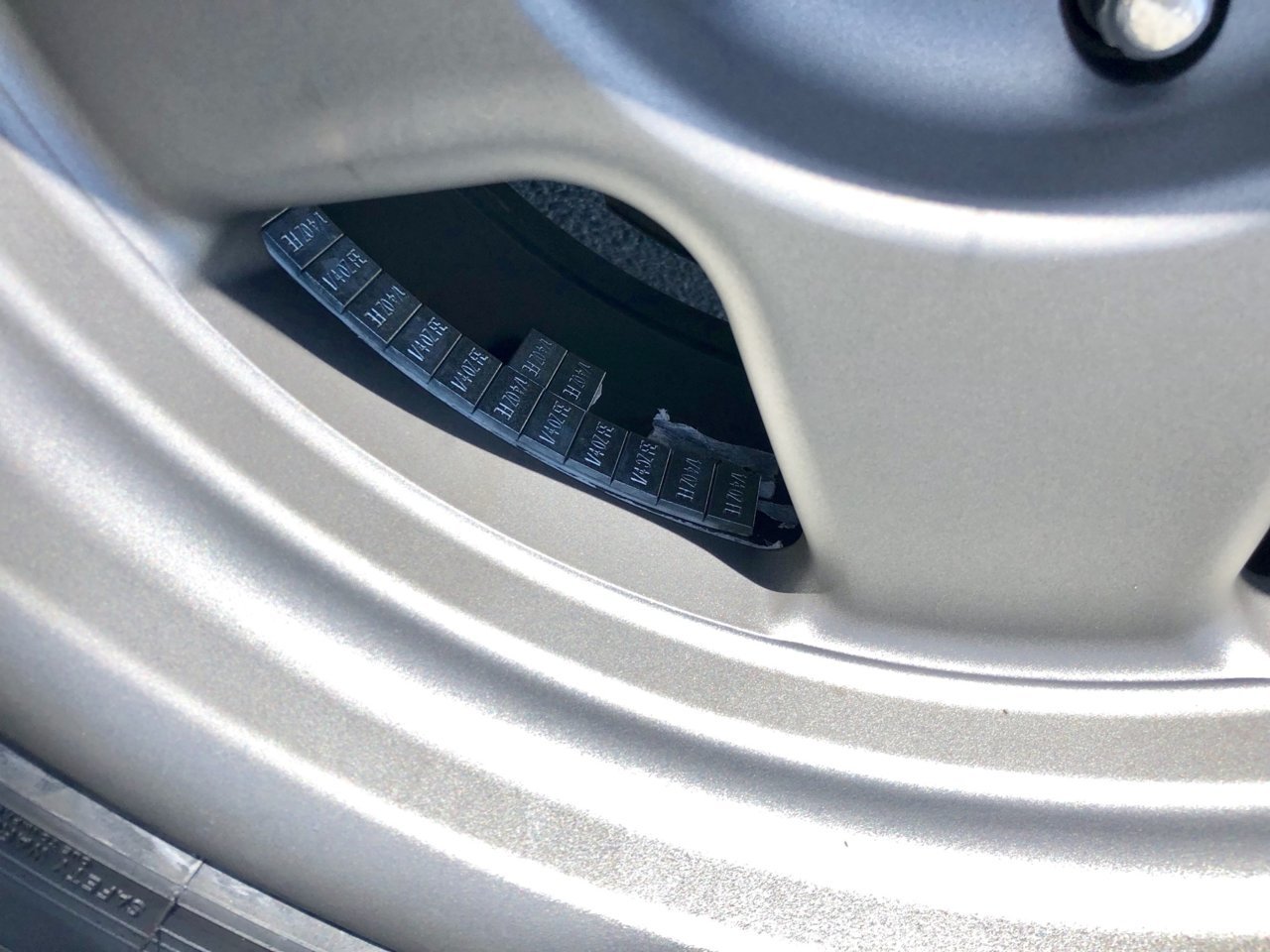

    I had discount tire mount BFG KAO2 265/70 17 last Friday, and 3 of the five wheels have around 20 weights. They tried rebalancing when I said something but same result. I have a pretty serious steering wheel shake at 55-60 MPH and then another around 70. I am really disappointed and frustrated because the rims look so good. Anyone have any suggestions. My old rims and tires had a slight shake around 70 that went away when the tires warmed up.

    Yeah, like 3 or 4 weights on two of the wheels. The guy didn't seem too concerned with all the weights; told me "Toyota's sometimes take a lot of weights." At that point I didn't figure talking anymore was gonna get me anywhere. Maybe I need to road force balance?

    Check out this quick video, this will give you a general idea what to look for.
    https://www.youtube.com/watch?v=4LZHW_nFa6Q
    Stick-on wheel wight is best.

    Have your tire installer check each tire to see if it's out of round. We've seen brand new tires as well as used tires that's out of round. This will cause some vibration issue. For the best tire/wheel balancing method, we recommend you take wheel/tire to a shop that can perform Road Force balancing. This method will cost your a little more than the traditional way but it will be the best method to get your wheel/tire balance properly.

    How’s the rubbing?
  20. Jan 25, 2019 at 10:20 PM
    #3640
    SixthSnail
    SixthSnail I have no idea what I'm doing
    Oct 3, 2014
    #139599
    13,289
    Los Angeles
    '14 Tacoma Sport
    See Build in Sig
    None! @GHOST SHIP beat the shit out of the truck
