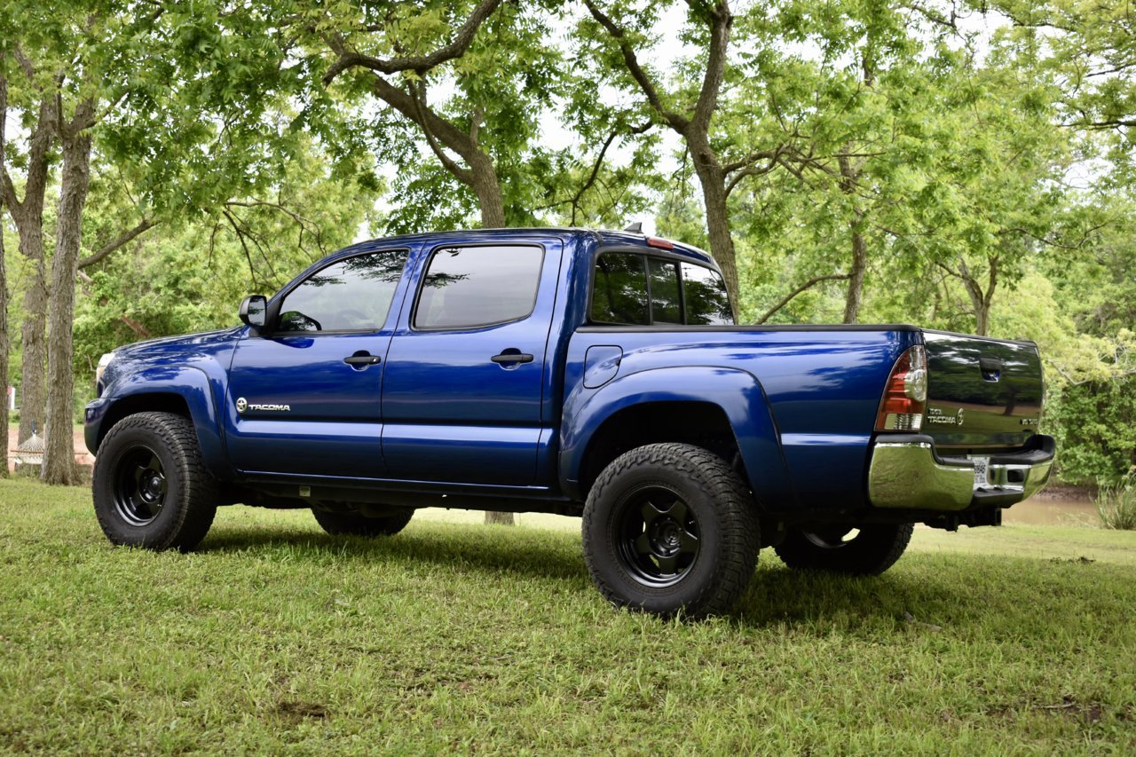

    Upgraded from a 1st gen to a 2nd gen, swapped my F5's over as soon as I got it home :thumbsup:fullsizeoutput_8ad.jpg fullsizeoutput_8ab.jpg
    Stock height, 16x8 3.5BS with 265/75/16. Trimmed some of the flare off, but still rubbing somewhere in the front in reverse, so more cutting to do.

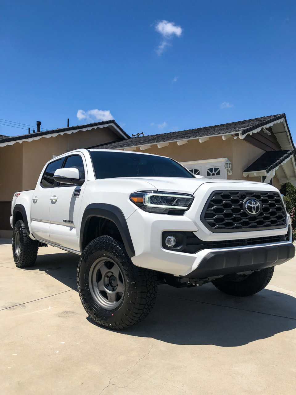

    Anthony
    2020 White Tacoma TRD 4x4 Off-Road
    Finally got these beauties on!
    Bee Finn, Groan Old, scs_vuth and 5 others like this.
