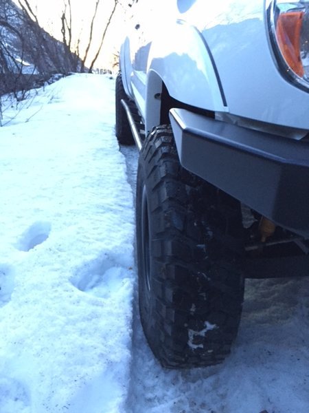

    255's w/ 3.5 BS. Rub everywhere, but it's getting better as I :sawzall:

    Get an alignment and some castor, that'll fix it. What UCA's are you running?

    @northwesttaco SPC LR UCA. That's a good idea though... Do you run the same?
    Cut my tire today on the lower fender. Took the fender flares off and am planning to trim 3"... Guess you can never start planning for 35's too early.

    Uhhh definitely get more caster first before you cut.. Your tires will look very small if you cut 3" out (which may not be a bad thing if you want 35's next week :D) Im running 285's on 4.5" bs, soon to change up the wheels.

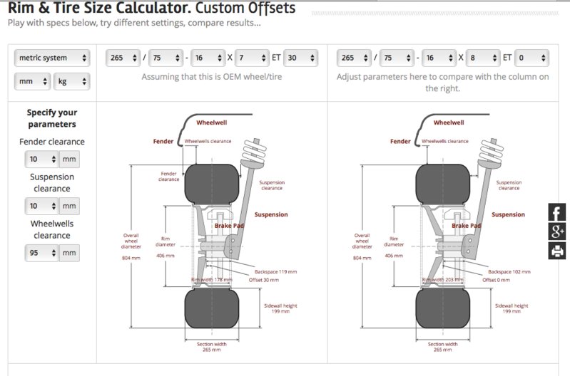

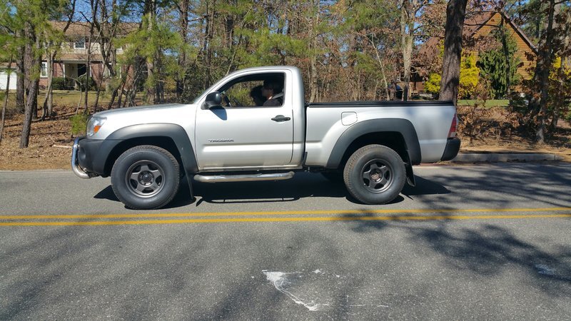

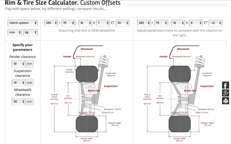

    Does this look about right for where the tires will be sitting with a 4.5" backspace / 0 offset in the first pic?
    Stock OR rims w/ 265 75R16 on the left, same tire but F5's on the right, next pic below is where the stock vs Ray10 backspacing should be.
    Trying to decide if the 4" backspacing of Ray10's is going to push the tire too far out for my liking or not.

    Well it is going to be .5 inch farther out than mine, which is the same spec as your F5 setup.

    Awesome!!!! Thanks for the great pics.....That was exactly what I needed to know. :cheers:
    I really like the stance on your truck and I don't think I want much more tire sticking out than that.

    Yeah, I was trying to figure out the same thing and came across that online calculator too. This is as far as I would go, and I have some aftermarket mudguards I'll be installing after I get my lift on.
