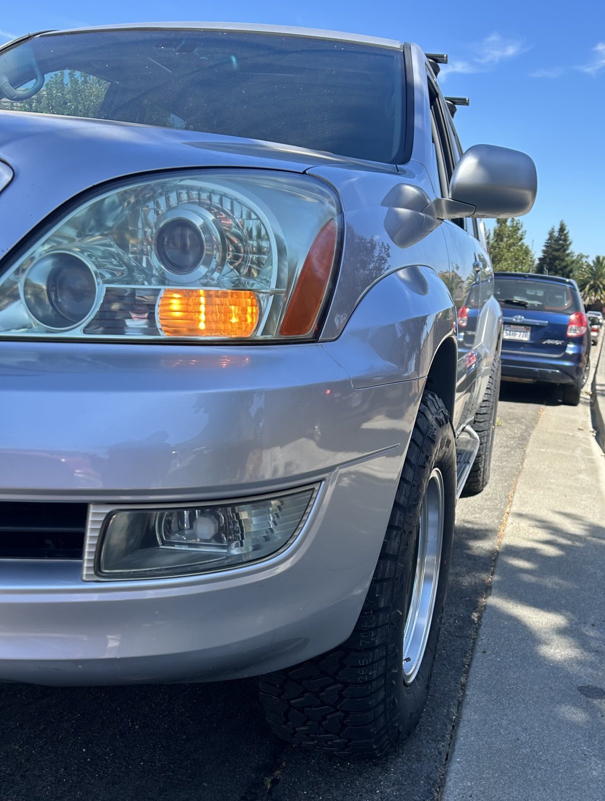

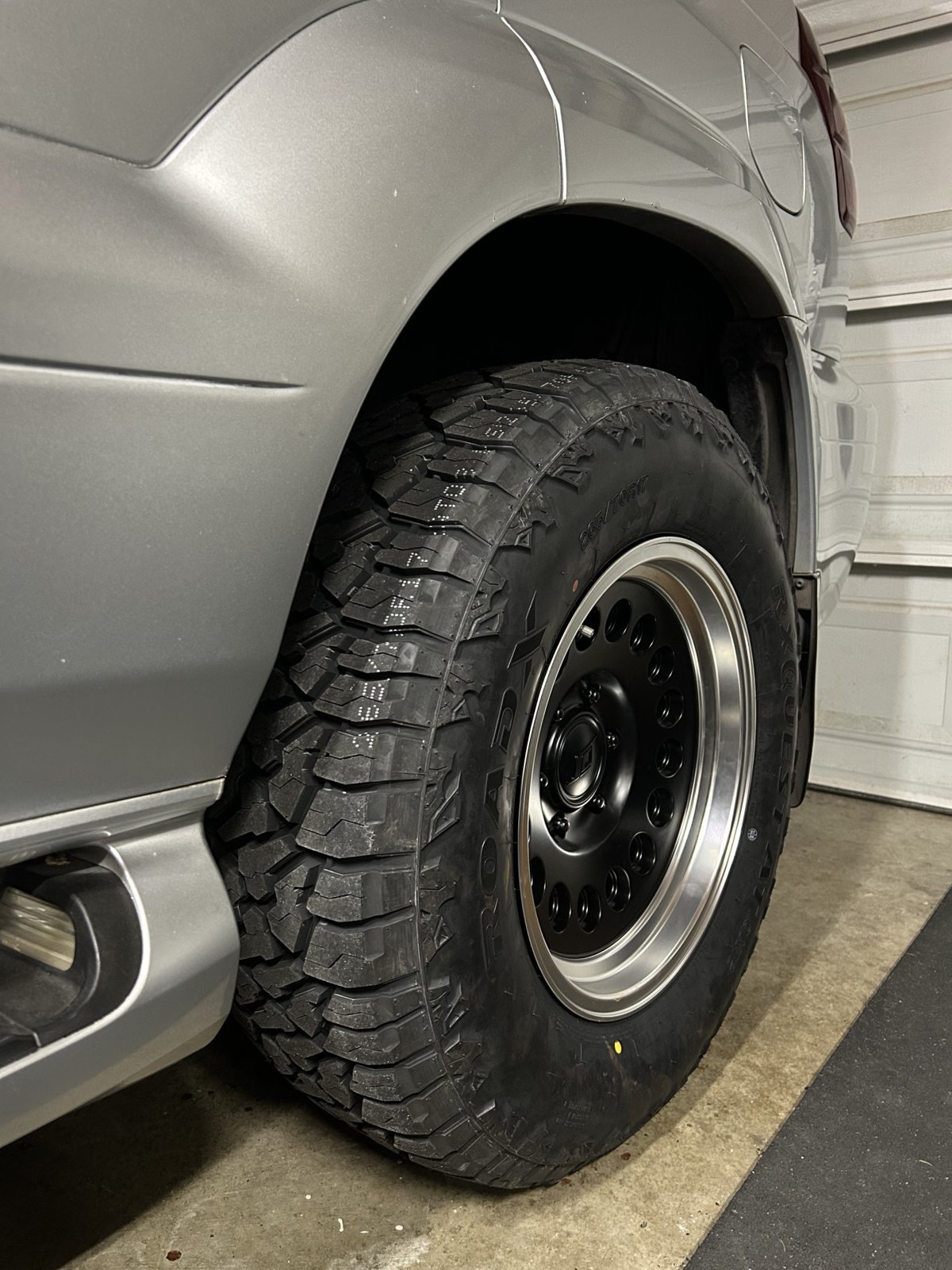

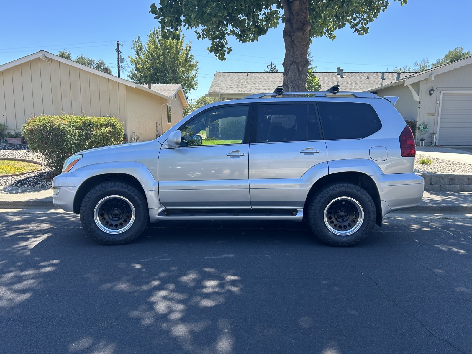

    I know this is a Tacoma forum but here ya go…
    2006 gx470
    265/70/17 roadx (don’t hate my budget build), went from 265/65/17.
    a little rub-heat gun for inner fender liner and a couple zippies to keep everything nice and tight. No more rub after.
    -10 offset looks great, really like the stance/ poke, would recommend -10 offset with recommended oem tire size for people that are looking to upgrade.
    Love the color matching on this silver/ black.
    Will post more pics after this weekend, if people want moar.
    Super happy with how it looks and feels.
    :cheers:

    Looks good! Definitely post more pictures when you get a chance.
