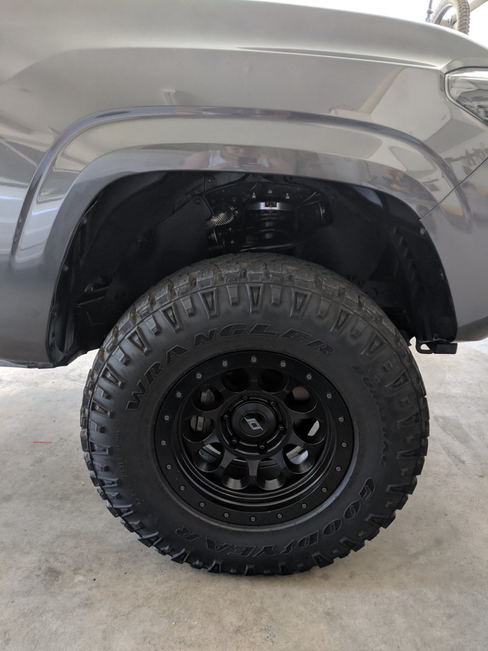

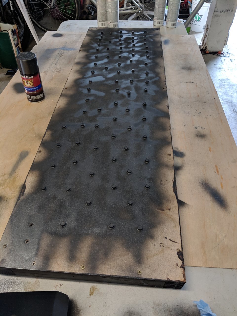

    I rattle canned mine like couple months ago with color match paint from orielly and it still looks great, haven't had it scrap off
    I did mgm to add a little contrast to the wheel

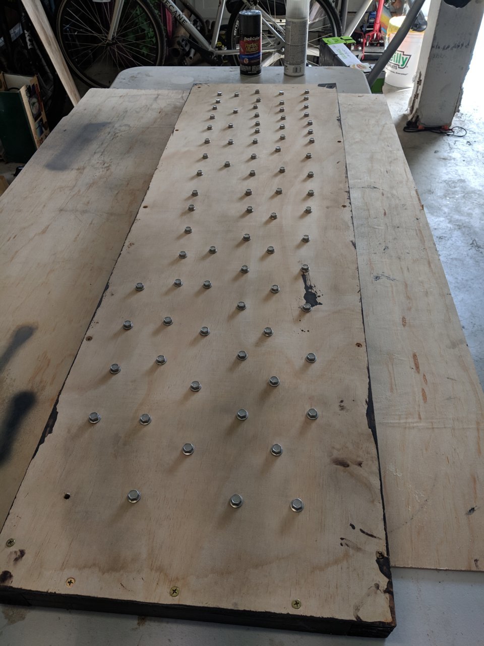

    After having run the wheels for months before attempting to paint them it was a little tedious making sure I got all the brake dust and grim off completely
    I found it easiest to put the bolts in ply wood to scrub any missed spots then spray painted them on the same spots, I also got a pack of nuts that fit the bolts to secure them while I scrubbed... Like I said tedious but cheap and worth it

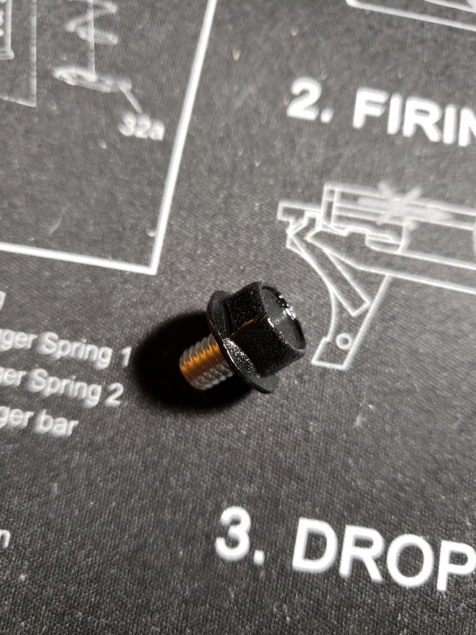

    Just an FYI, the black VTX bolts DO FIT on SCS wheels. I have both all black VTX Rogues and Matte Bronze SCS Ray10s and the bolts are interchangeable
    https://vtxwheels.com/products/vtx-bead-ring-bolts

    I ordered them off the VTX wheels website. It was $40.00 for 80 bolts. There’s a link on post #26.

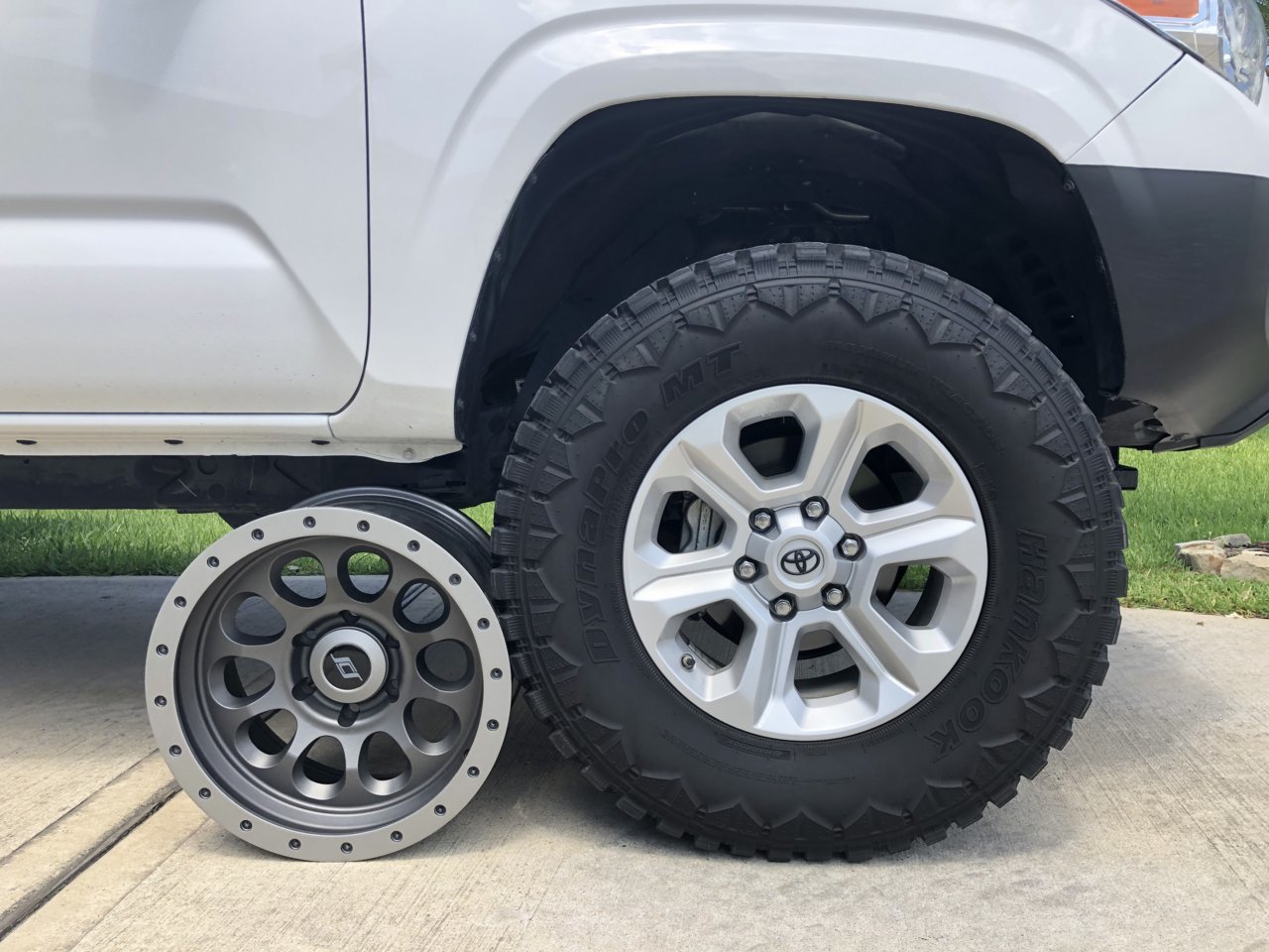

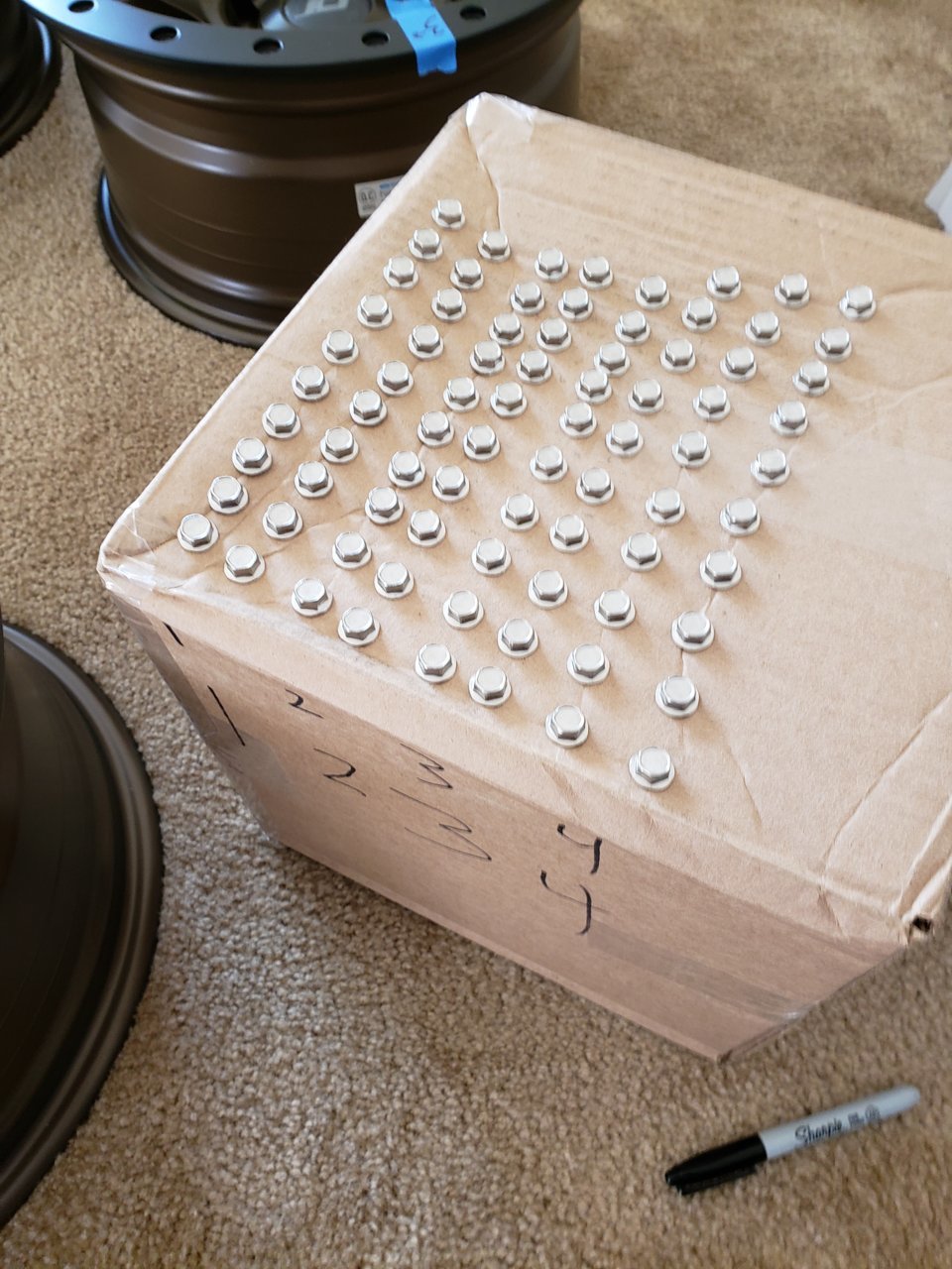

    I also rattled can mine...cardboard works too. Looks like the paint held up against the 10mm socket and wheel mounting. Also if anyone is interested in what the stock TRD OR rubber looks like on ray10 16x8.
