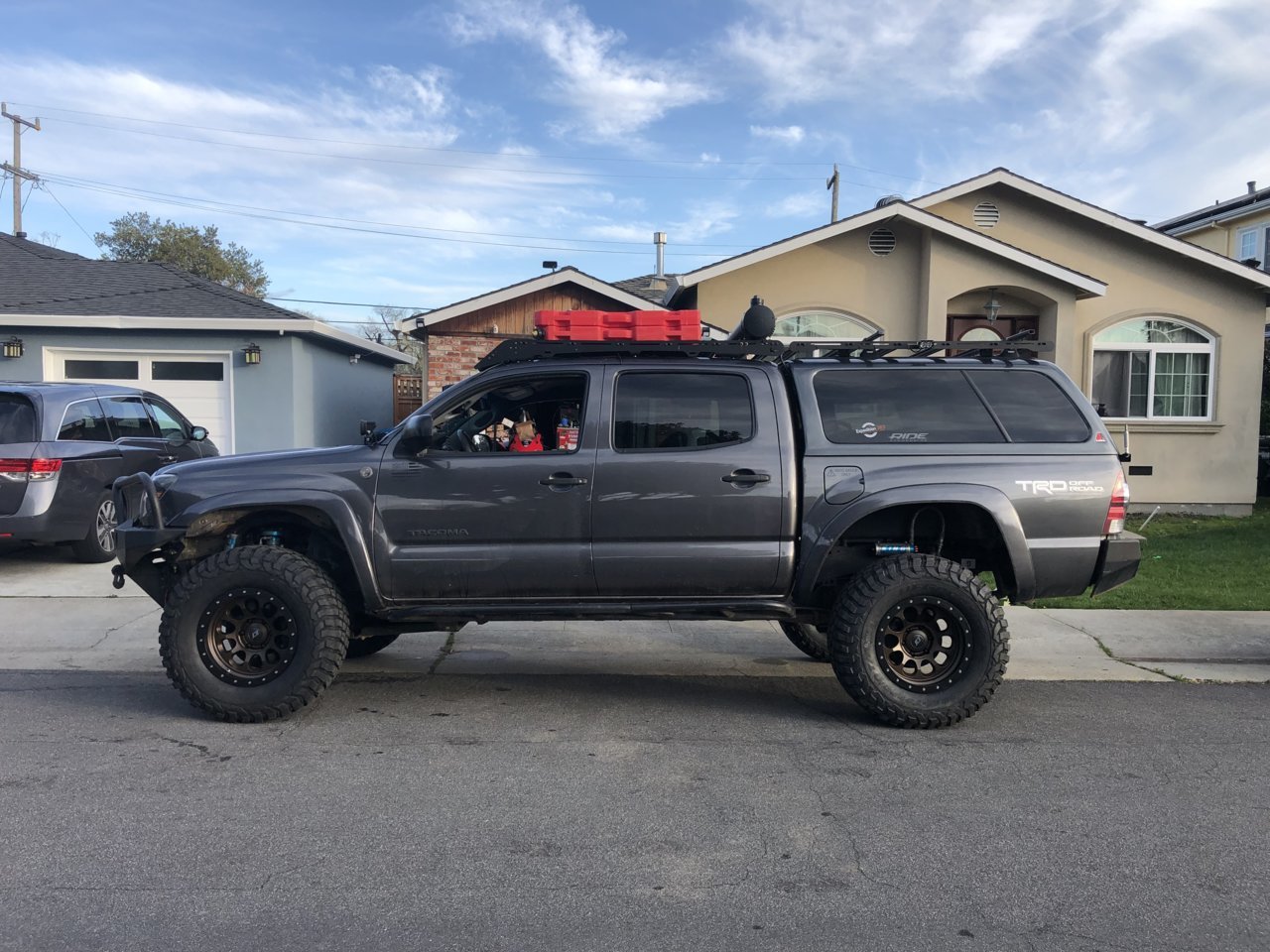

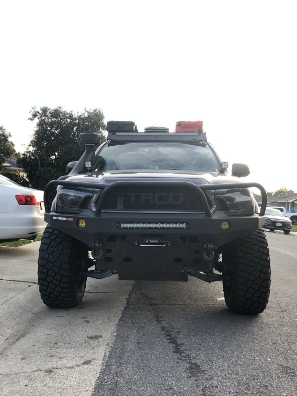

    Def at least a 275. I have a buddy running them. I had the OG Ray10's with 285/70/17 with and without 1" spacers and it was nice just need the right amount of castor and/or enough CMC done. As noted above by @KrnTaco08 but with 3rd gen you also have some more room. Once you start going 295 up you will def need a pretty aggressive CMC. I just installed 315/70/17 and I will need to redo the CMC and I also cut the fenders for good measure. The new setup is way wider than than 285's with spacers on the OG setup. Keep that in mind the bigger wider tire will be much wider in actuality. If you go 275/285 it won't be too bad. Ill try to post pictures of both as I just swapped them.

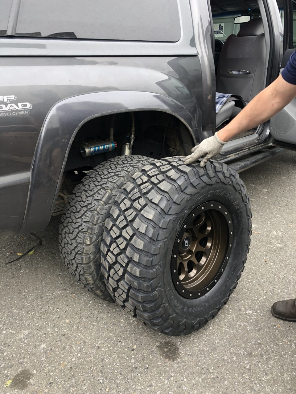

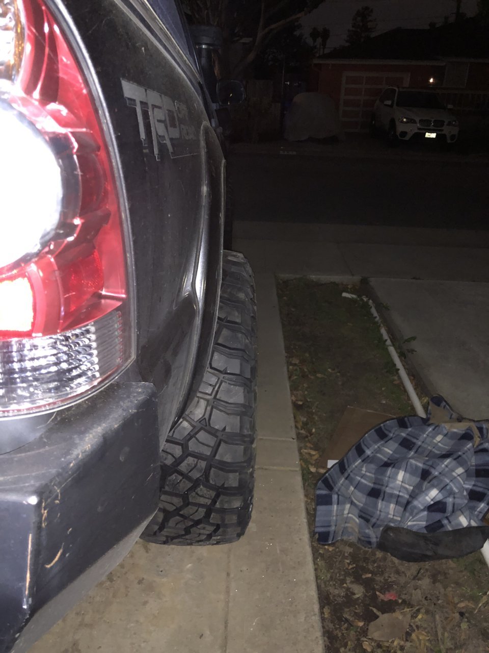

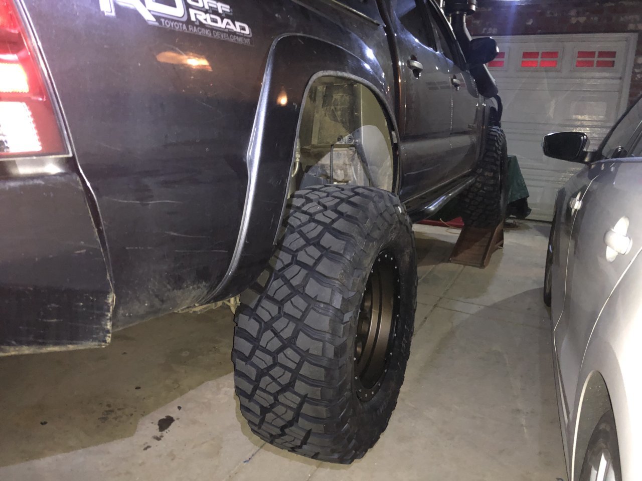

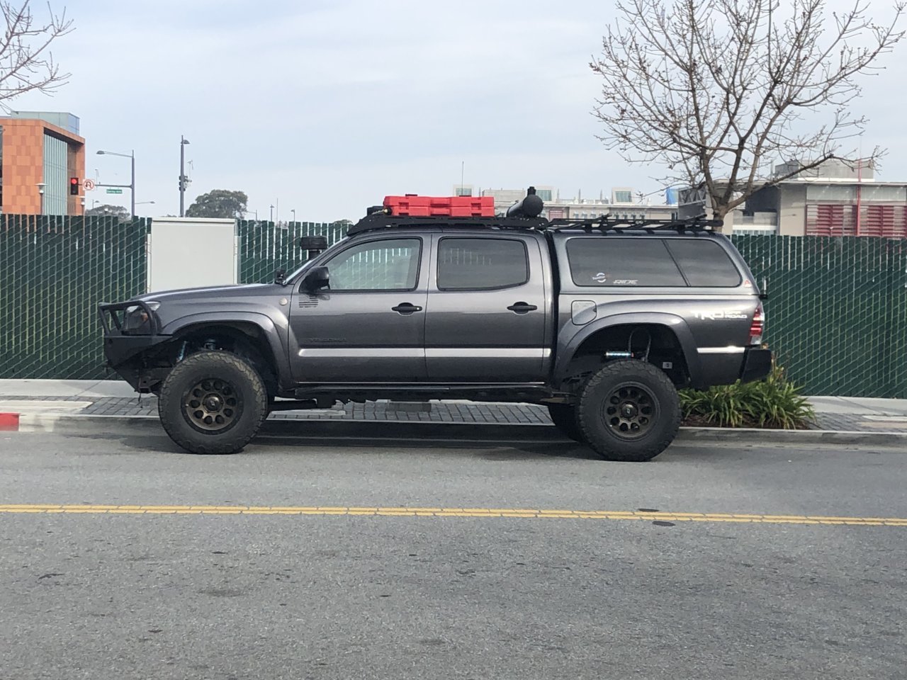

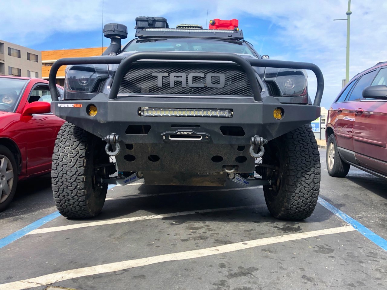

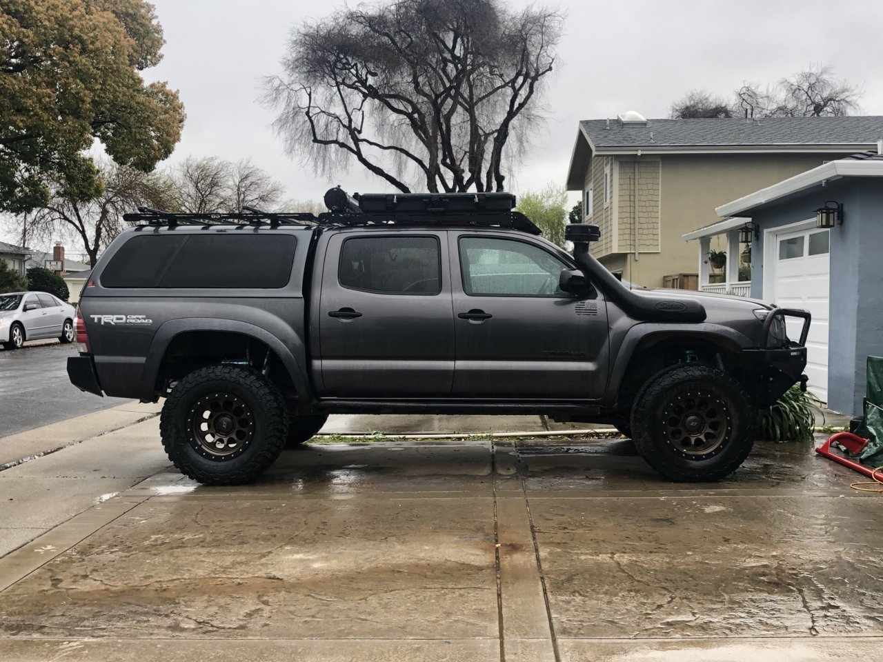

    I would go with the regular version then. Since it’s a 8.5 wheel vs 9. The -10 offset say in the 17 is a good stance. It’s not super wide but it’s nice. I never had a 255 here are some various States/versions of reg Ray vs wider Ray I have had . The new version is pretty wide.
    17x8.5 Ray10 no spacers w/K02a
    17x8.5 Ray10 w/ TC LCA so I had to Run 1” Bora spacer
    Current with the new Ray10 17x9” but with 315/70/17 KM3’s
    Before I mounted the front. OG Ray with front (285) vs rear new Ray10 w/ 315.
    8DBBBC24-8BB1-47A2-BD7E-18DFABD04C33.jpg 5B624117-E5BC-457B-8AA1-054DA6B42C49.jpg
