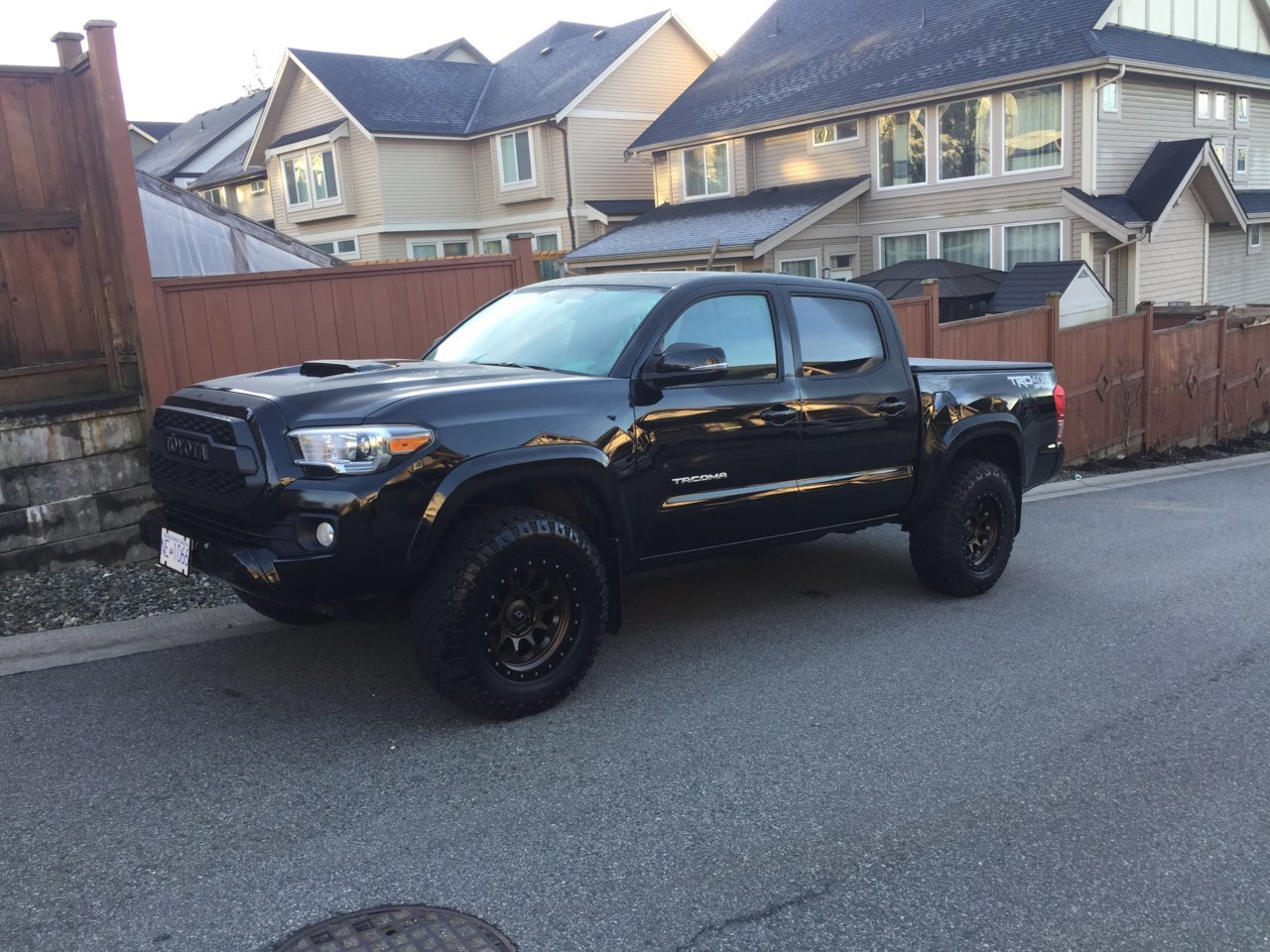

    Mine rubs on mudguards. No lift, 265/70/17 duratracs
    Van_island, nosamk, Roddy13 and 4 others like this.

    That's one beautiful truck. I've removed my mudguards so I think I should be good. Thanks a lot
    Spackletooms[QUOTED] likes this.

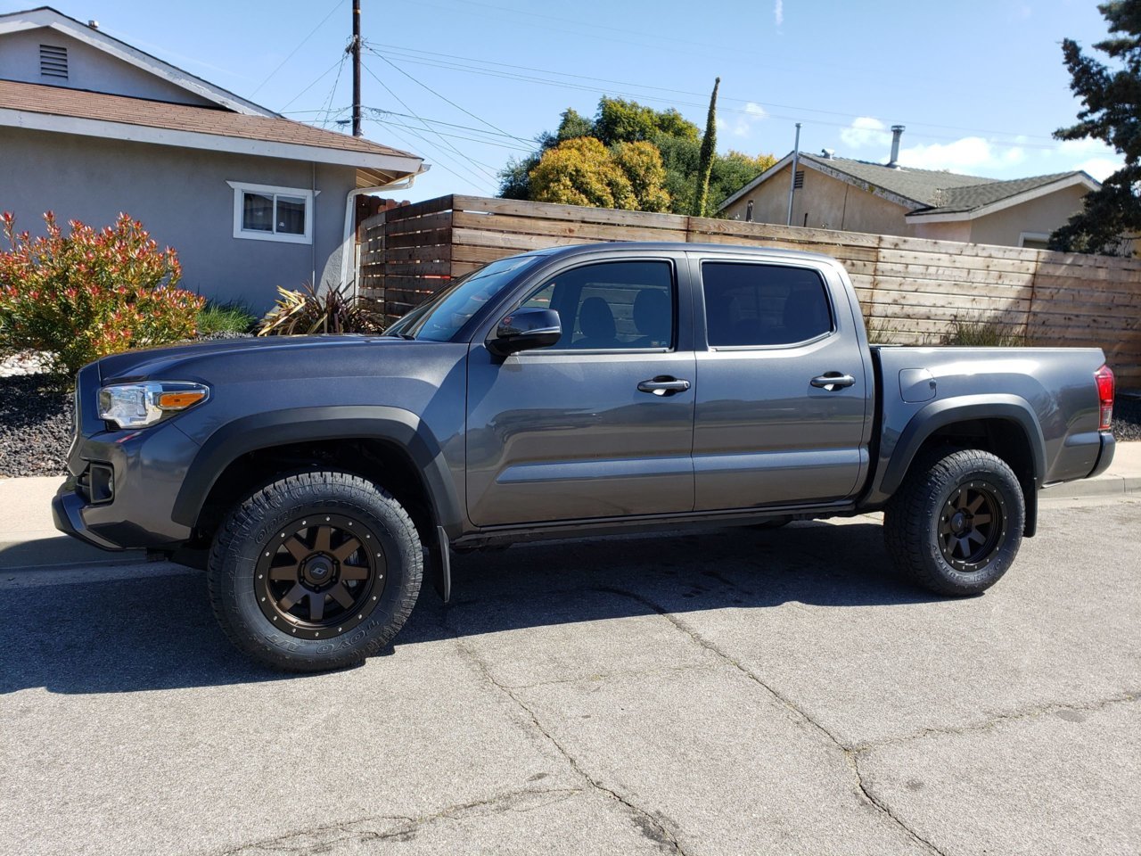

    SCS wheels with -10 offset 265/65/17 Toyos
    No rubbing

    Thanks for the info. I have been trying to decide between 255/75r17 or 265/70r17 for my Ray10’s. Your pic may have just convinced me to go with the 265’s.
