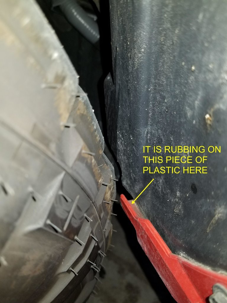

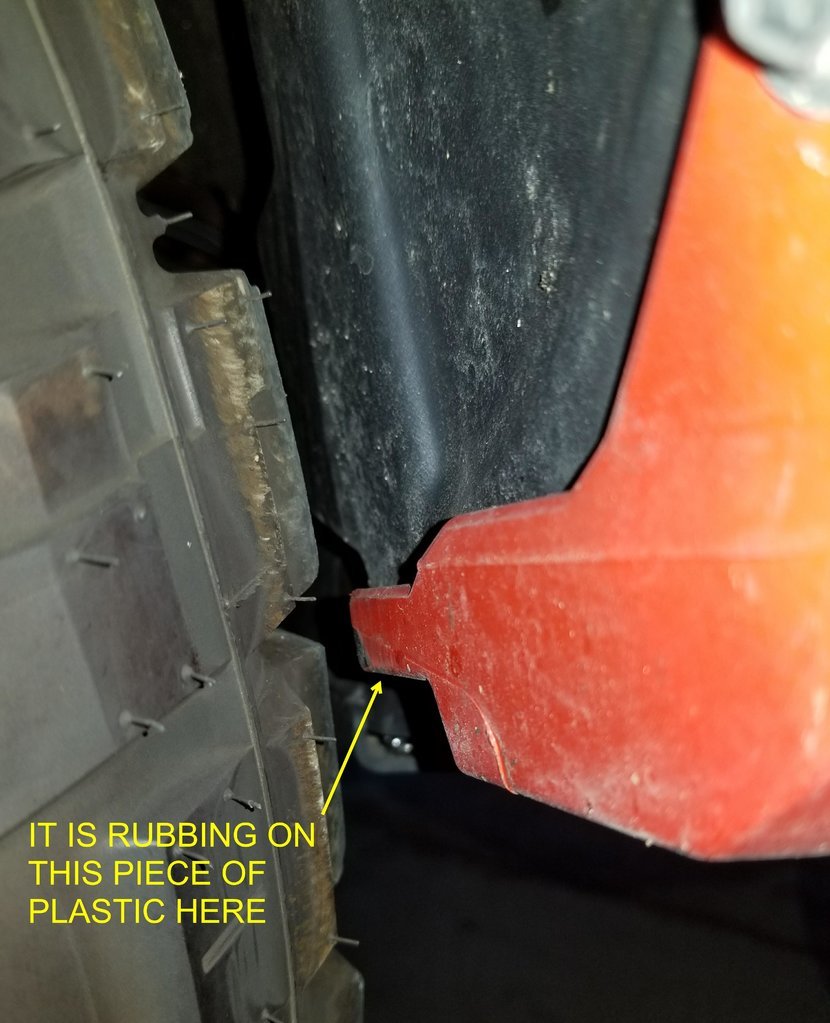

    Mine rub on the little orange piece of plastic shown in the pictures below, but I am told this can easily be cut off with an exacto knife. It barely rubs so I am not in any hurry. FYI, I removed the mud flaps so that is why you can see this. It was rubbing more on the mud flaps. Ultimately I intend to cut this piece off, and then heat up the mud flap where this bump out is and push it in (or just cut the bump out off) so there is no more bump. Sorry, I don't have a pic of the mud flap to explain it.

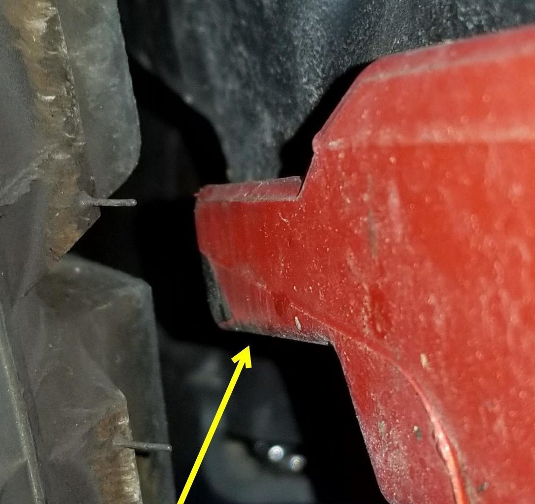

    Here, here's a close up of that piece of plastic. Look how little it rubs........
